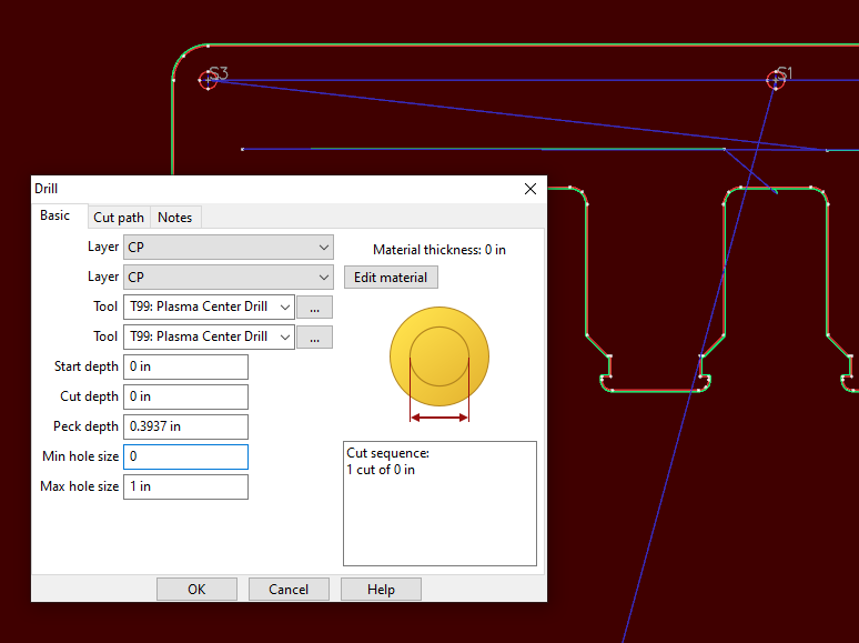

I just tested in Win7 and works as expected. I can just right-click->properties, type in a number and hit enter to apply the change and close the popup. I’m not sure why it is not working for you.

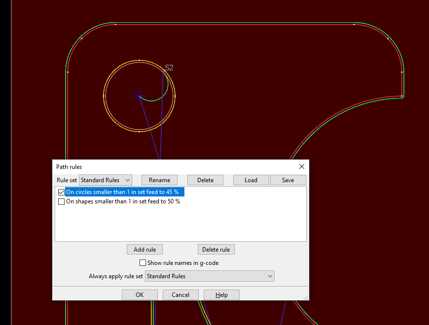

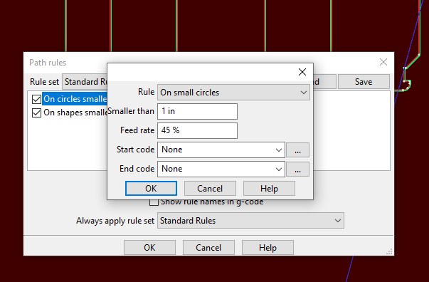

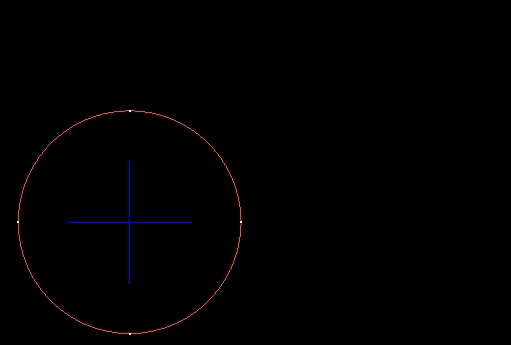

When I create a job from a dxf file all is fine. But when I save and open the job again, circles are not correct any longer. Only reimporting the drawing solves this.

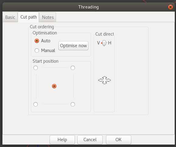

And a litte graphic thing: The area “Cut direction” could be a little bit stretched.
the same on drill operations.

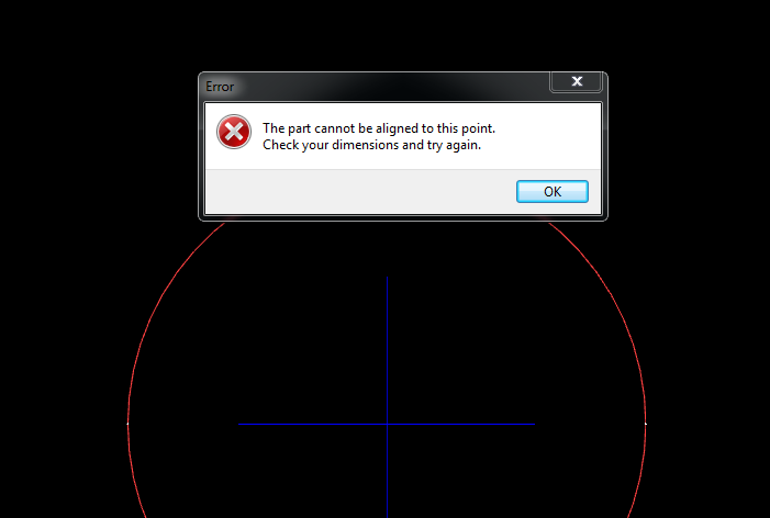

If selecting in reverse order on align dialog, following appears. And after this error dialog the drawing is aligned to the lower left corner. It would be better if the alignment would not be changed.
If selecting from top to bottom it works as expected.
There are quite a few sizing issues in the Linux version. Hopefully the next release will fix them.
I can’t replicate that here. Does it happen on the Windows version?
If selecting from top to bottom it works as expected.I can’t replicate that here. Does it happen on the Windows version?
Yes. Usually while aligning for a second time (a different contour):
Ah. It isn’t that obvious but align is a two step process. Select the first corner of a part and enter it’s coordinates. This will move that corner to the new coordinates. Now select another corner on the part and enter coordinates to rotate the part. This is only really useful if you are using points measured from an actual part on the machine. Align will fail if it is impossible to position the part so the two corners meet the entered coordinates.
If you want to use align just to move a part without rotating, right click and abort the alignment after entering the first coordinates.
But when a select ‘abort alignment’ the alignment of the first selected alignment is beeing resetted :-/

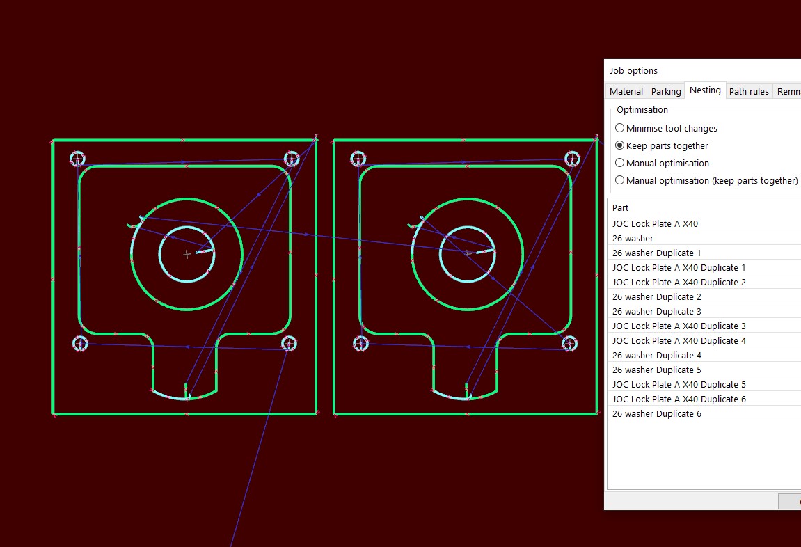

Maybe I’m not seeing it but what’s the best way of cutting a part from a drop on the inside of another part?
There doesn’t seem to be a easy way of picking the cutting order, nesting in job option does’t cover this, using set part order from nesting/right click sort of works but very confusing with many duplicates.
I know I can cut all the inner parts first and then run a separate file for the rest, but just feel there could be a better way?
If you switch to ‘manual optimisation (keep parts together)’ you can drag parts up and down the list. You can even multi-select parts and drag whole groups up and down the list.
Ah hadn’t played with that to be honest, I’ll give it a try, thanks

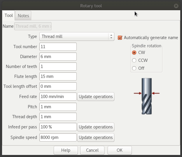

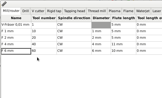

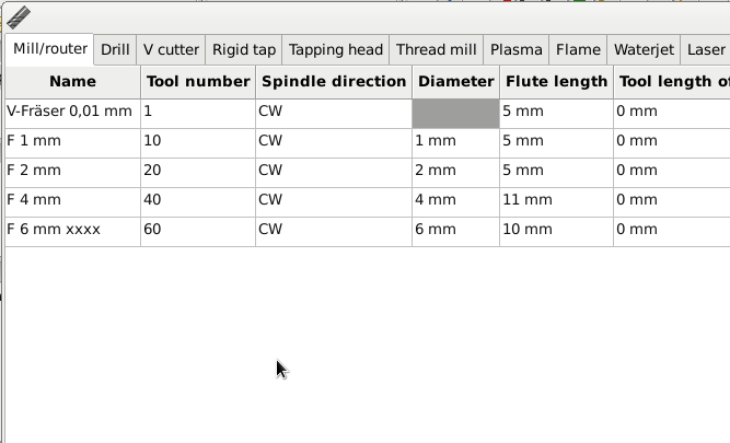

Something in the tooltable when editing the tools in the Linux version.

- The name is refreshed only on second selecting:
That is fixed in the current Windows version. It should carry across to the next Linux release.
- On right click the entry is not selected:
I’ll fix that for the next release.
Thanks for the bug reports.
