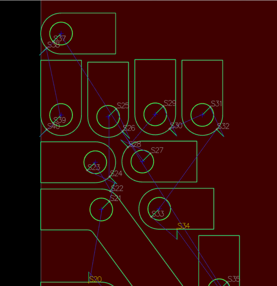

Bugs:
  1. Default start point placement should be such that machine does not have to travel over a contour that has already been cut to move to the next contour. Currently it is on the wrong side. I have brought this up before here: https://sheetcam.discoursehosting.net/t/start-point-placement/6635/1
  2. Leadins/ start points are being placed such that the start point interferes with other parts. The “start point placement clearance” does not appear to have any affect on placement of start points.
  3. Individual start point properties negative overcut value does nothing. Operation overcut must be negative for negative overcuts to work. I think i have brought this up before too, but do not see the post at the moment.
  4. “Break up manually nested parts” generates redundant names. (ex. Part of Part of [part name])

  1. Default start point placement should be such that machine does not have to travel over a contour that has already been cut to move to the next contour. Currently it is on the wrong side. I have brought this up before here: > https://sheetcam.discoursehosting.net/t/start-point-placement/6635/1
Yeah, that’s most definitely not in the quick fix department. I don’t think this will be ready for the new stable in January.
  1. Leadins/ start points are being placed such that the start point interferes with other parts. The “start point placement clearance” does not appear to have any affect on placement of start points.
Do you mean leadins on one part interfere with another part? Again that has a lot of nasty issues. What happens when you have duplicates? Duplicates are a carbon copy of the original part so if you move the start point on one you move it on all.
  1. Individual start point properties negative overcut value does nothing. Operation overcut must be negative for negative overcuts to work. I think i have brought this up before too, but do not see the post at the moment.
Yup, there is definitely something wrong there. The preview when in start point mode shows the correct spacing but the tool paths are wrong.
  1. “Break up manually nested parts” generates redundant names. (ex. Part of Part of [part name])
Huh, I never noticed that. I’ll fix it.

And i reinforce the issue i have brought up earlier about the start point placement not working well and ignoring the “start point clearance” setting. The picture below is of a manual nest imported into sheetcam as a single part, using one operation. This is the default start point placement. Two practically intersect and several others are very close to other parts even though my “start point clearance” is set to 200%. Actually i just realized where the issue might be here… the start point clearance actually reads “start point tool clearance”… I’m guessing now that this is not dependent on the leadin length as i assumed it would be, but rather the diameter/radius of the kerf/tool.
Yes, the clearance is relative to the tool diameter/kerf width. If I remember correctly it also does not check clearance between leadins. The problem with doing that is that you can end up stuck in a loop. If you move one lead in to clear another, that could affect other leadins. You end up with cascading moves affecting each other making it very difficult for SheetCam to come up with an answer.
