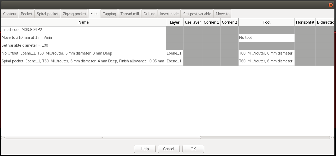

operation table: it shows all operations in every tab.
I think if the table “Pocket” is selected only the pocket operations should be shown and so on. But all operations are shown in all tabs.

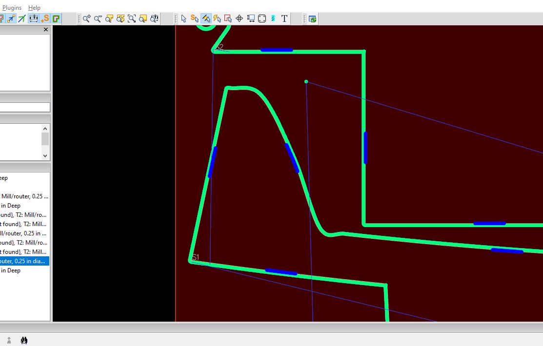

I wish the rapid path line (blue) was just a bit more pronounced and easier to see on the black background.
As djreiswig mentioned you can change the colours. Go to Options->application options-?Display. Select ‘Rapid path’ then click on the ‘Change’ button.

"As djreiswig mentioned you can change the colours. Go to Options->application options-?Display. Select ‘Rapid path’ then click on the ‘Change’ button. "
I don’t want to change the color! I just want the blue line to be a pixel or 2 wider making it a bit more prominent across the black background. And NO, I don’t want to change the background color, either.

So the tabs are some kind of filtering for the displayed columns?
Hmm If I would like to have an overview I would miss a tab which is showing all columns.
And is there a case where ‘Pocket’ shows something different than ‘Spiral Pocket’ ?
That’s not actually very easy. I can draw lines either 1 pixel wide or scaled. The problem with scaling is that the width then depends on the zoom amount.
Yes, that’s right. It shows all of the parameters for the selected operation type. For other operation types, only matching parameters are displayed.
No. Pocket should not even be displayed. ‘Pocket’ is just the parent class for the different types of pocket operation.
