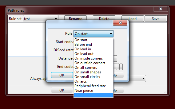

Path rules:
a) program crashes when selecting empty field:
b) old elements from previous selection of the upper drop down menu are not removed
In version 6.030 and the linux version that did not appear.

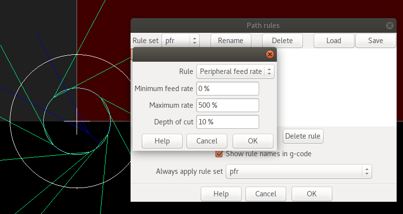

Another thing I noticed while dealing with that is regarding the rule “Peripheral feed rate”.
When the feed rate has to be reduced on an inside arc, the minimal feed rate is not calculated. It is always set to the entered “Minimal feed rate” value.
So when entering no lower limit the resulting feed rate is zero.
By the way: What does the setting “Depth of cut” does in this context? I found no documentation about the path or cutting rules.
The inside arc feed rate calcs are wrong. I have fixed it for the next release.
It’s a long time since I added this rule but depth of cut appears to be a misguided attempt to adjust the feed rate depending on how much material is being removed. I think I’ll remove it.

Peripheral feed rate works now fine I think.

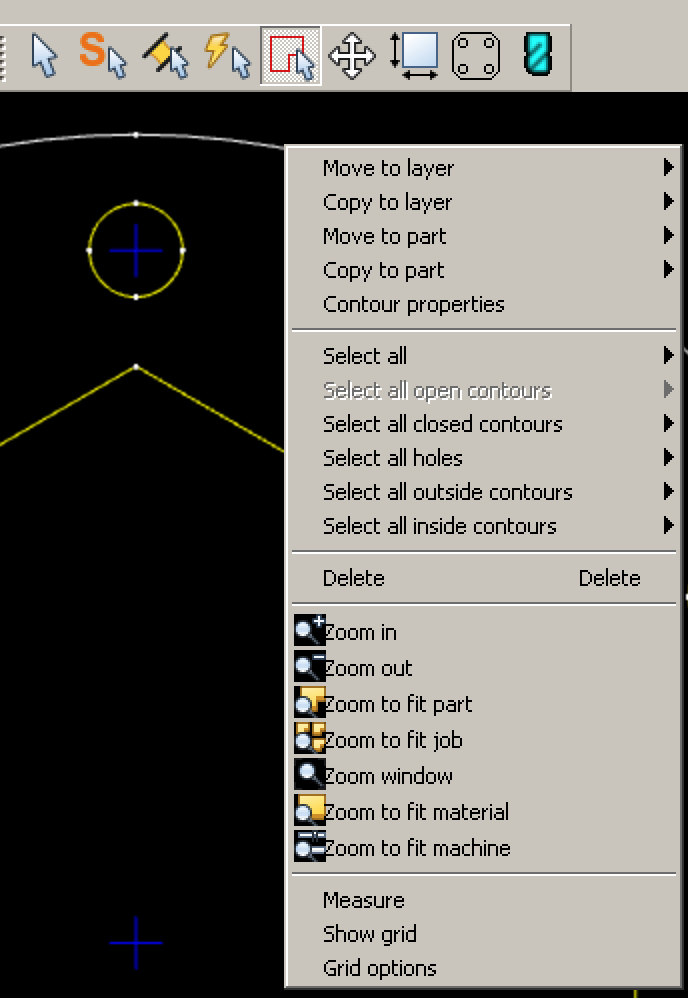

it would be nice if you could select an outline or two and create a layer which you could place those outlines on. It’s rather painful having to switch back and forth from sheetcam to a dxf editor like coreldraw, Adobe AI, Aspire or lightburn. Only one of these even has a linux version. which means you are switching back and forth between computers and this is where mistakes can happen.
In edit contours mode you can right click on outlines and move to layer.

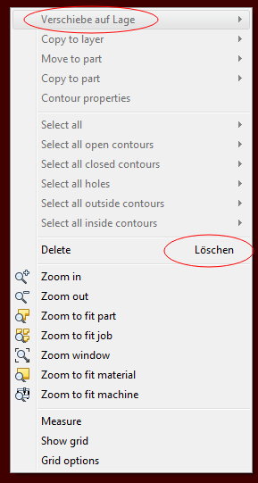

Translation files of context menu
I noticed that there is no de.mo any longer. Have you merged these files together?
But I think that was the place where the translations for the right click context menu was stored. In the last linux version that was correct.
Anyway, this context menu is no longer translated except one resp. two entries.
Is it now my turn to complete the new message.mo file? If yes - could you then please update the file and remove all items that are not used any longer? (if this can be done automatically)

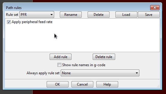

Path Rules
When canceling “Add new rule set” it seems afterwards that the existing rule is deleted:
But the peripheral feed rate works very well now :slight_smile:. Sadly things like “this works great now” or “I like that feature” are not mentioned in a bug reporting thread like this …
Fixed for the next release
I’ll add them in the next release.
Oh, that’s a bad one. I’ll fix it straight away.
You should find a file called messages.pot in the Languages folder. This contains the latest translation strings. In Poedit load your translation then select Catalogue->Update from pot file. Open that file to merge the files. It will automatically remove any unused strings.
Path Rules
It does not delete any existing rules. It just blanks out the options as you have no rule currently selected. You can select your existing rule set from the ‘Rule set’ dropdown. In the next release I’ll make it revert to the first rule set.

Yes I know that it is not deleted, therefore ‘seems’. In the gif it is not good to see because of the wrapping…
I added the de.mo manually, but that didn’t fix the centext menu.
I’ll have a try with the messages.pot and report you.
