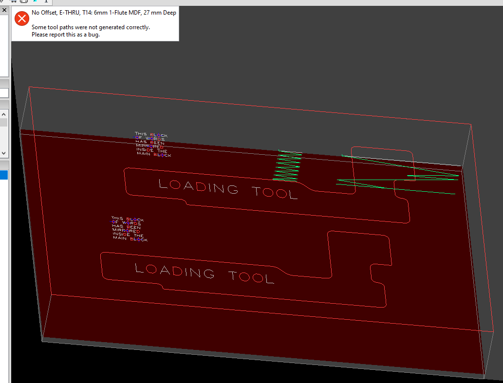

Hate to be the bearer of bad news, but SheetCAM is asking me to report a bug. Appears to be related to “Occasional incorrect tool paths when ramping an open contour”. And the reflected-blocks thing seems to be still there.
I’ve upgraded to 6.9.15 and rebooted Windows for good measure.
“Occasional incorrect tool paths when ramping an open contour”: it seems subtly different now. The return ramps are being cut away, but any intermediate-depth flatcut isn’t being completed. For example, I’ve made a cut 27mm deep, with 9mm passes. So there should be flat-bottom cuts at 9mm and 18mm. The 9mm one seems to be missing and the 18mm is only part-cut. That leaves ~20mm of material to be cleared during one of the ramp moves.
“DXF not reflecting blocks correctly when a negative Z scale is used”: sadly doesn’t appear much changed. In a previous version (6.1.45) I experimented with setting the Z-scaling to +1 for mirrored (actually in TurboCAD rotated-180-about-Y-axis) blocks. But it made no difference to SheetCAM. So I wonder if the -1 Z scaling isn’t the direct cause of the problem?
6.1.45 is the latest version I’m aware of without the “Occasional incorrect tool paths when ramping an open contour” issue which is quite important in my drawings, so I’ll use that for now.

MirrorTest.DXF (774 KB)
Hmm, looks like it’s Z extrusion, not Z scale. OK I’ll fix it in the next release.

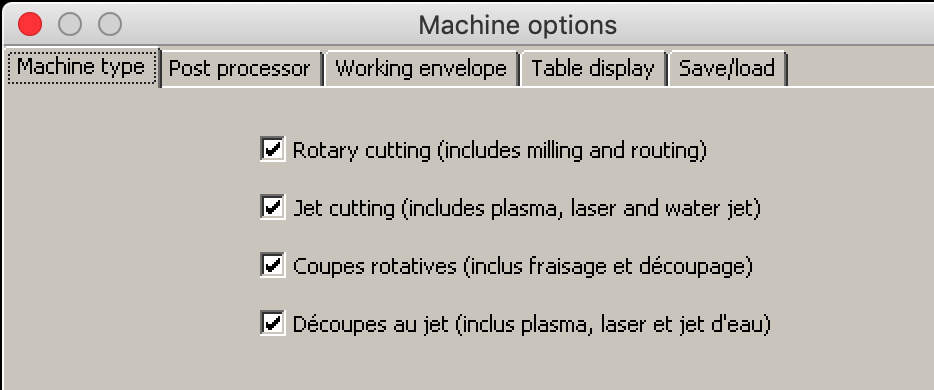

I have both english and french options in machine type options.
I have bug in few recent patches. When I try to print background became black and I will print black area which I don’t want.I’m using 6.1.74 because this version works fine yet.
That can happen if you run SheetCam in English then switch to French or vice-versa. I’ll see what I can do about it.
Thanks for letting me know. I’ll fix it for the next release.

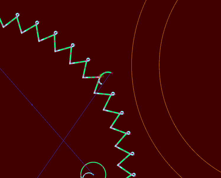

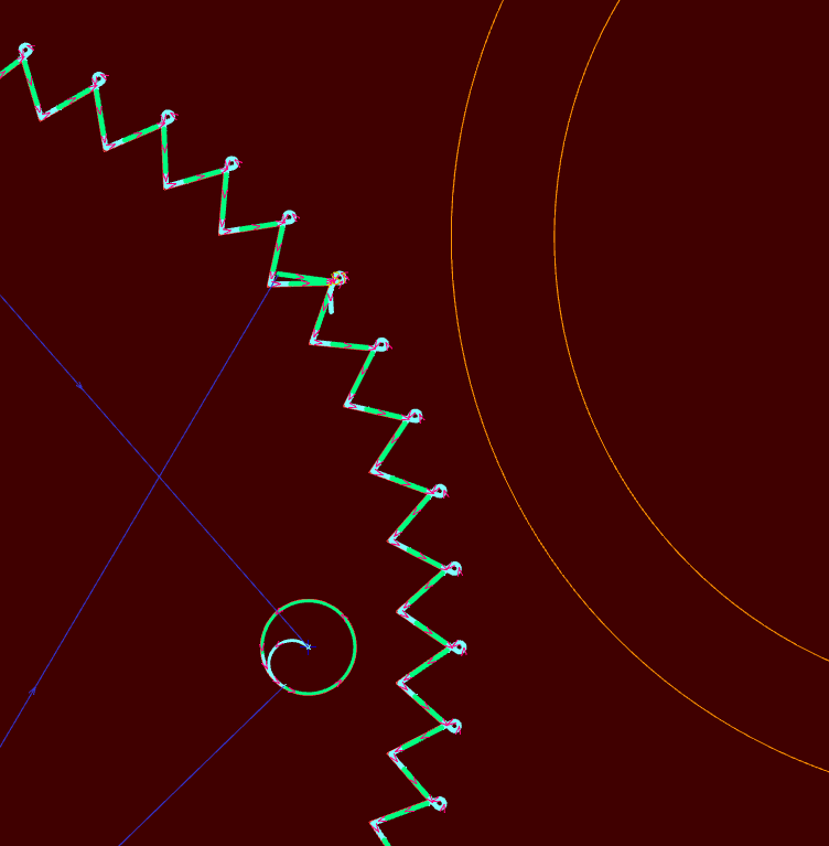

Hey Les,
Is there any way you can do something about the negative overcut bug sometime soon? It is one of my top 3 pet peeves of bugs. We found it what seems like over a year ago and its an issue for us almost every day.
Sample.job (37.3 KB)

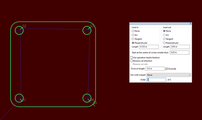

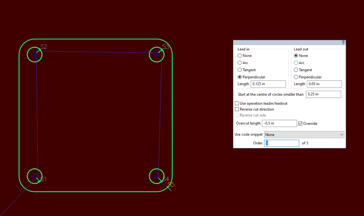

Don’t know if this is a “bugs” item or not but here goes!
Is there a way using looped outside corners with tangent lead-in selected to ignore the loop at the start point? It seems to work with arc lead-in like I think it should but not tangent… or am I missing something?!
Thoughts?
Thanks, Steve
Try it without a overcut, that’s probably what’s causing that.
That worked! I completly overlooked that one, Thanks.
