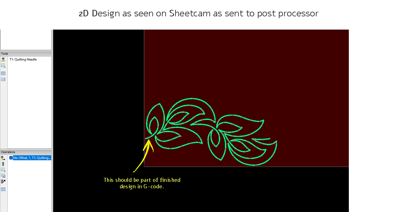

I’m having a very strange problem. Here is view of what I get when I do a 2d design in Sheetcam (I use 2D because I’m making these designs to run a CNC on a quilting machine):
ScheetcamTroubleShootingImage_1
ScheetcamTroubleShootingImage_11313×688 40.6 KB
This design as shown on the image above is exactly what I’m hoping to get when I run the job.
But, The next post will show the design that I get when I run the G-code through any G-code viewer:
I am still in the trial mode in Sheetcam and desperately want to get this problem solved so I can purchase it.
I hope you can help me solve this issue. Thank you in advance!

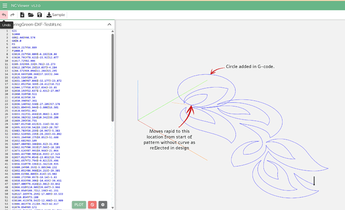

This has been split into two posts since the bot will not let me post two images in one post as a new user. Here is part 2.
This image shows the design that I get when I run the G-code through any G-code viewer:
There are two issues: 1st, the machine goes to where the design starts and then rapids over to the second point in a straight line instead of giving us the curved line that is shown in the original design. And 2d, it installs a perfect circle that is NOT in the original design.
In this view you can see the G-code that was produced in the post processor that also produced the circle. This is the fourth or fifth different pattern that I have tried with the same results. I have tried bringing in the original design image in both SVG and DXF. I have actually run a couple of them on the machine and, as you would expect, it runs just as it shows here.

This certainly looks like malformed gcode after M3. Once M3 is posted to output, always by OnPenDown(), then there should not be G0 blocks until OnPenUp() where M5 is posted out.
As @djreiswig suggested, we need to see the post processor. but also please include your .job file.

The problem resulting in the added circle at the beginning of your toolpath has to do with the G0 stmt following M3. That addition of G0 logic in the pp seems to be a mistake only occurring after sheetcam v7.0.21, based on my compare of those pp files.
Since you also desire to pause after M3, I added "post.Text ('M0… " in OnPenDown() after M3. The M0 machine pause requires the operator to press the Play or Resume button on the console to resume machine motion, which you may prefer instead of a timed delay of 45 seconds. If not, you can easily change it in the pp or comment out the pp line entirely with ‘–’ as leading chars on the line, you’ll see other commented logic lines as such.
See the attached pp and gcode, you may use the pp as is or adjusted as noted here.

:smiley: Thank you!!! It works perfectly after I made the modification on line 92 of the PP to give it a G04 P30. It’s interesting that everywhere I read that P counts in milliseconds but I’ve been using Pxx, since that is what I was told the first time, and the number of seconds and that’s what it gives me . . . 30 seconds pause in the case of P30 etc. My wife’s sewing machine does not have a play or resume button, so I’m forced to use the G04 code.
