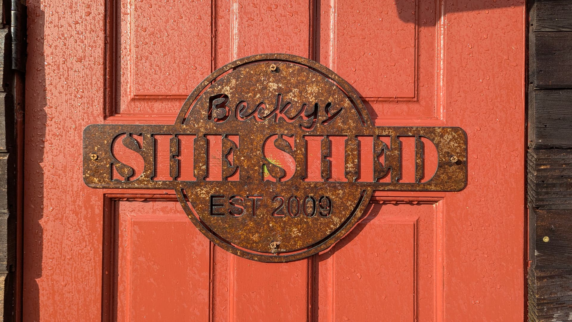

I’ve switched over from using SolidWorks to using Alibre and sheetcam, and it was a little bumpy of a ride, but you made it much easier. Your GRBL plasma-marker-flatsheet-rotary 5-18.scpost was the ticket for my machine, which is JD Garage plasma table with x, y and Z axis’, and a Lotos LTP5500D. I tried a few of your earlier examples and had a few issues, but when I found 5-18, it all came together and I cut a piece for my wife’s she shed, picture attached if the forum will allow a new user. The cut was perfect, right to my machine spec, and almost no dross, which is great for a rusty piece of steel!
Thanks again, if you are in the PNW near Whidbey, I’d buy you a cuppa or a cold beer. And I mean that!
Tim

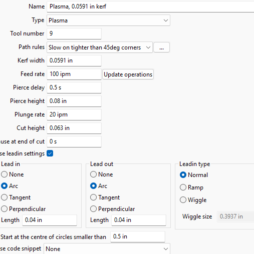

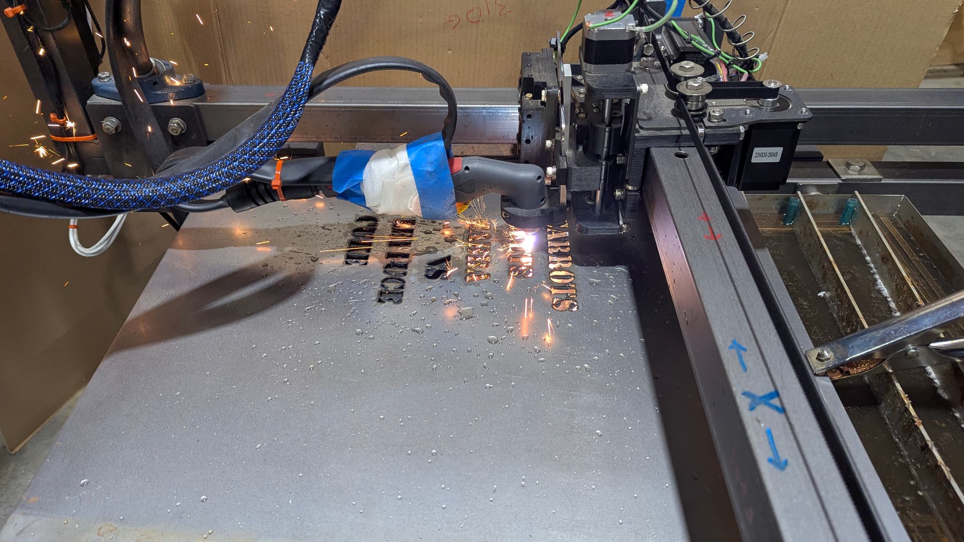

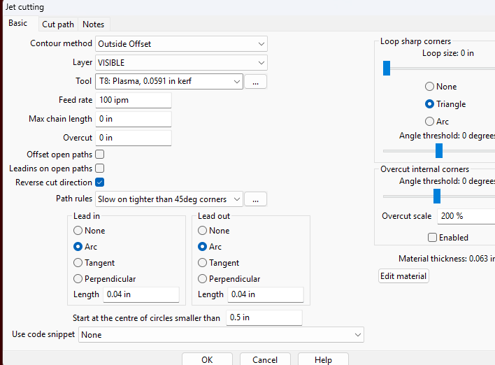

And here cutting some stainless .063 on some sheet stainless…

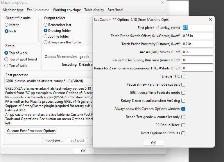

For anyone using this setup here are the Post processor settings and machine settings…
