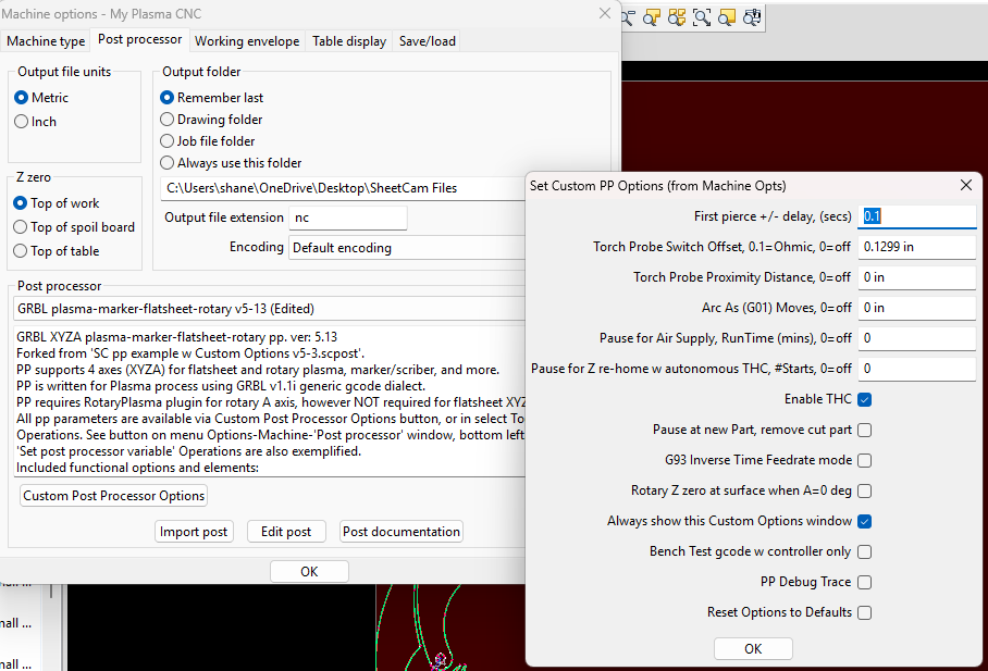

Hello Bloupchip I appreciate your releases excellent work as always.
I’ve tested the GRBL plasma-marker-flatsheet-rotary v5-13.scpost on my JDG v2.0 not the XL table and ran into the following minor issues:
1- I don’t have a thc and I didn’t enable it in the popup and this line causes a GRBL error 20 in openbuild v1.0.388 latest M67 E0 Q10 (DTHC OFF)
I simply deleted that line and the job runs without errors
2- the Pierce height and cut height seem to be too high, even if I set them in the tool to 3.8mm piece and 1.5mm cut there are double that on top of the metal part . The only way I can reduce the cut and pierce height is to artificially drop them down to 2.5mm pierce and 0.5mm so 1mm less. This has been a problem with other post processors from @Alsandoval and others
@scoobieguy , thank you for the complement, and glad the pp is working out for you, sort of :wink:
I searched the pp but don’t find “M67”… anything. Is it possible the gcode file was stale and from a different pp?, that looks like it might be from a CandCNC pp.
re. pierce and cut heights not right for any pp- that is most likely due to a sheetcam setting; see menu Options-Machine-‘Post Processor’, and the ‘Z zero’ radio buttons. For plasma process, the choice should be ‘Top of work’. The other choices have material thickness and/or ‘height of material above table’ added to the pierce and cut heights.
I think my torch height is getting closer to what I’m setting in the sheetcam GUI thanks for the screenshot. cuts are looking nicer now and I also slowed down the cutting speed.
also I figured out the problem with M67 E0 Q10 (DTHC OFF)
It turned out the be the same issue by another user in this post, I did the same as him import a toolset from another source and it had path rules sets that enable and disabled the THC, as the user said the best thing to do is to build your tool library from scratch.

Hello bLouChip. I have been trying to use SheetCam with my JD’s Garage XL and i keep getting the 20 - Unsupported or invalid g-code command found in block. [ M7 (ADC/THC enabled). I have THC and i have the Enable THC box checked. Any help would be appreciated.
THC setups for something as generic as a grbl controller are going to vary a bit, and some don’t need an enable/disable gcode, Proma SD THC and DANI 7SDP THC are two examples of that. The pp in this thread is written specific to my THC installation and anti-dive circuit, it uses M7 gcode/output to enable the anti-dive (ADC) and in doing so it also enables the THC. Normally an M7 is ‘mist coolant’ output signal from controllers; some grbl firmware are known not to support M7, you may have that case, it seems like your controller is complaining of M7.
You can simply uncheck the custom option ‘Enable THC’ to suppress M7 in the gcode as I recall. If your controll/THC setup must have a THC enable/disable cmd, the pp supports that fucntion and you just need to modify the gcode cmd in the pp that is posted for the condition, the timing/sequencing of posting the cmd may not need change.

Hi Lou, Is there any documentation for this PP?
I’m not having luck finding the answers I need.
I guess mostly it’s just 2 things, the “first pierce delay” - is that in addition to the delay in the tool or does that override the tool setting?
And what is “torch probe proximity distance”?
