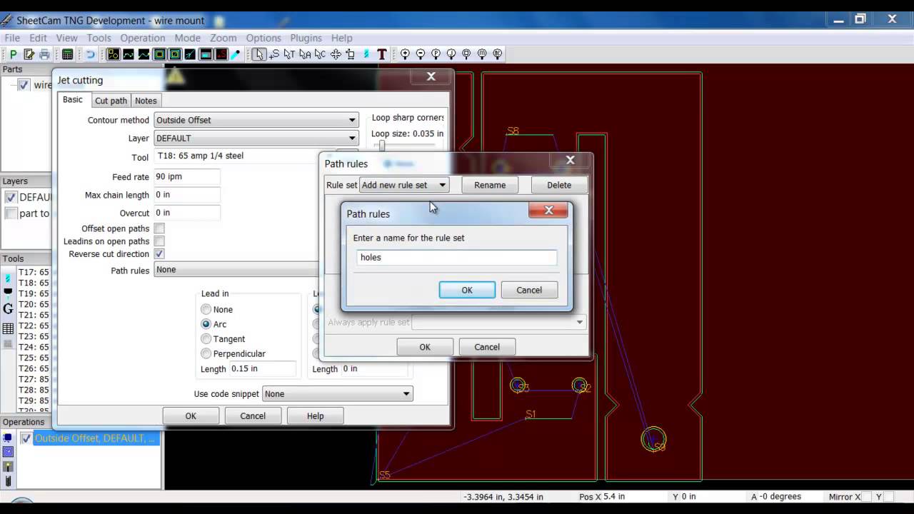

Looking to use the rule feature to turn THC on and off for finer details. There is a setting in the controller to turn it off for radiuses but not for small parts so I am assuming that is only.circles. I have rules set up for speeds but not sure where to start in putting in a rule on this as there does not seem to be an option in the post processor for STV Optimum. Is there a way to manually add it? It appears from the research that the Gcode may be different for different brands.
this video describes sheetcam path rules rather well.
