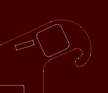

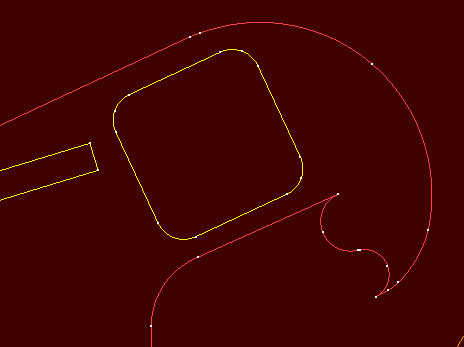

V8 is having issues importing dxf files that work fine on V7. see attached screenshots. Any ideas?
V7
V8

compare your Options / ‘Application options’ / ‘Drawing import’ settings.
If you don’t see differences that explain the behavior, then send customer support.zip files from each version to sales@sheetcam.com, attention @zack-sheetcam .
See Creating a Sheetcam Customer Support file
I had verified the import settings, and they all matched. Sent in files
