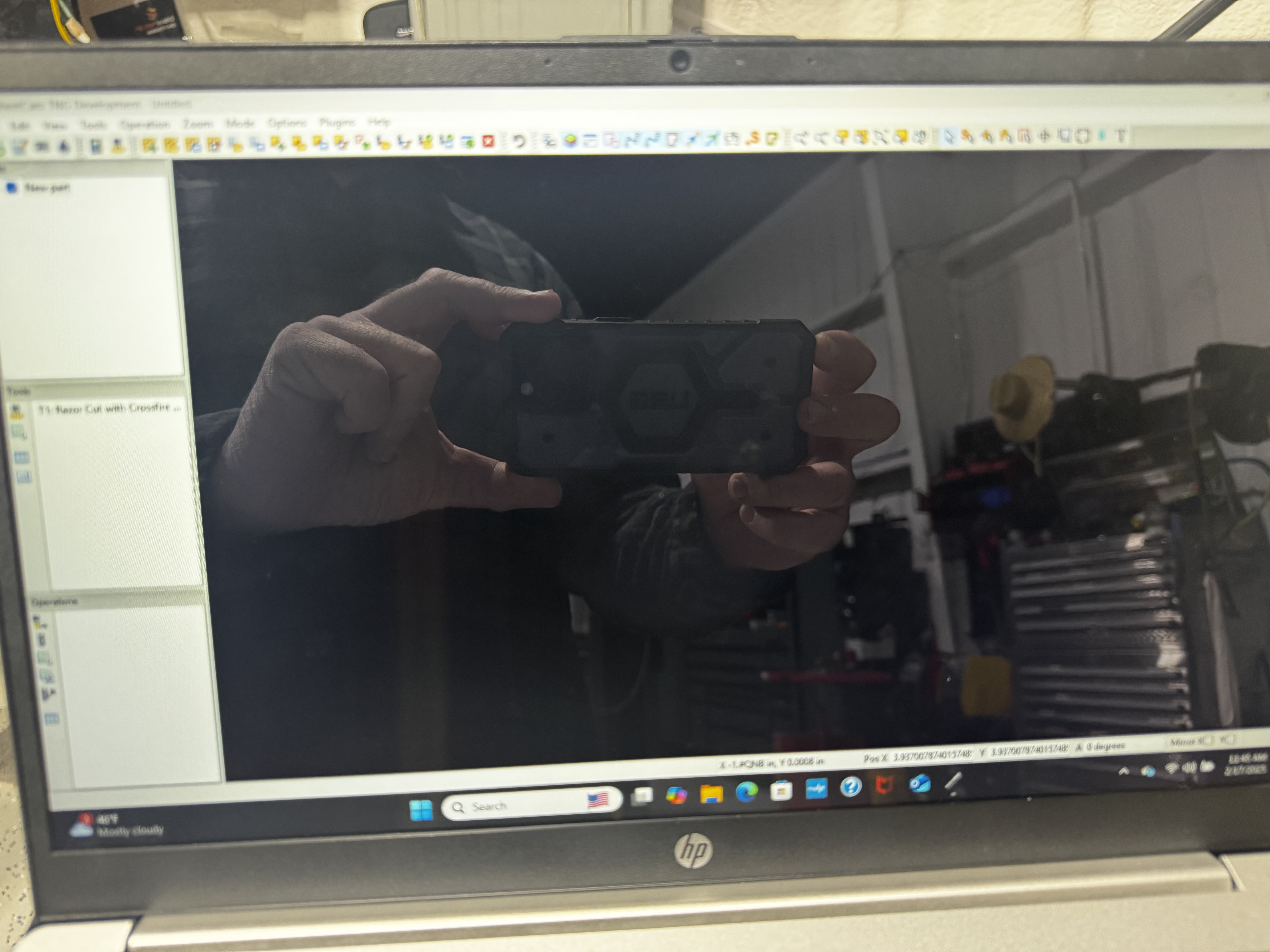

It worked right in the beginning but now when I open Sheetcam, it’s doesn’t open with the reddish workspace. I’m also new to this. It’s all black. I can import a drawing but it’s all on the black background and it shows no layers at all. What am I doing wrong? I’ve closed completely out and tried reopening it several times. It’s gives me the toolbars and everything else but the work area is still black.
It looks like your material size is missing, maroon color area.
menu Options-Job options.
