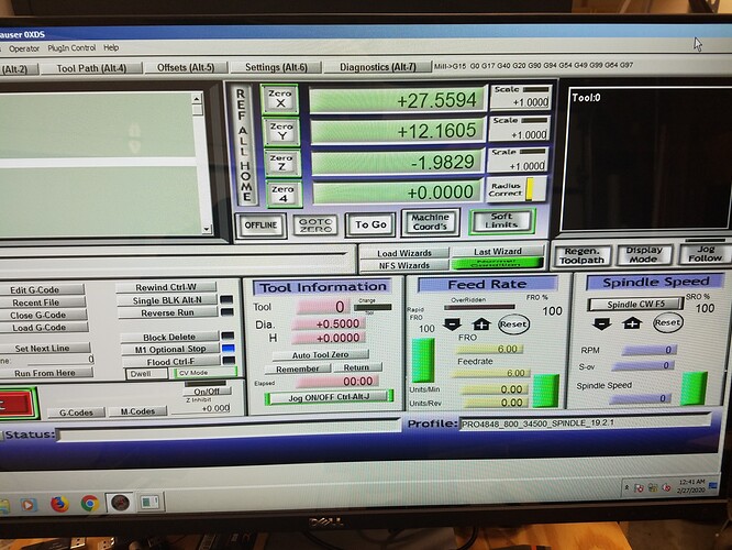

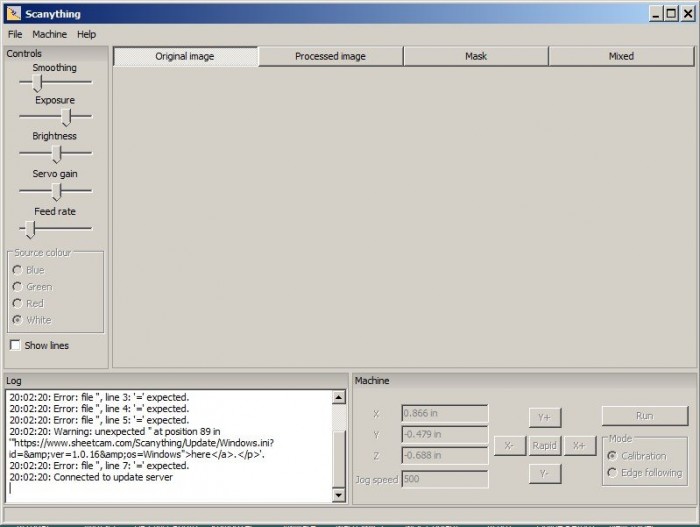

I can’t seem to find any information on the hardware requirements for Scanything. I have a 4x4 router table (CNC Router Parts pro4848). I am using Mach3 with the Warp9 ESS to run the table. The ESS/controller connects to the computer using an ethernet cable. The computer is Windows 7 - 64 bit. I have downloaded Scanything V1.0.16 from the Sheetcam website and followed the instructions for Mach3:
"Instructions for installation with Mach3
Download and install Scanything then run Mach3 and go to Config->Config plugins. Enable the SheetCamRemote plugin and restart Mach3. To test the connection, enable the drives on your machine and check if the jog buttons in Scanything work. "
Does a video camera need to be connected in order to test the connection by enabling the drives and checking to make sure the jog buttons work?
Since I can run Mach3 Mill on my desktop office computer (not the computer out in the shop that I use to run the cnc) and I have downloaded and installed Scanything onto this computer, should I be able to test the jog buttons without being connected to the cnc? I can use the keyboard to jog in Mach3 Mill, and the display shows the movement on the readouts without any hardware being connected.
When I open Scanything, the jog buttons are not active.
I receive the following error messages when starting Scanything. I do have he plugin (SheetCamRemote.dll) installed in the C:/Mach3/plugins folder.
Any ideas what I am doing wrong here?
22:23:26: Checking for updates…
22:23:26: Not connected to machine
22:23:26: Error: file ‘’, line 1: ‘=’ expected.
22:23:26: Error: file ‘’, line 2: ‘=’ expected.
22:23:26: Error: file ‘’, line 3: ‘=’ expected.
22:23:26: Error: file ‘’, line 4: ‘=’ expected.
22:23:26: Error: file ‘’, line 5: ‘=’ expected.
22:23:26: Warning: unexpected " at position 89 in ‘"https://www.sheetcam.com/Scanything/Update/Windows.ini?id=&ver=1.0.16&os=Windows">here.</p>’.
22:23:26: Error: file ‘’, line 7: ‘=’ expected.
22:23:26: Connected to update server

The jog buttons don’t need a camera but unfortunately Scanything won’t work with the ESS. I ave been looking into solutions but so far I haven’t found any way around the problem.
I played with it briefly on my table that is running Mach3 with a C&CNC Bladerunner which uses the ESS Smoothstepper and it seemed to work fine. Am I misunderstanding what you are doing?
I installed Scanything onto my shop computer which is connected to my CNC Router Parts Pro4848 router table running on Mach3 thru the Warp9 ESS. After entering the code you emailed me and turning on the SheetCam plugin, so far it seems to work. The Scanything jog buttons work correctly, move the carriage and gantry around as normal when jogging, and the Scanything position readout agrees with the Mach3 position readouts (both in inch units). I don’t yet have a USB video camera, but I would assume that the video output from the USB camera which will be input to your Scanything program does not depend on the ESS for communication. Am I correct? Or am I missing something here?
I was waiting to order a USB video camera until I made sure Scanything would work with my Mach3/ESS setup. I would appreciate your thoughts on my progress so far.

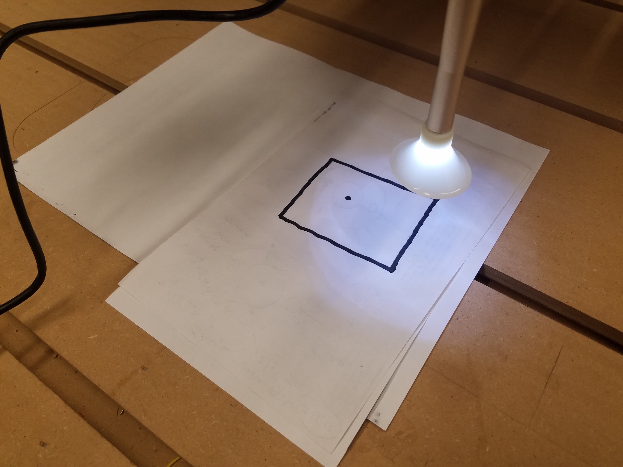

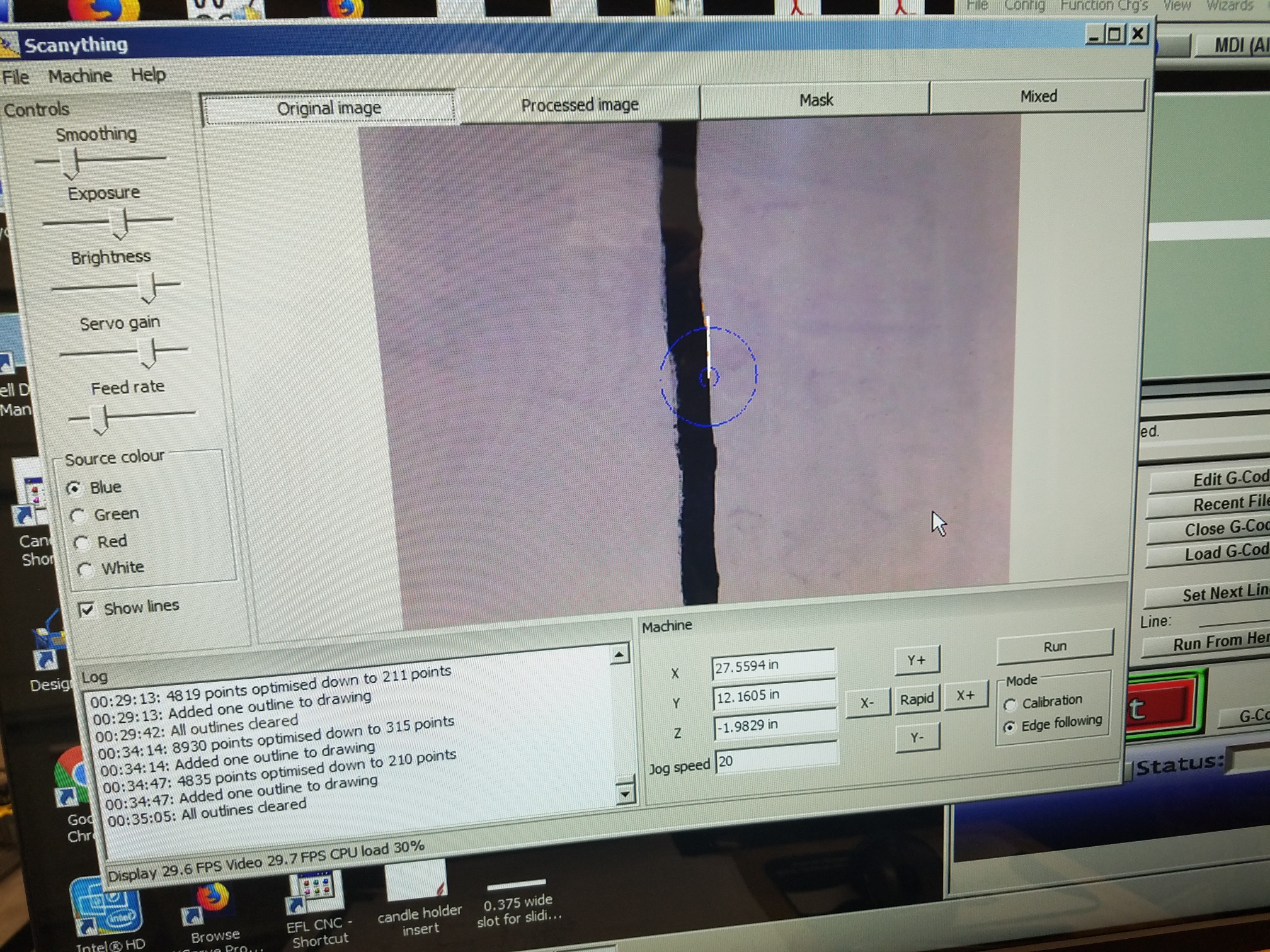

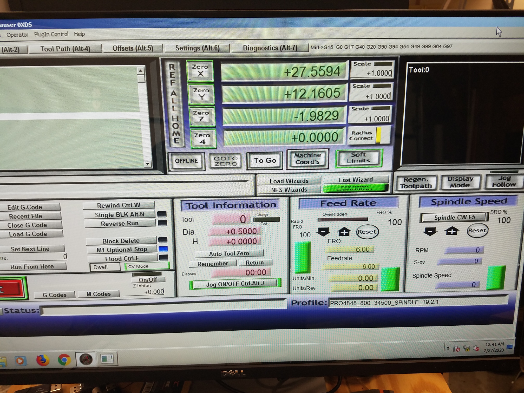

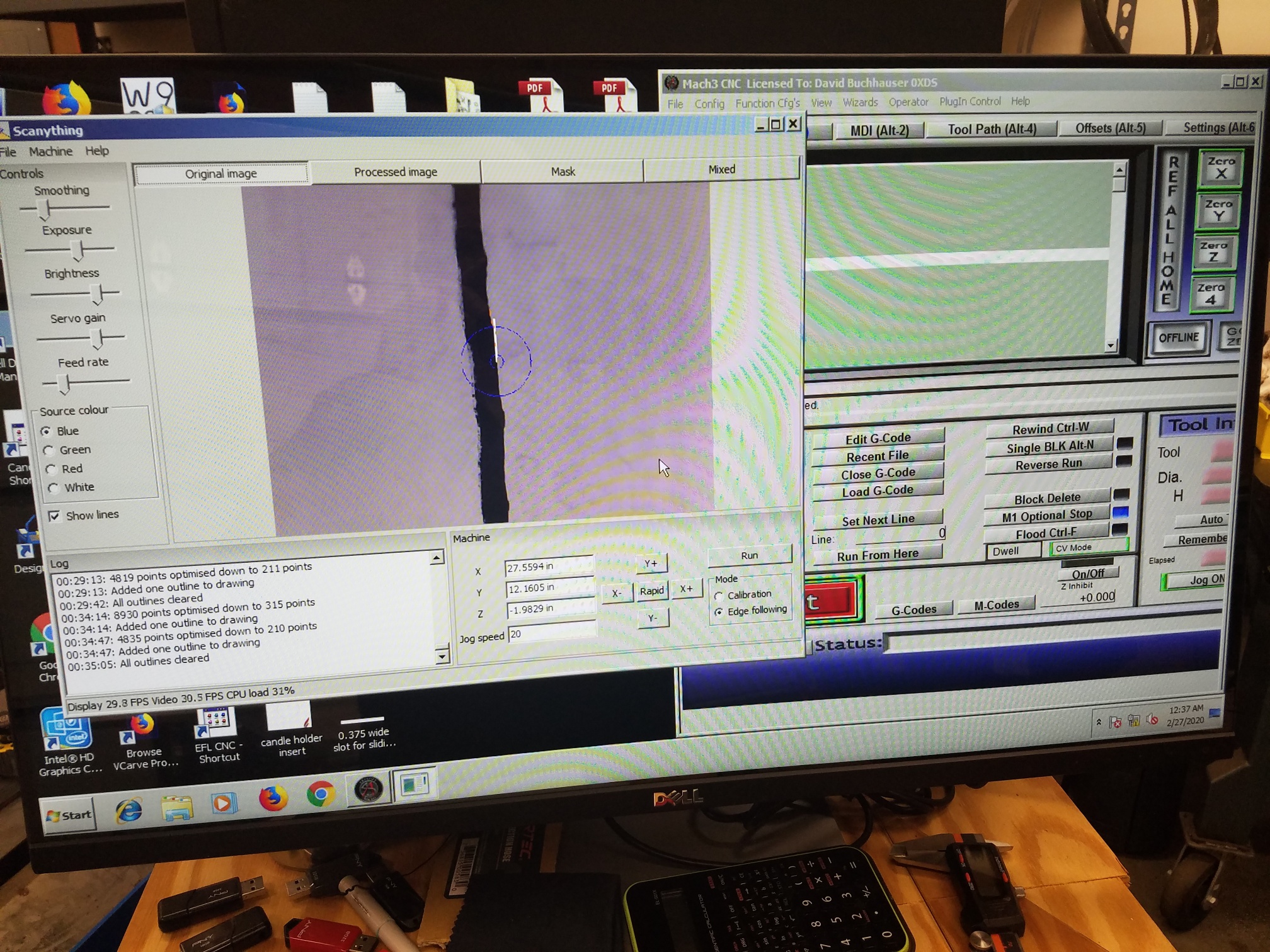

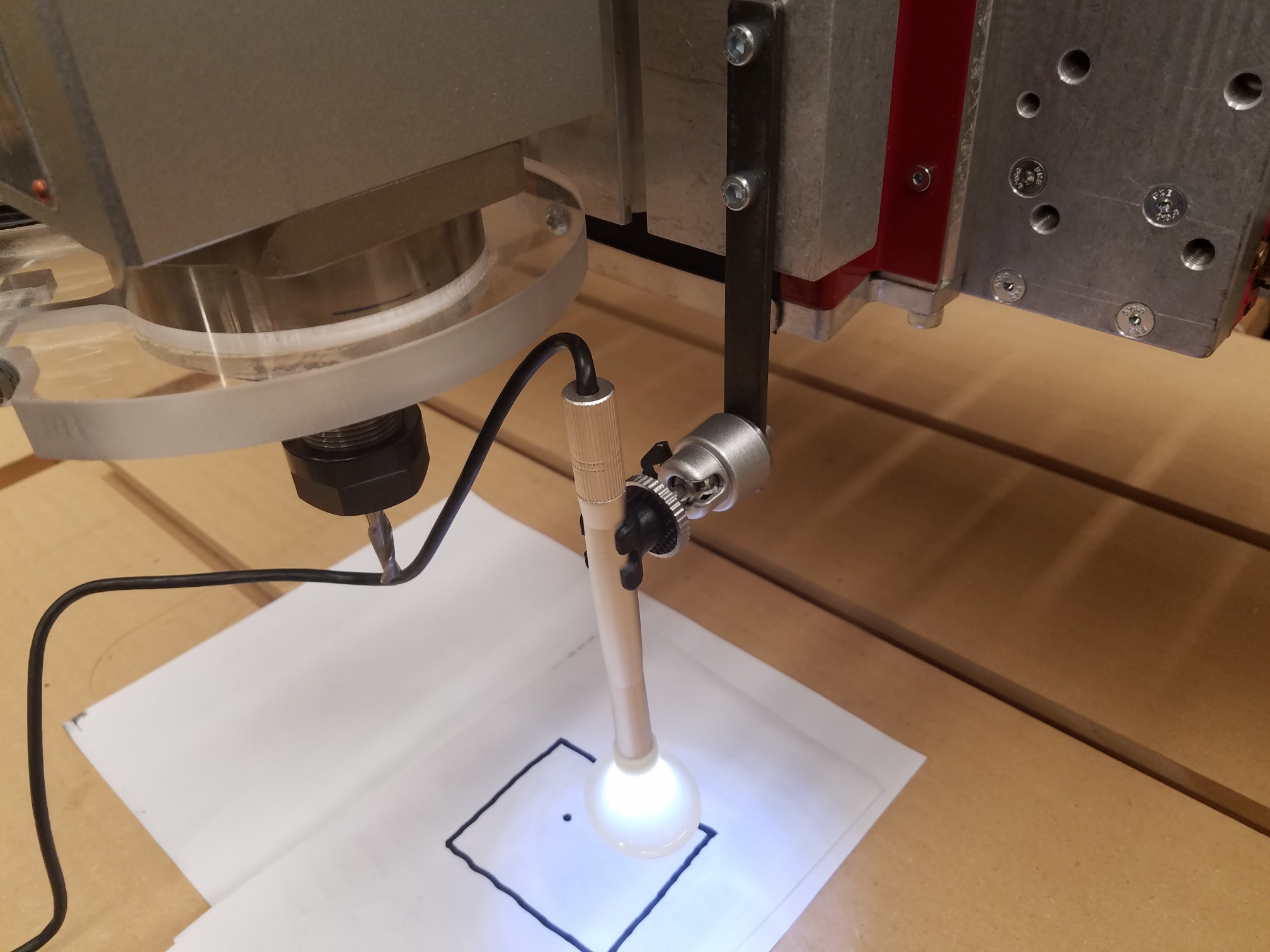

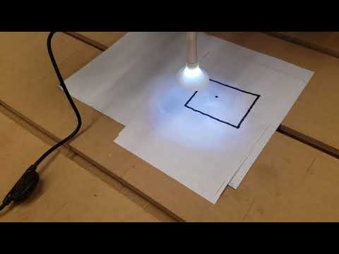

I received and installed the Supereyes camera. I created a small dot on a white piece of paper as described in the Scanything setup video. When attempting to calibrate, it would lock onto the dot (in the center of the screen), then shift the camera so the dot appeared in the lower right corner of the screen. It then moved until it locked onto that dot again. Then it zoomed around (to lower left corner, upper left corner, etc. and ended up back in the center and went to the right, then left rapidly (I think several times) and then stopped. But it did not lock onto the dot in the lower left corner, upper left corner, or anywhere else - and did not show that is was ready to scan as shown in the setup video.
But when I then selected “edge following” and run, the large circle with the line popped up - so I assumed it was calibrated. I quickly drew a box (of sorts) to test it out. I was amazed that it did indeed lock onto the edge and followed the edge all the way around and back to the starting point. Then it ask me if I wanted to save it, and I was able to save as a dxf and open the dxf with Plasmacam Design Edge and create a cut path. I tried this several times with both the outer and inner edges of the line and it worked perfectly. Here is a video of it following the edge.

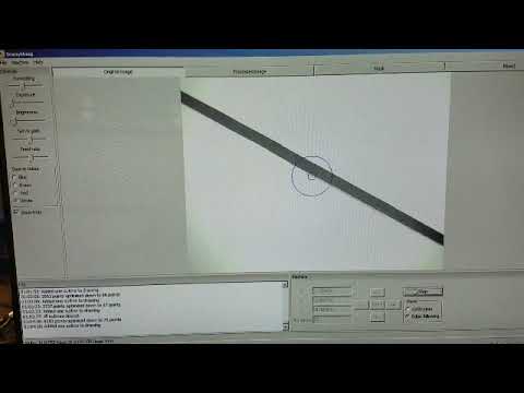

Here is the camera following the edge.

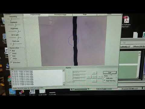

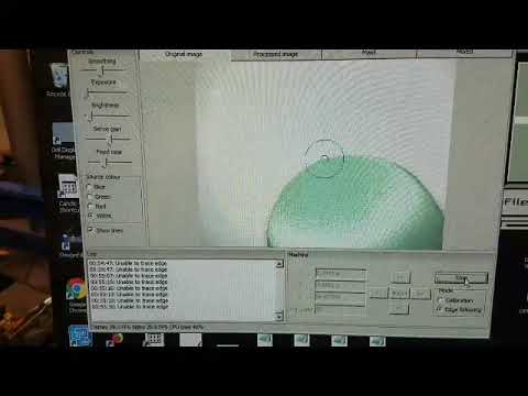

I then tried to trace a metal bracket, and several other items and it would not lock on. It would follow the edge very briefly, and then give the message that it had lost the edge (the same message that popped up many times in the Scanything setup video). At one point the Scanything program shut down (crashed) and I had to restart it. After that, I was not able to run the calibration successfully. I tried adjusting the settings (feedrate, servo gain, brightness, etc. ) and it would not calibrate. I also tried moving the camera closer to the dot (lowering the z axis) and moving it farther away (raising the z axis) with no improvement.
I am wondering if going to the better camera (suggested/recommended by Les) and adding the led light ring around the camera (also suggested/recommended by Les) would possibly help it to calibrate better.
I really don’t understand why using the ethernet/ess instead of a parallel port would cause problems with calibration. Is this due to some latency with the data transmission thru the ethernet/ess as opposed to a quicker response with the parallel port. By quicker response, I mean a shorter elapsed time between the initiation of a jog by Scanything/Mach3 and the actual machine movement.

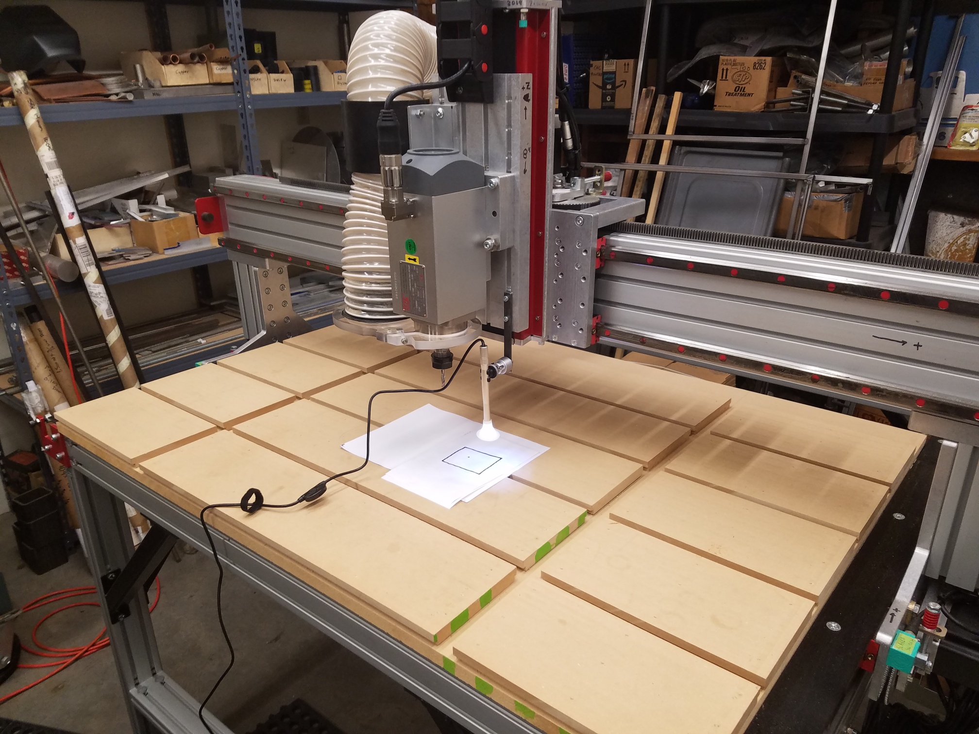

Here are some photos of my setup.

I noticed the camera in the Arclight Dynamics auto tracer demo video seems to be a lot closer to the table compared to the distance I was using. Does this make a difference as long as the camera is in focus. Also the Arclight Dynamics camera does not seem to have any internal light source, or maybe I’m just not seeing it in the video.

When calibrating and running watch the ‘mask’ view. This is what the edge follower actually sees. If you get flaky calibration and randomly losing the edge it is often due to the brightness setting. Again if you watch the mask while adjusting the brightness you will hopefully find the setting that gives the clearest view.
The camera distance mainly affects accuracy. The closer you run the more accurate the results. Conversely the further away you run the faster you can scan. Depending on the amount of ambient light you may also struggle to get enough light on the subject if you run too far away. Keep an eye on the video FPS. If it drops significantly below 30 you need more light. The general rule is that you can’t have too much light, though reflections can be a problem with reflective surfaces.

Looking at your video it appears to be tracking quite well, if a bit slowly. Try experimenting with the feed rate and servo gain. Servo gain controls how hard it tries to keep the circle in the center of the screen. Keep winding it up until you start seeing or hearing the machine hunting for position. You may want to deliberately crank it up too high just to get a feel for what that looks like.
As with camera distance there is a tradeoff between speed and accuracy. These cmos cameras take time to scan the image. This means that the top of the image is slightly older then the bottom of the image, causing distortion. You often see videos on YouTube where fast moving objects appear oddly distorted. This is the same effect. Again more light helps as this shortens the exposure time. The XBox Live Vision cameras apparently use a CCD sensor which does not suffer from this distortion effect. The ELP cameras are CMOS but they are pretty sensitive so as long as there is plenty of light they have a short exposure time.

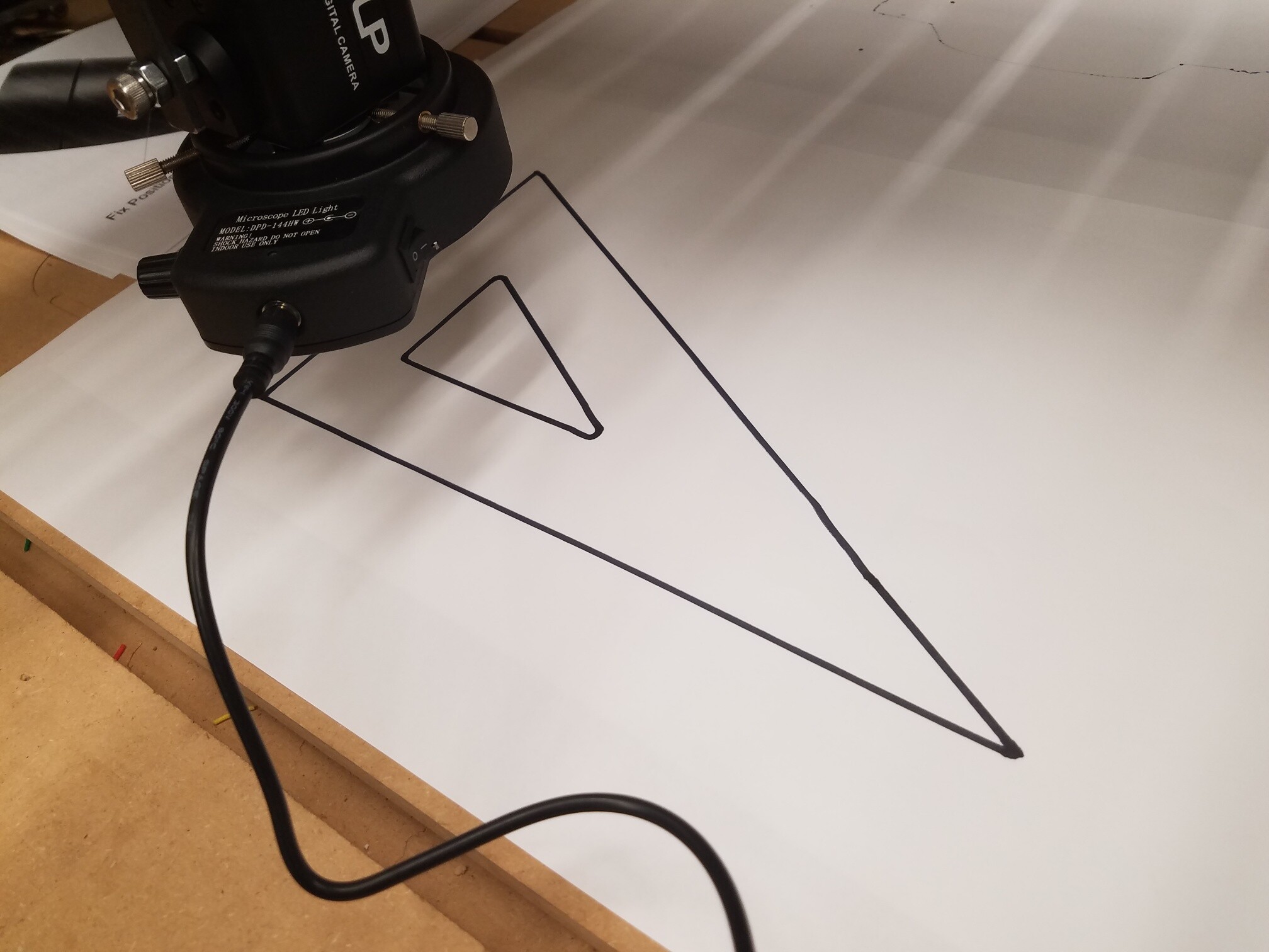

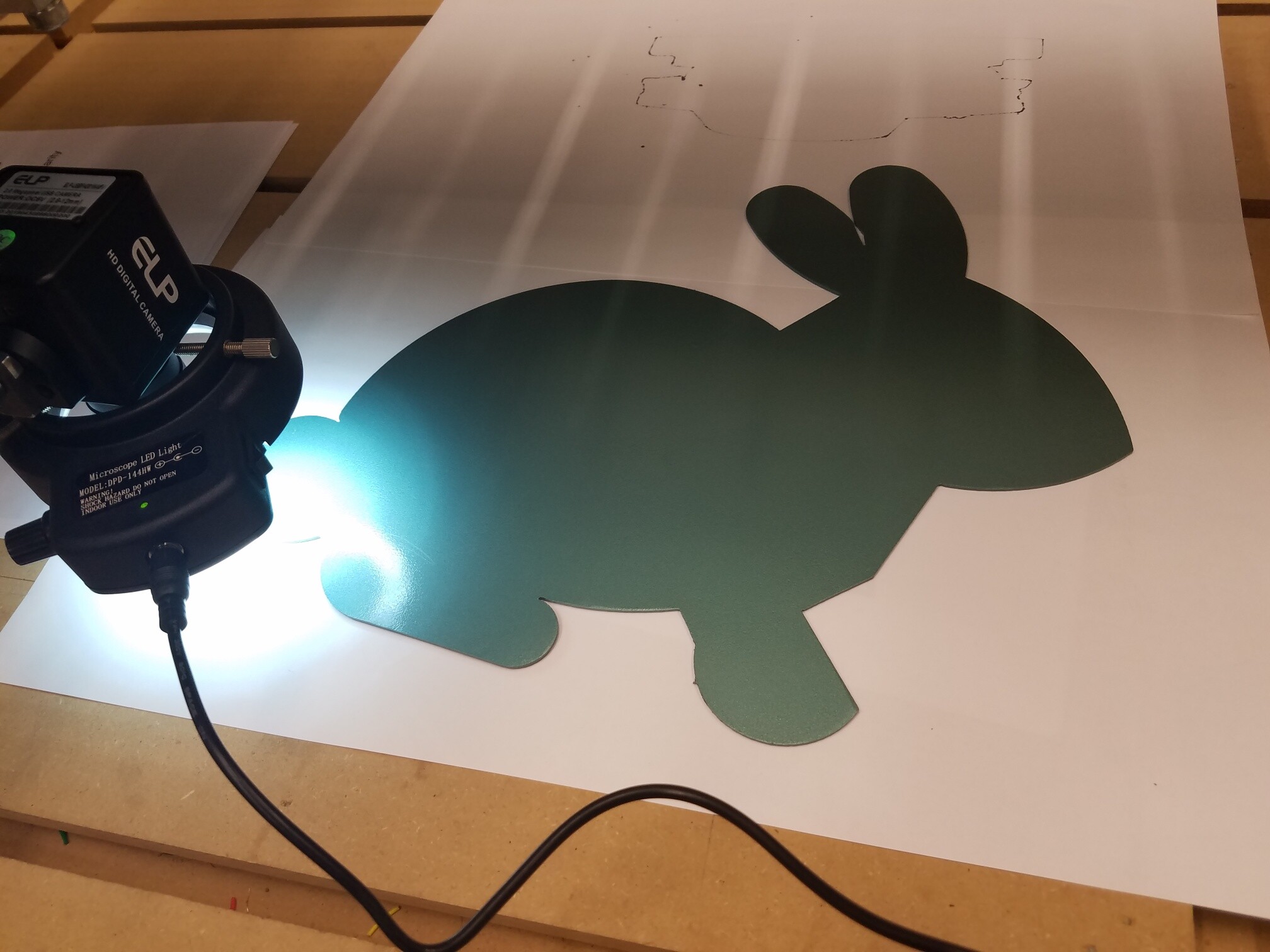

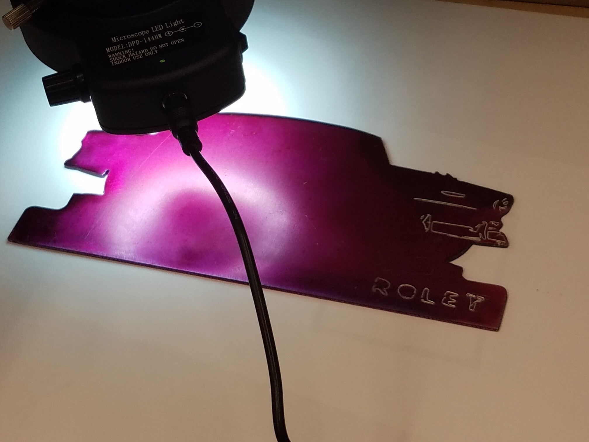

I think I’ve got the new camera and led lamp ring working pretty well. It now seems to calibrate much easier and faster, and tracks pretty well once I get the settings right for a particular situation. I have experimented with the camera adjustable aperture. It seems to work best with it adjusted to wide open. I need the Exposure slider all the way to the left (minimum setting) for it to work. If I turn that setting up, then I lose the camera image on the screen. Here are some photos of the items I have scanned, along with the corresponding videos.

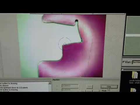

Les - I do have a question. If you take a look at the videos, you can see that the camera target circles seem to bounce back and forth along the path as it tracks the edge of the part. Any idea what causes this, and should I be concerned that it is affecting the trace file? It seems to decrease as the camera slows down around corners, and it isn’t as noticeable at very slow speeds (but still there).
My fps stays around 30, and the CPU load around 45% regardless of my settings changes. Should I be concerned, or is this OK?
So far I am very impressed with the Scanything operation now that I have the better camera and lighting. There is one feature that I wish Scanything had, and that is the ability to save a partial trace without having to trace all the way around the part. I can see where it might become frustrating with larger parts where it makes it almost all the way around the part, but then loses the edge. It would be nice to have the ability to save this partial scan, and restart from where it lost the edge and finish the scan. Would this feature be something you might consider implementing in a future version of the program?
