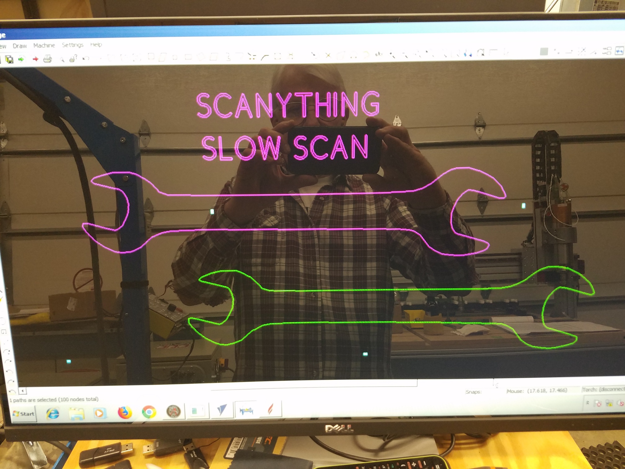

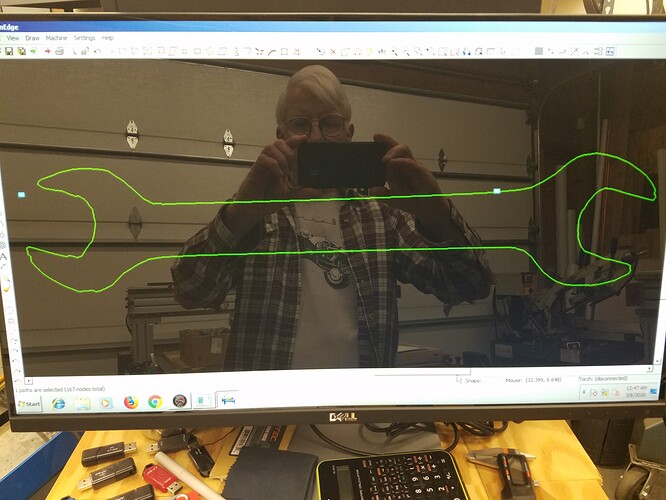

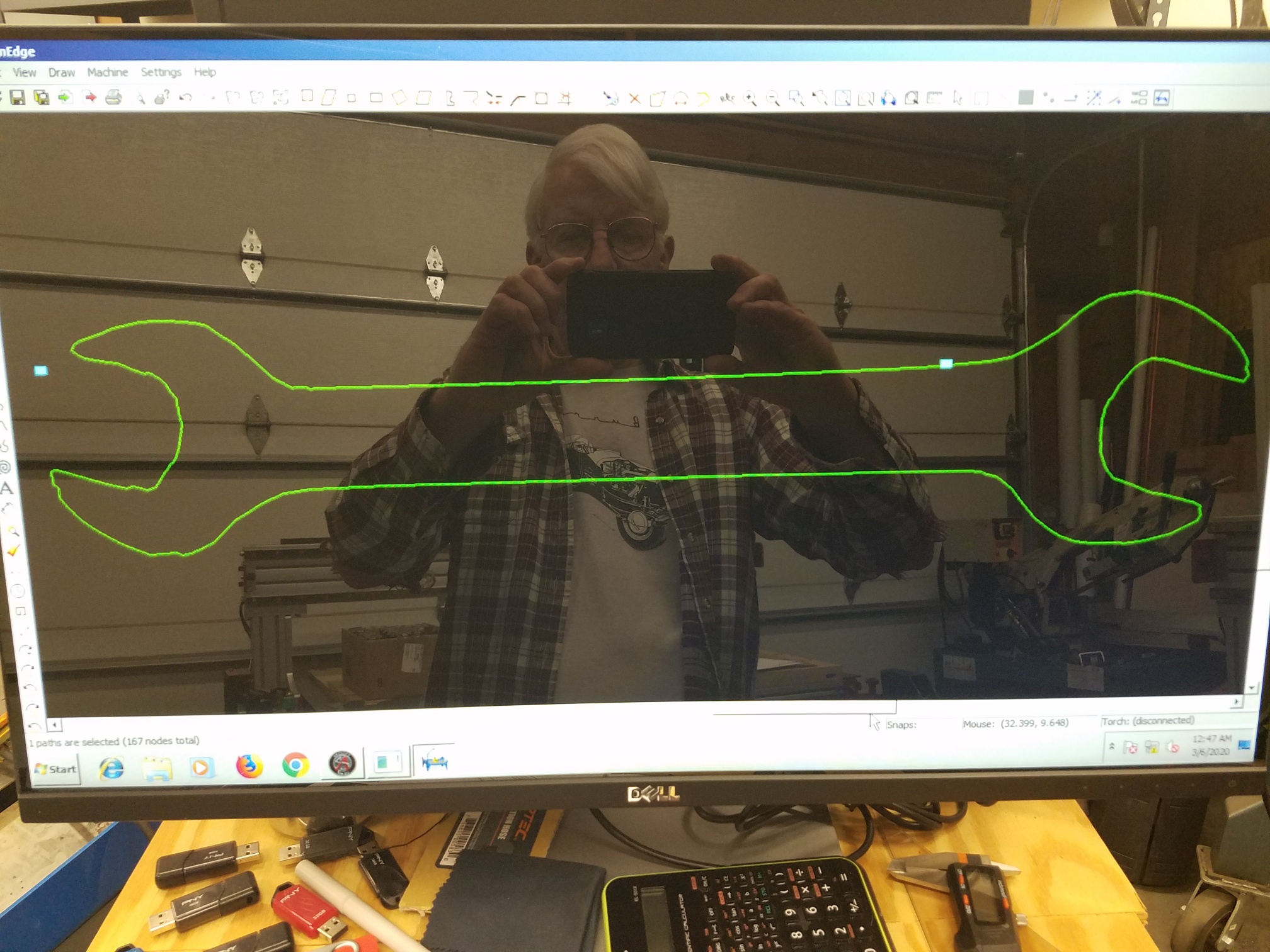

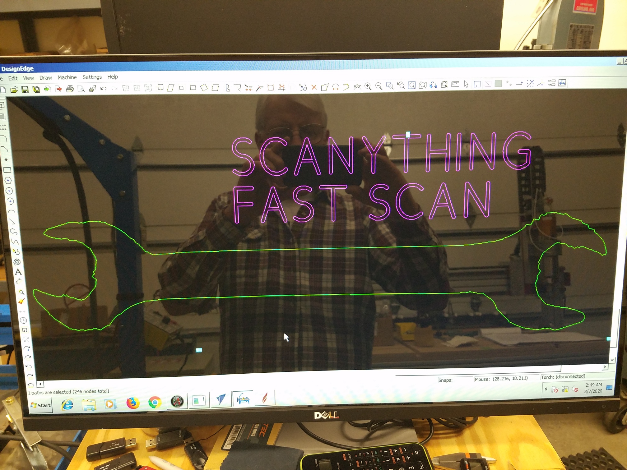

I scanned an open end wrench (shown in the last video). Here is what the resulting dxf file opened in PlasmaCAM Design Edge.

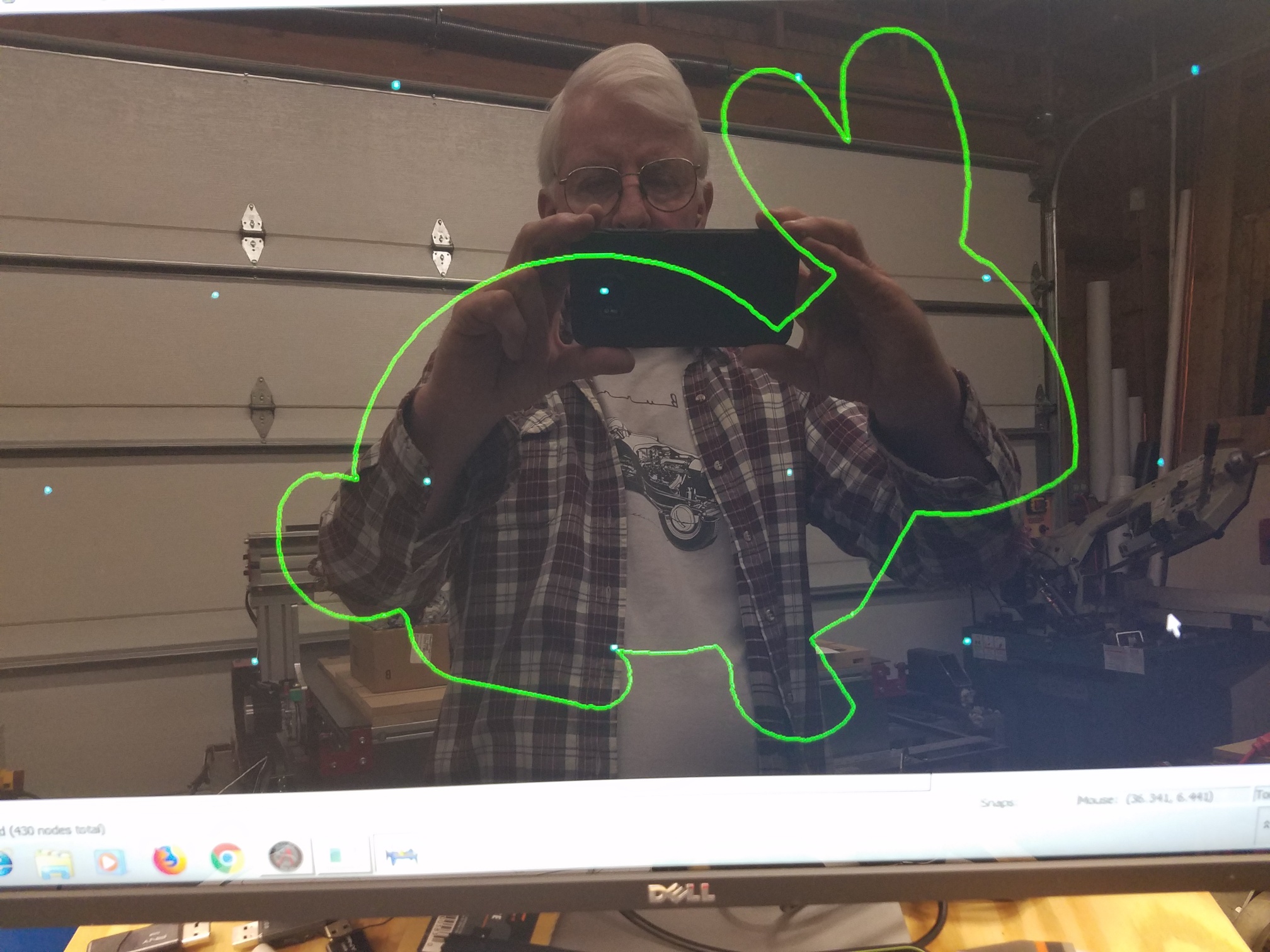

Here is what the rabbit dxf file looked like after scanning. I could run the cut path, cut, and it would look pretty much like the original.

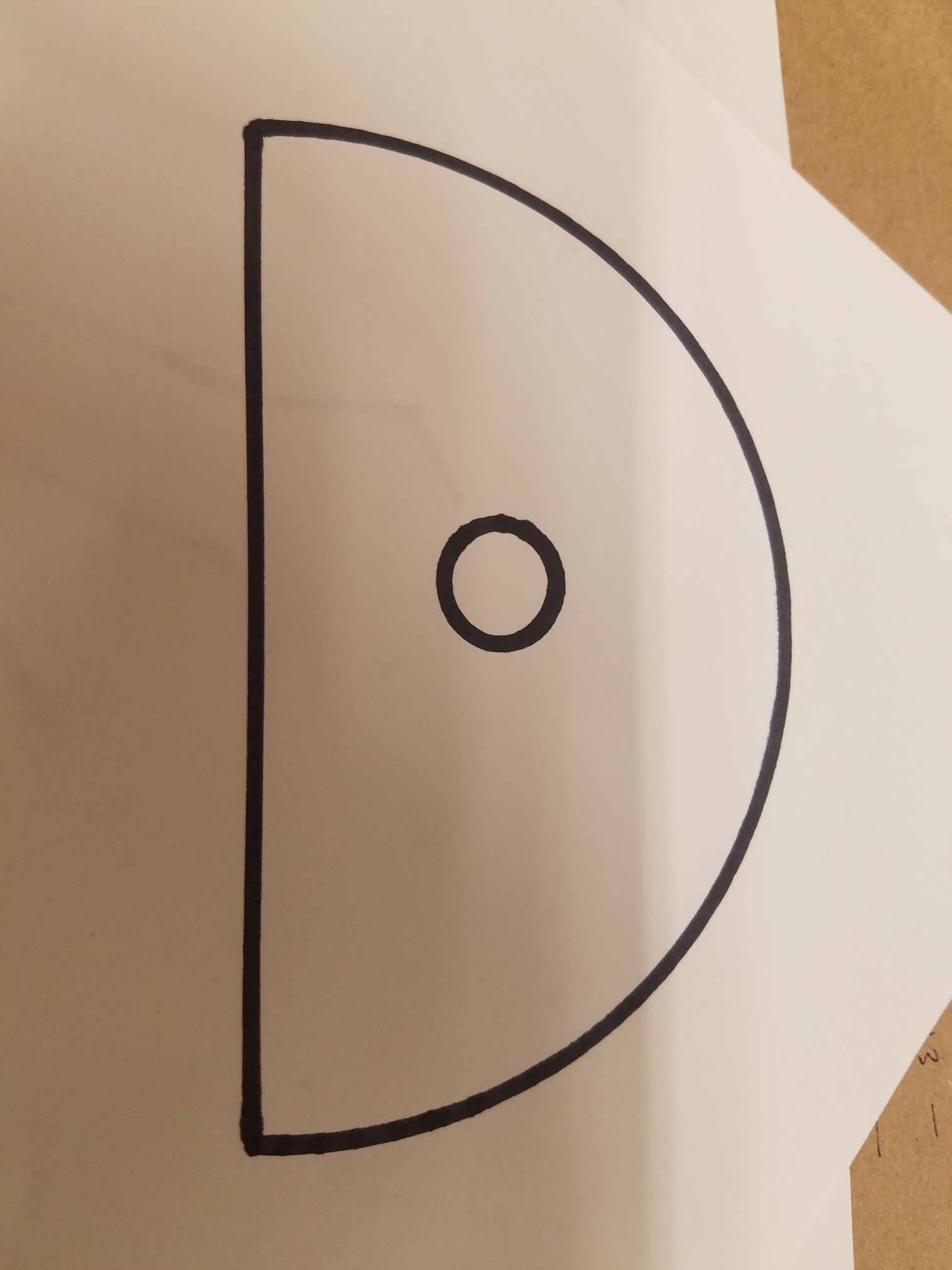

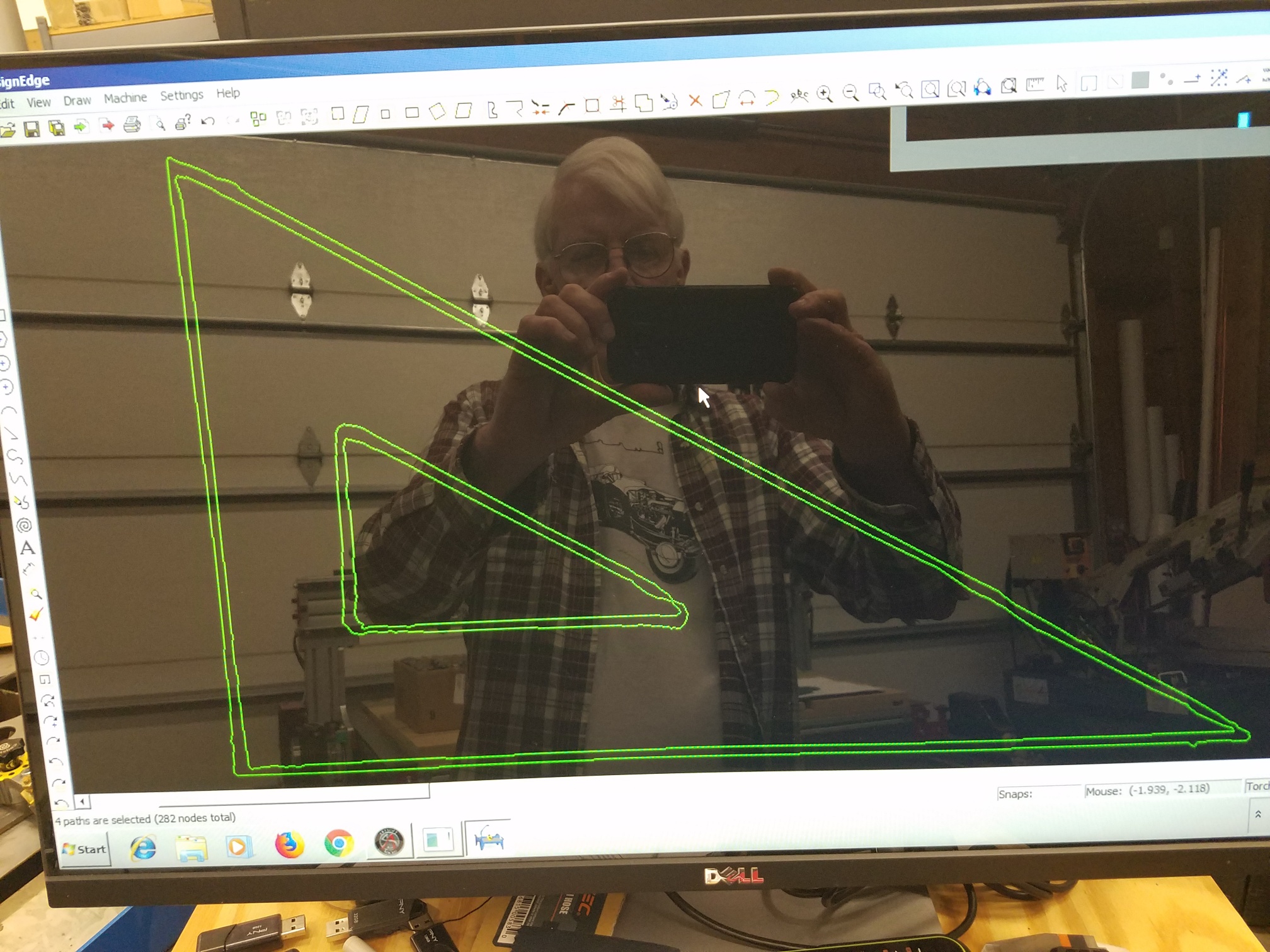

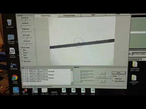

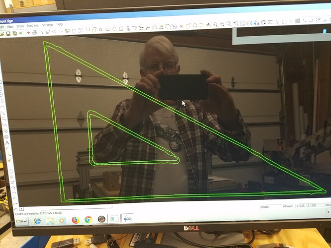

I traced a drafter’s triangle onto a piece of white paper using a black Sharpie. I wanted to see how closely the resultant dxf file resembled the original drawing as far as straightness of the lines. I think it’s pretty good. Obviously it would be better to just draw it in a cad program, but I wanted to see how it would turn out.

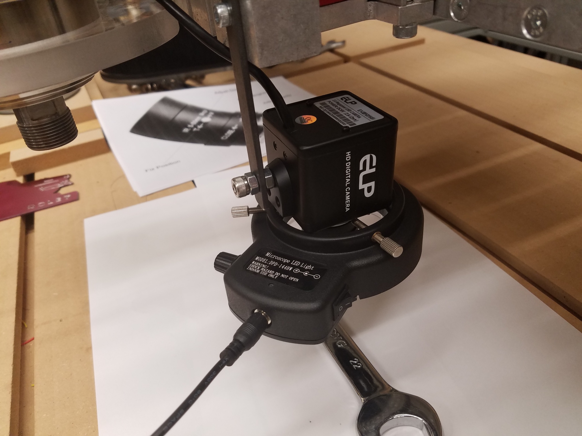

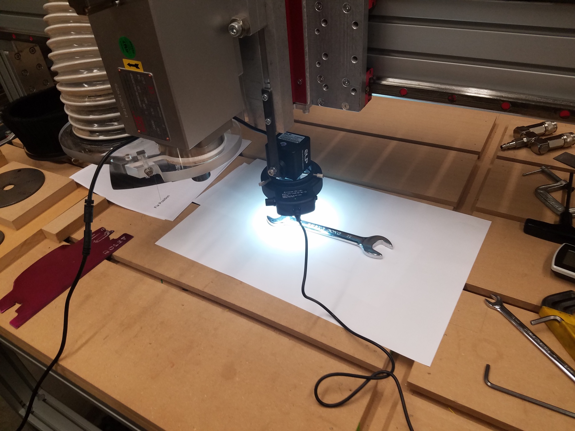

This is my camera/ring lamp setup.

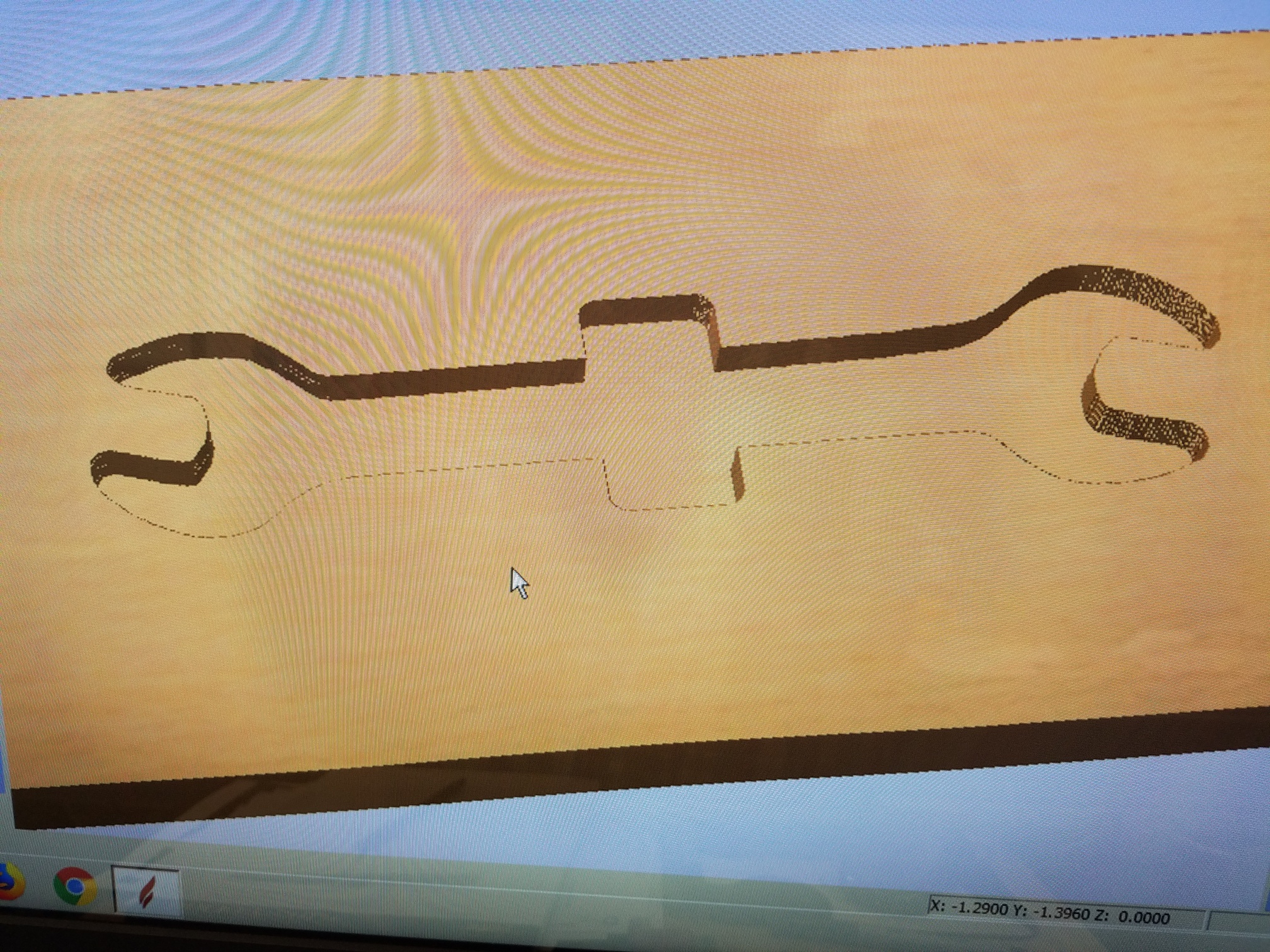

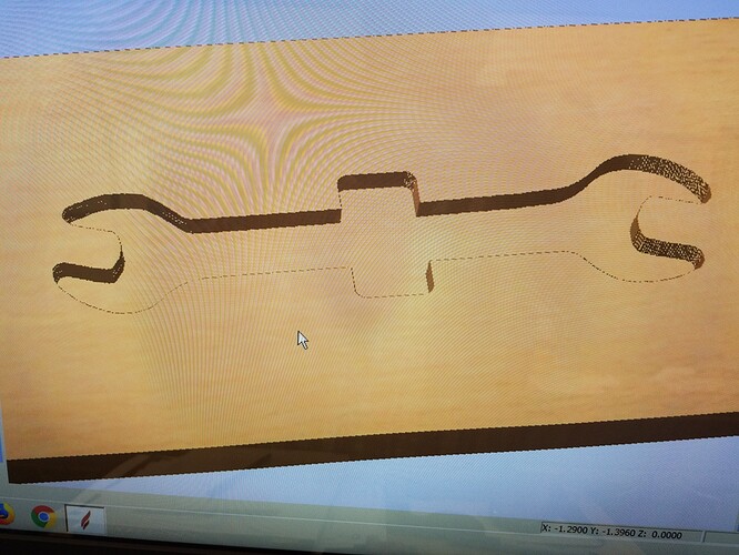

After I scanned the open end wrench, I used Vectric Aspire to do some “node editing” to clean it up. Then I offset the outline of the wrench to the outside to create a slightly larger copy. This will be part of a tool holder board for the cnc router. It will have pockets for the two collet wrenches and an assortment of commonly used router bits. I’ll cut a sample first in MDF to check the fit. I added finger slots to facilitate removing the wrench from the pocket.

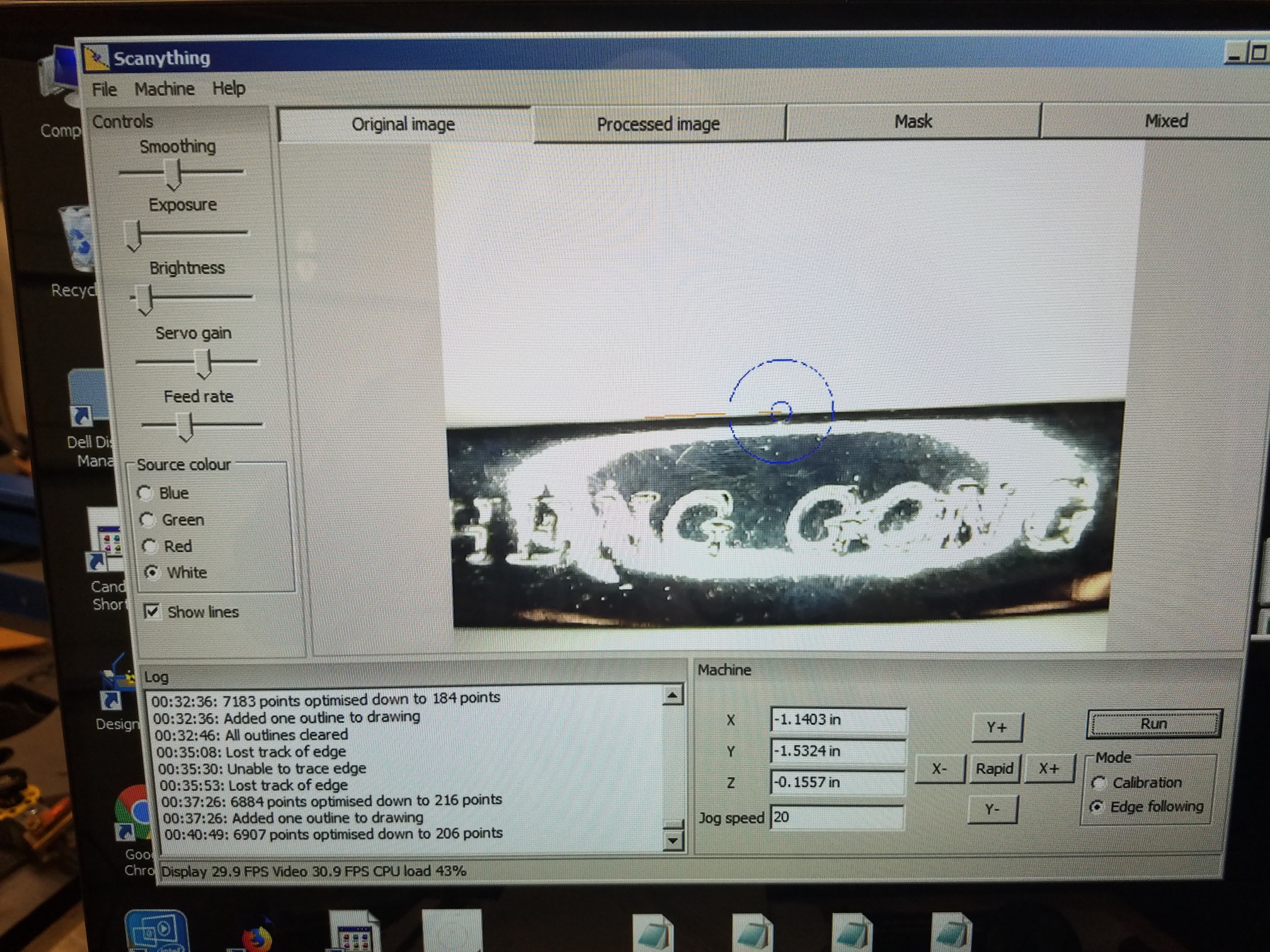

That’s pretty normal. As long as the circle stays roughly near the middle it won’t affect accuracy. The actual image to vector conversion is a lot faster than the machine movement. It tends to scan a bit then stop and wait for the machine to catch up.
My fps stays around 30, and the CPU load around 45% regardless of my settings changes. Should I be concerned, or is this OK?
The FPS is good. CPU load seems a little high but not too bad. Smoothing is a CPU hog so turning it down may help. Running slightly out of focus has a very similar effect to smoothing.

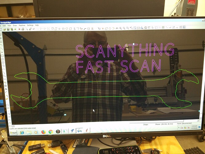

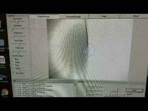

Thanks for your response. I’m happy to hear that the camera target circles “bouncing” is a normal phenomena, and not a result of my using the ESS instead of the parallel port. I do have one other question with regards to the camera/tracer “accuracy”. I will illustrate this with the photos below. I have discovered that if I really slow down the Feedrate, I get very nice results with smooth contours around the trace. If I increase the Feedrate (but still less than 50% of the slider range) portions of the trace become jagged. Is this a normal phenomena, or perhaps caused by either the ESS or a problem with the rigidity of my camera mount? I don’t have a problem running the Feedrate slow, and I would rather have a “clean trace” than spend lots of time doing node editing.

Those jagged edges look like camera movement to me. How solid is your mount?
Another possibility is a timing issue with the ESS communication.

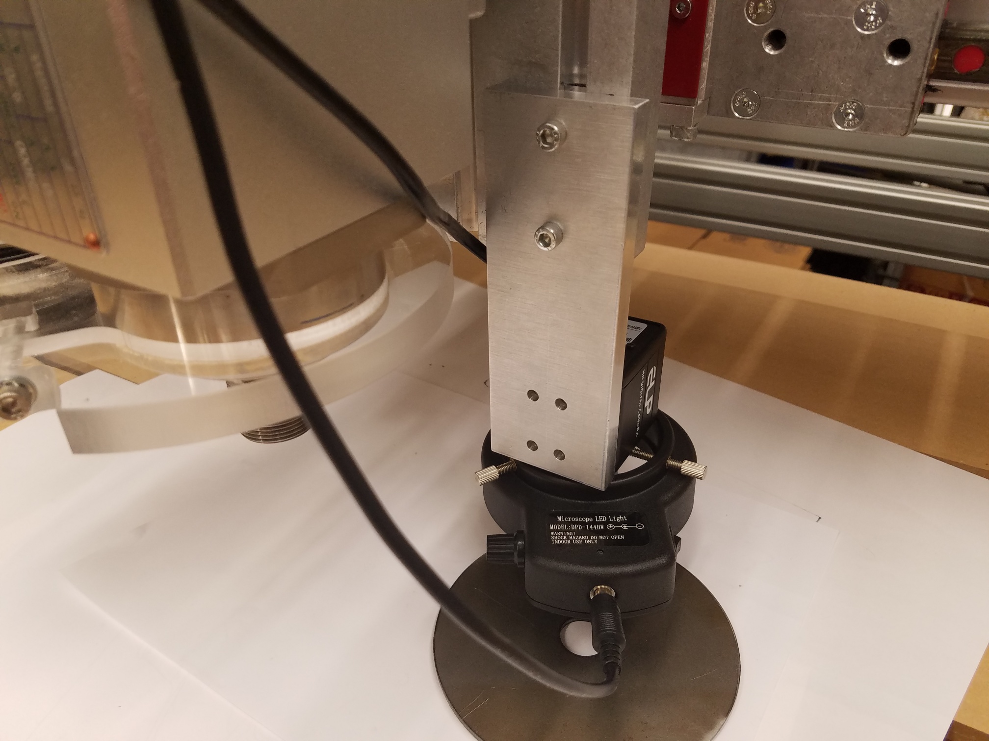

The mount is not all that solid. It was temporary to test. I am making a more substantial mount from 3/8" thick Aluminum plate. I am thinking it is the camera moving with the mount flexing. I notice when I do a quick jog in the Y direction that I can see the image moving back and forth on the screen. Also I can tap the camera with my finger and see movement on the screen. I will keep you updated on my progress. I should have the new mount finished in the next several days.

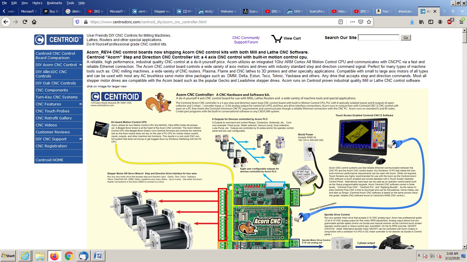

I am using the Centroid Acorn controller on one of my other cnc routers. The control program is called CNC12. It is a free download for testing - but they limited the size of the g-code program with the free version. I don’t think this would be a problem for testing. I am running their “Pro” version so I can run the Auto Squaring of Software Paired axis with auto homing for my machine. Alot of the guys seem to be switching from Mach to Centroid. I thought I’d try it out. It seems to be pretty well supported, and pretty much “open source” as far as the macros go.

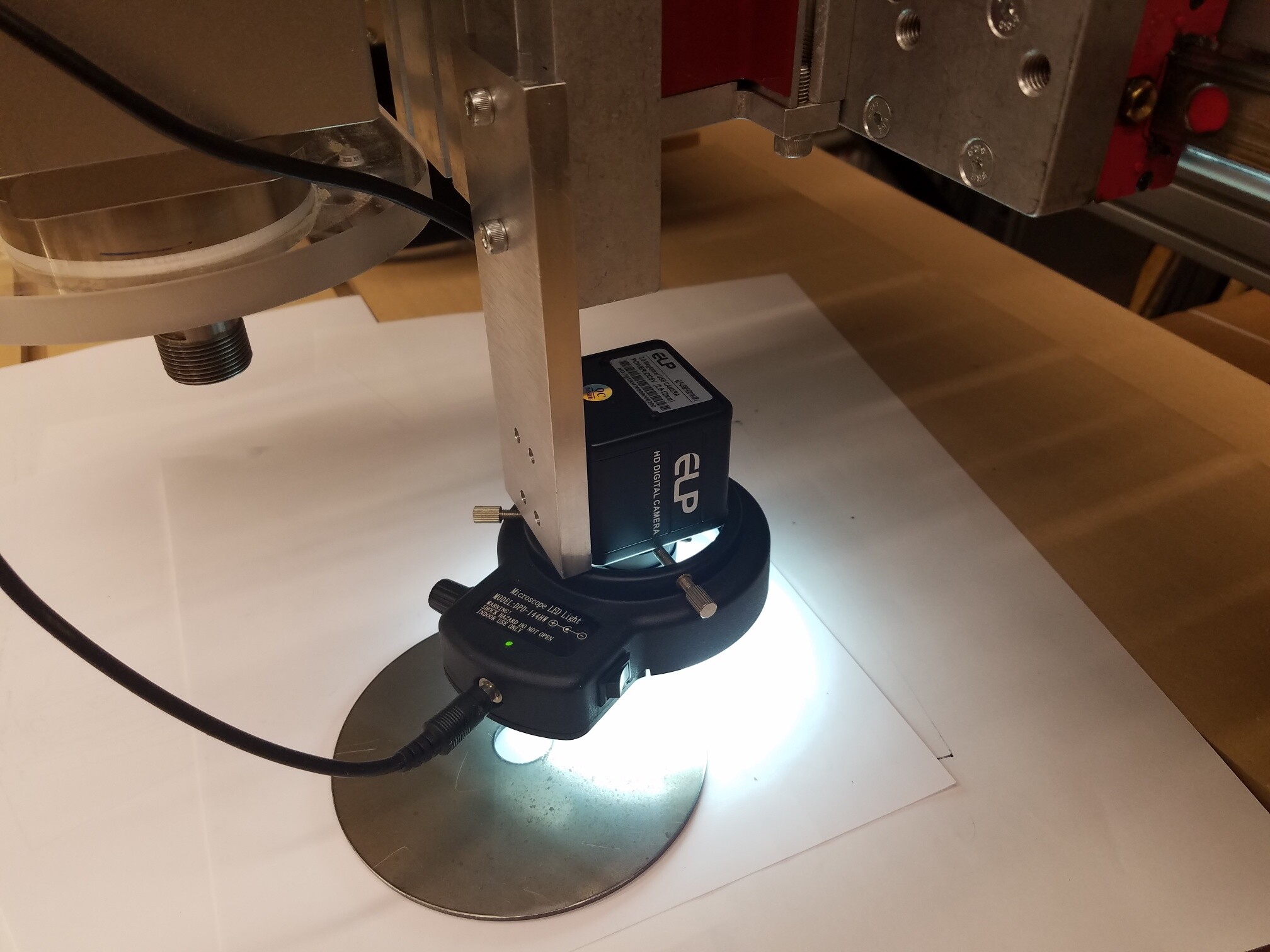

I have upgraded my camera mount to a much more substantial 3/8" thick billet aluminum bracket.

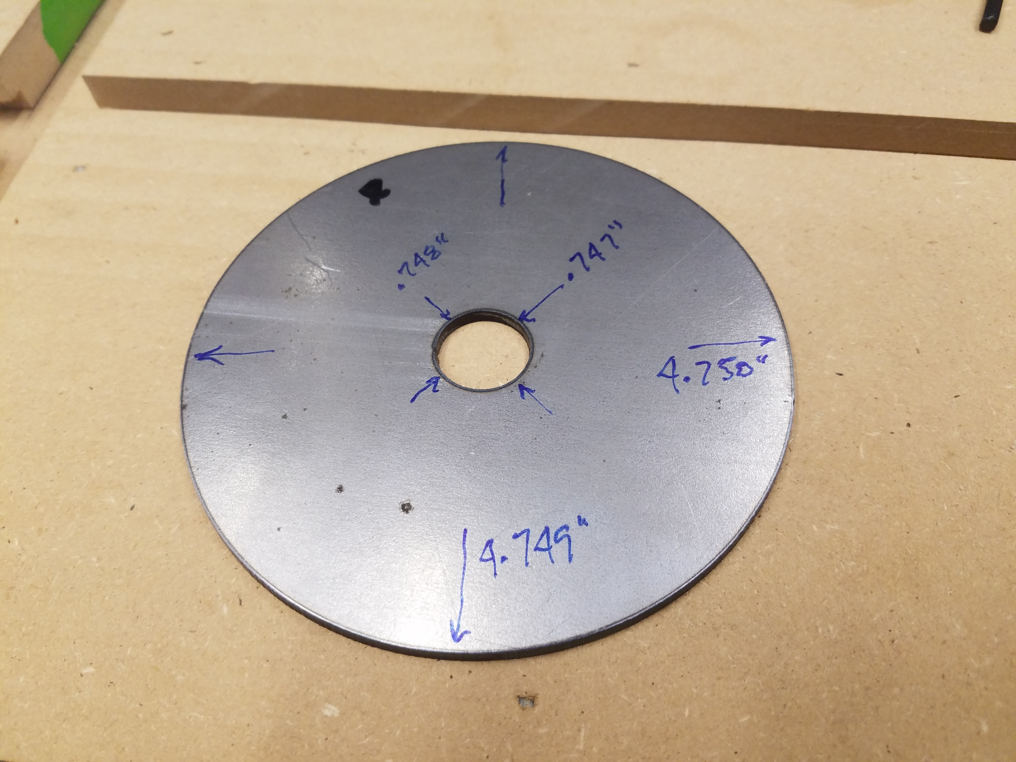

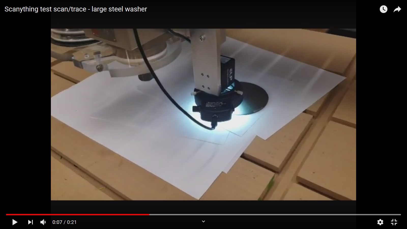

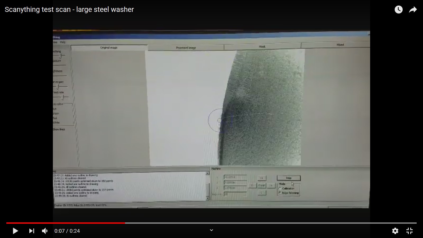

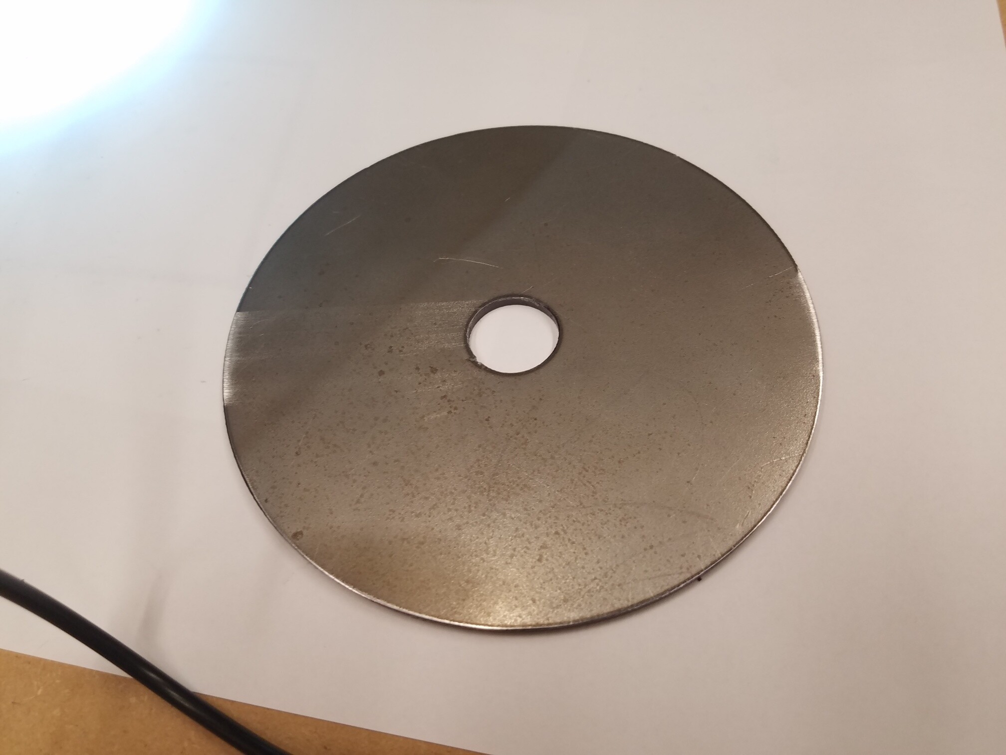

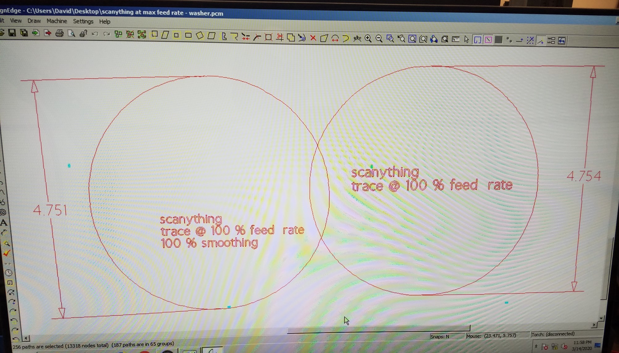

I believe this has made a great improvement in the quality of my scan/trace results. On most solid objects, I can now run at the maximum feed rate with no problems. I am also very impressed with the dimensional accuracy of the resulting dxf produced by the trace. Here is one example. This is a large washer cut on my PlasmaCAM cnc plasma table. It was originally drawn with and outside diameter of 4.750". The cut part measures very close to this.
The actual part does have a very small amount of ripple on the plasma cut edges (outside circumference and inside the center hole edge) which may or may not contribute to any waviness in the resultant dxf after tracing. I assume that when I am have Smoothing set to 100% (or even 75%) this may help to eliminate this in the trace.
The dimensions on the trace dxf are very close to the actual measured dimension of the part. I have traced several other round objects with similar results.
Here are several videos I took. I do normally look at the Mask view when calibrating and adjusting the levels, but I enjoy watching the Original Image when scanning. I still have the same problems as before when tracing/scanning the shiny wrenches. Perhaps this is due to reflections from the wrench that cause problems at higher feed rates. I may buy some of the black hair spray you recommended to see if that helps, but I’m OK with just going slower with problem parts. I have the Z height set so that the camera is about 3/4" above the table, which seems to work pretty well for me. I purchased a 25 ft. active USB extension cable
https://www.amazon.com/gp/product/B07P8X2MRX/ref=ppx_yo_dt_b_asin_title_o09_s00?ie=UTF8&psc=1
along with a 33 ft. extension cable for the camera LED light ring
https://www.amazon.com/gp/product/B075HFHBK5/ref=ppx_yo_dt_b_asin_title_o08_s00?ie=UTF8&psc=1
so I could run the cables thru the cable tracks on my table. Everything seems to work great with no apparent problems due to the long USB extension cable.

This is the camera I ordered from Amazon:
https://www.amazon.com/gp/product/B07R4CLRQH/ref=ppx_yo_dt_b_asin_title_o03_s00?ie=UTF8&psc=1
And this is the LED ring from Amazon that I am using:
https://www.amazon.com/gp/product/B07ZRJQ177/ref=ppx_yo_dt_b_asin_title_o03_s00?ie=UTF8&psc=1
