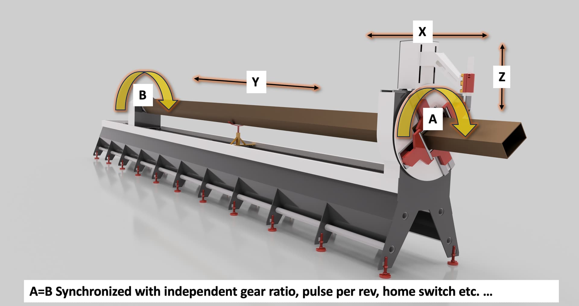

I’m building rotary tube cutter with X,Y,Z and A axis.
A axis should be rotary, but I need to slave this to B in Mach3 because there are 2 separate rotating heads with 2 different motors and gear ratios, homing switches etc.

Usually on 3 axis controllers, Y is temporarily rewired to A, which is physically parallel to X. Are you saying that you’d like rotary to be physically parallel to Y, meaning X would temporarily rewire to B ?
If that’s the case, then I believe that can be done in the pp.
Do you want the pp to have XY gcode with linear distances for both axes,
or YB gcode with linear Y and angular B ?
This 3 axis controller technique also limits you to just rotary cylindars/ round pipe, not rectangle tubing which requires XY and rotary.
Let me try to explain trough picture in attachment.
Perhaps I made a confusion with naming B as an axis.
It is just a slave channel from Mach3 that needs to be synchronized with A.
So that drawing looks like the rotary axis is parallel to X, that is the normal configuration. So you want XAZ gcode coordinates, where XZ is linear and rotary (A or B designation) is angular ? The controller’s Y driver is temporarily wired to the angular axis? If so, then again, you won’t be able to cut rectangular tubing in this config, only round pipe. Rect. tubing requires a functional XYZ linear axes in addition to A or B angular (rotational).
OR does your controller have 4 drivers, XYZA, and you merely want XYZAB gcode where A and B axes have identical angular coordinates in each block ? In this case cutting rect. tubing is fine.

PlasmaRotary Mach3 w XYZAB.scpost (8.9 KB)
PlasmaRotary Mach3 w XYZAB test.tap (2.9 KB)
PlasmaRotary Mach3 w XYZAB test.job (8.0 KB)
