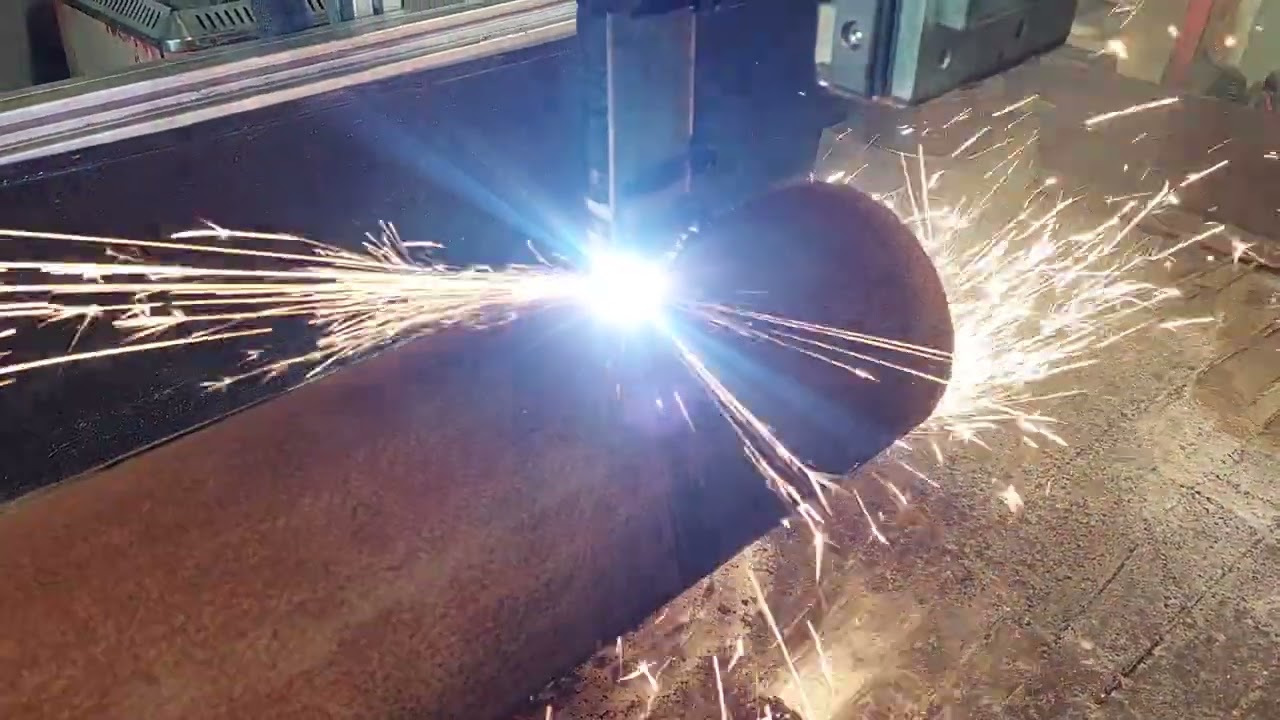

Some experiments with Rotary plasma. I’m still experimenting with markers. I use Mach3 Rotary as code.
Does it use Probe and THC?
https://youtu.be/oYO3UDu08VQ?si=SQi1QI_Cwrp-C4fo
First cnc tube cutting…
With my self-made cnc cutter.
A little to improve in terms of programs…
