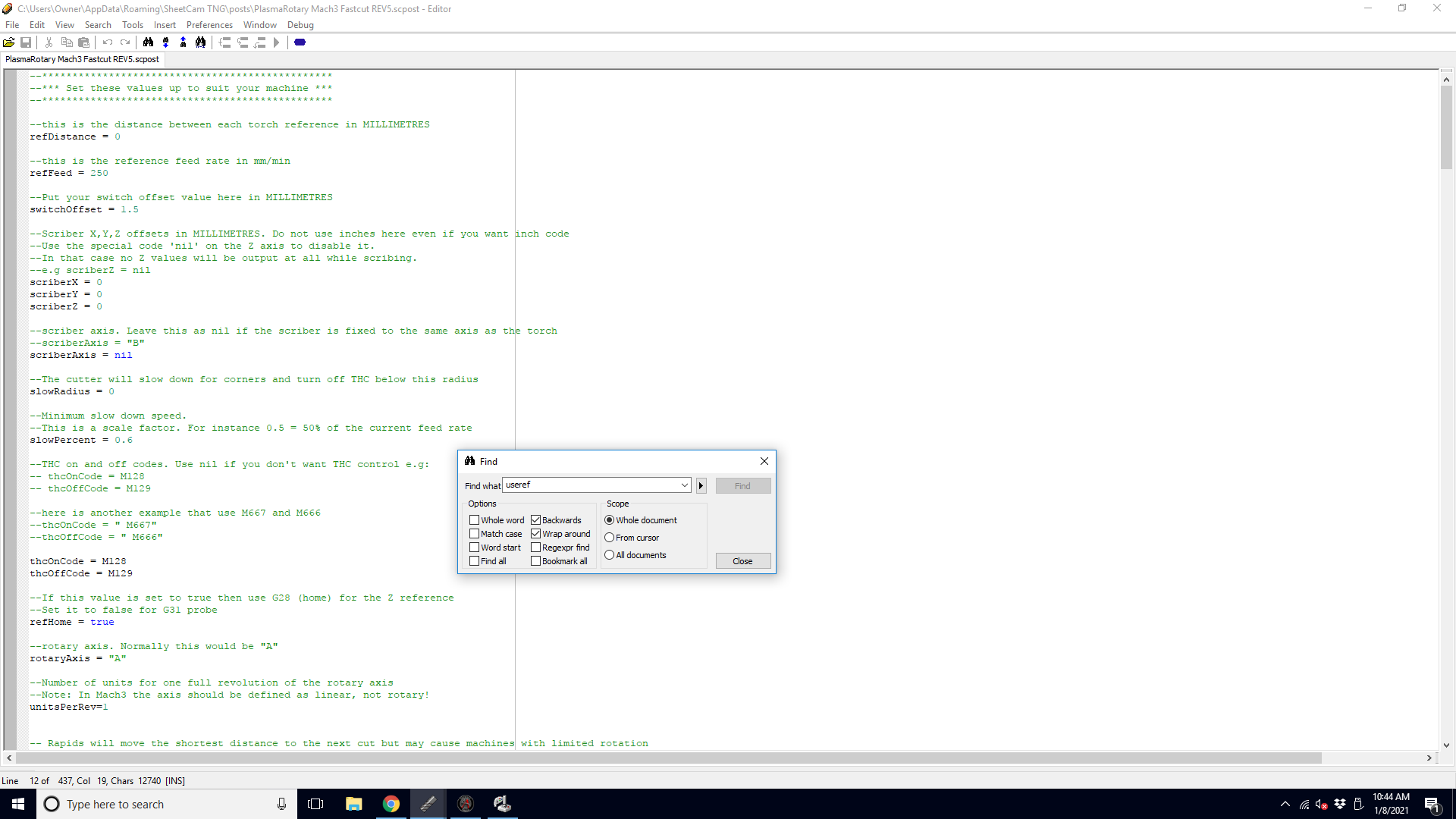

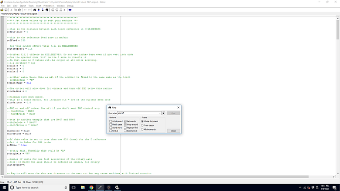

It is odd. Edit your post. On line 8 you should see this:
useRef = true
Change it to:
useRef = false
No useref came up in the post search, I checked that my search is working too. Here’s a prntscrn of the top of the post:
