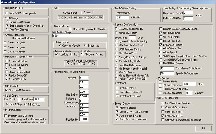

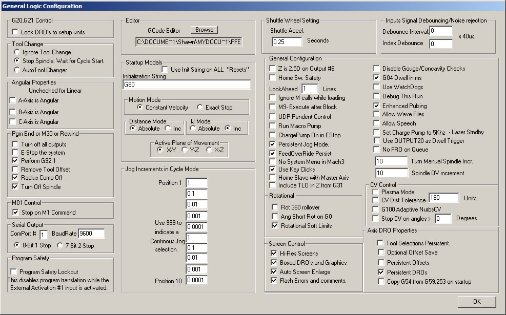

In Mach3 is your A axis defined as rotary? If so set it to linear. Mach3’s rotary axes cause all sorts of problems.
I can’t seem to figure out by myself how to check/change this setting. Guidance?
Config… General config. Angular properties. You want linear axes not angular.
Yeah I had all those unchecked. What’s next to look at?
