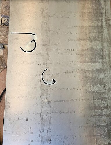

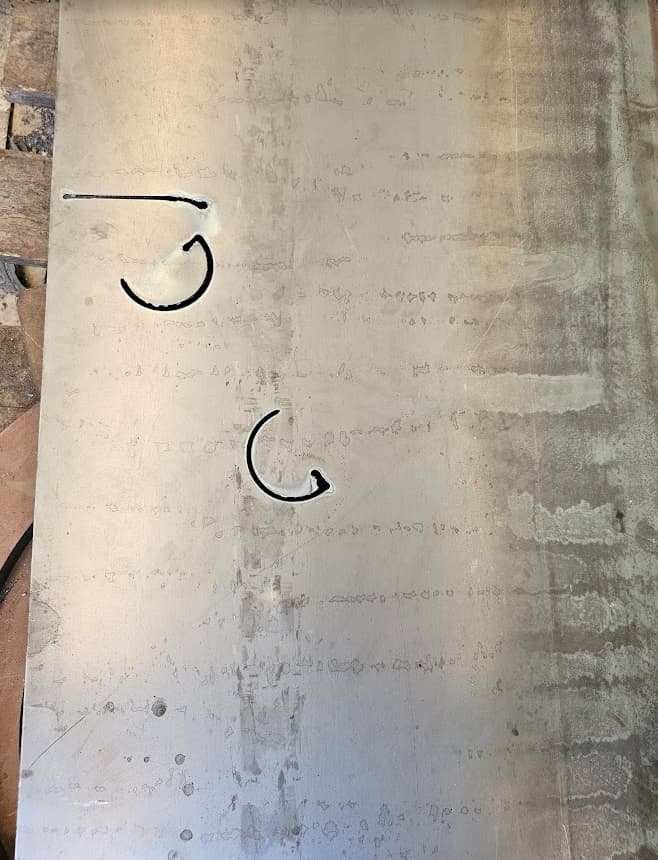

I’m making a post processor for a 1997 CNC plasma machine (Oxyser) with a control called Power C (EIA Gcode), but I’m having problems when the machine tries to make arcs.
With the circles I have activated ARC_SEGMENTS in the post processor options, but when the machine is cutting it only cuts half of the circle and then the head rises, and the G code doesn’t look bad, M7 then 4 arcs and M8.
But when you run the program on the machine only the first two arcs are cut, then the head rises and continues making what was missing from the circle but without cutting.
Hope someone can help me, thank you very much

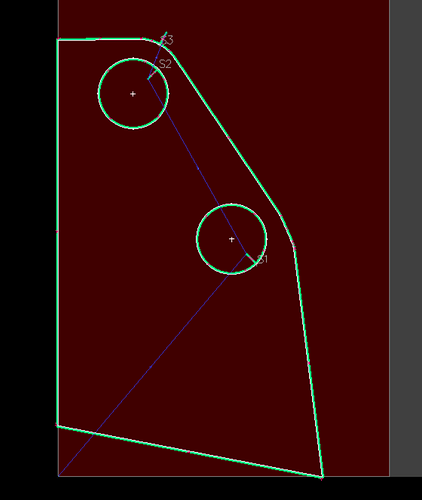

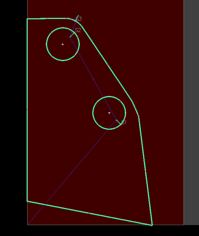

Hello,
I’m attaching the files, as well as an image of the test performed on a sheet metal. As I mentioned, it only cuts half of the circles even though it completes the entire path. The outer contour also has problems when it encounters an arc.
I’m also attaching a program for that design that works correctly because it was created with the original software.
Is it possible to have Sheetcam also generate G41 and G40 codes?
Thank you very much for your help! Have a nice day :slight_smile:
Oxyser Postprocesador Forum.scpost (1.9 KB)
testProMotionNestRobotronicOyTXT.txt (847 Bytes)
testPostprocesadorForum2.txt (1.2 KB)
sanchezNacho.job (5.9 KB)
