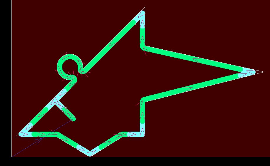

having a problem with one of the path rules (on inside corners).
I drew a shape in cad to have two 45 degree angles, a 90 degree angle, an angle less than 45 degrees, and an angle greater than 90 degrees.
I also gave the shape perpendicular/90 degree leadin/leadout.
I created a rule On Inside Corners tighter than 50 degrees, expecting the rule to be applied to the two 45 degree inside corners and the tightest inside corner.
However, the rule is being applied to ALL inside corners plus the perpendicular leadin and leadout.
Is this a bug or something I’m missing. Job file attached.
Keith.
PATH RULES TESTING (inside corners).job (5.61 KB)
In this case ‘inside’ and ‘outside’ are probably a little confusing. An outside corner is any corner where the cutter has to roll around the outside of a corner. An inside corner is where the cutter is going into a corner and has to make a sudden change of direction. In your example all of the inside corners are triggering a rule.

OK, I >>THINK<< I understand that.
So an inside corner is any corner less than 180 degrees. This causes a sharp change in direction of the tool.
On the contrary an outside corner is any angle greater than 180 degrees and therefore the tool rolls around the corner. And therefore on an “inside offset” cut (as my drawing is), we can have both inside and outside corners.
I seen the “roll around the corner” thing yesterday when playing with the “On Arcs” rule and the rule was also applied to outside corners because the actual tool path was an arc going around the outside corners. On a side note regarding that, would it not be a good idea to disable the “On Arcs” rule being applied to outside corners, or at least have a tickbox option to enable/disable it ? I initially thought it was a bug when corners had the rule applied too.
Getting back to my “On Inside Corners” issue, all of the corners in my drawing are less than 180 degrees and therefore inside corners. So with a “Less than” setting of 50 degrees, shouldn’t the rule still only be applied to inside corners less than that angle. I mean is the overall meaning of the rule:
“On inside corners that have an angle less than 50 degrees” ??
Or am I still not understanding something.
Keith
Yes, that’s correct. However it is better to think of a straight line as 0 degrees, an outside corner is a positive angle and an inside corner is a negative angle. We are after all interested by how sharply the cutter has to deviate from a straight line.
The angle is how much the corner deviates from a straight line.
Aah so that’s how it works, thanks very much Les, I would never have guessed that. This info is getting archived.

I could add a ‘exclude corner arcs’ check box. That way older rule sets would still behave the same way as they always did until you select that check box.
Sounds great, thanks Les.

Oops, sorry I thought I’d done that. It is ready for the next release.
just downloaded v6.1.64, and no sign of the check box.
Keith
I did say it is ready for the next release. That will be 6.1.65.
Apologies Les, my mistake.
I seen a user post about an update and thought that one had came out after you said that.
Keith
just downloaded the next update.
Thanks very much for the additional check box in the On Arcs rule. Just tried it and works perfect.
