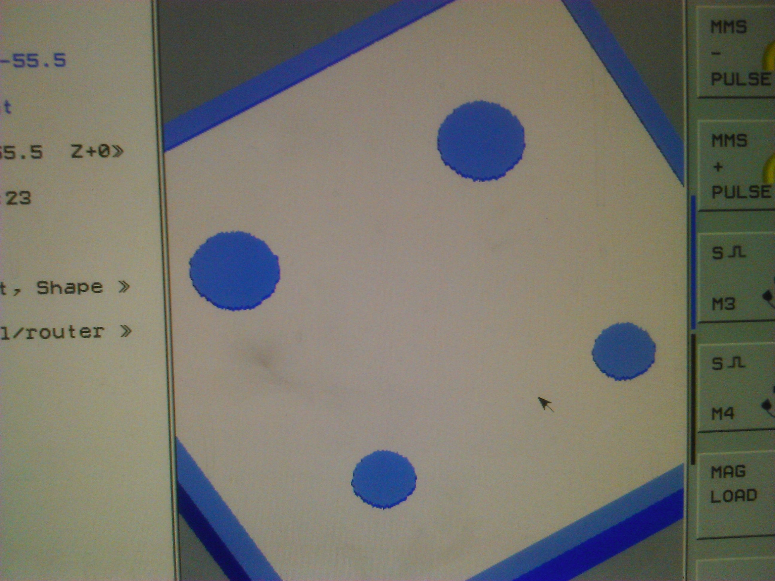

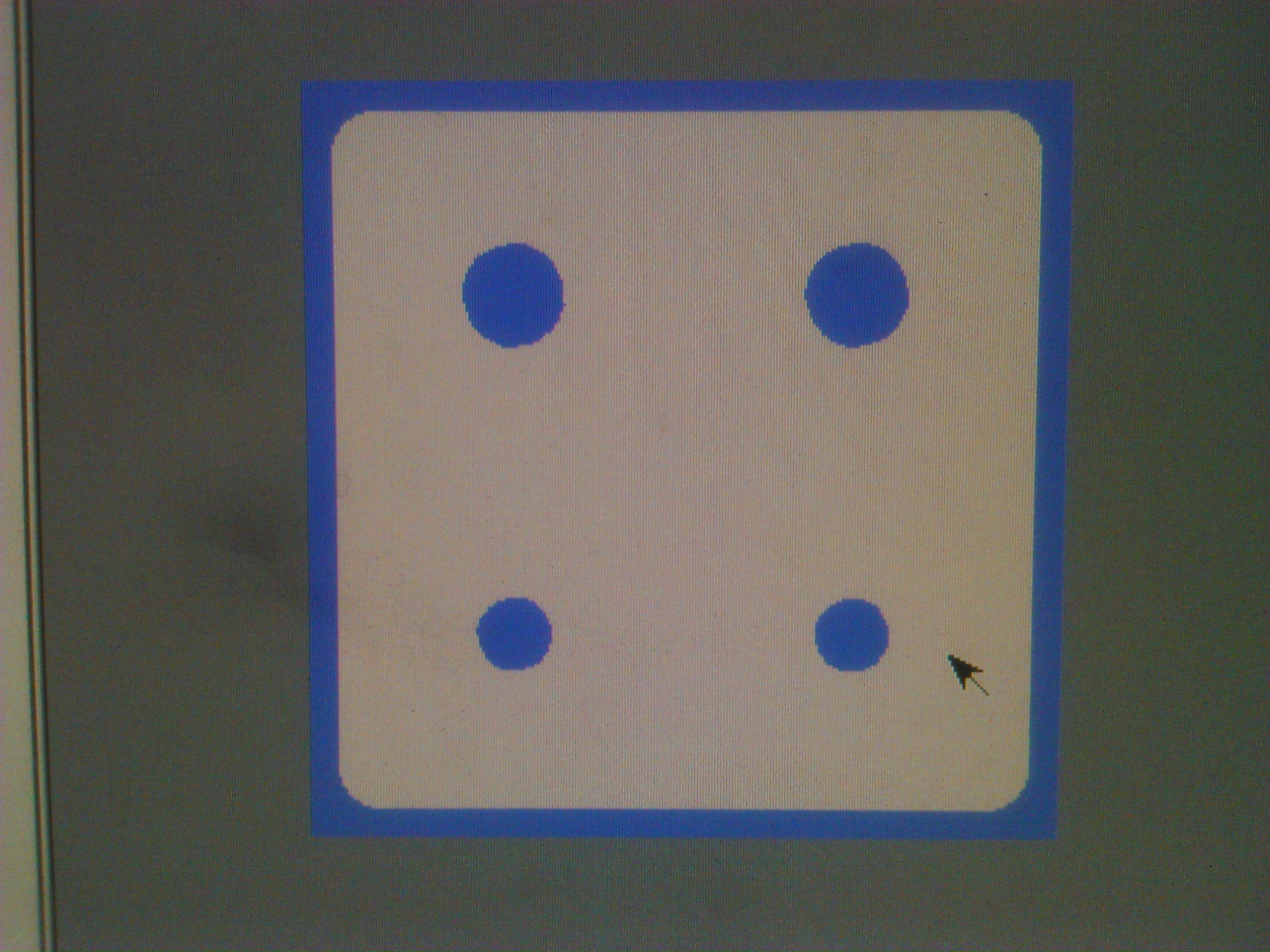

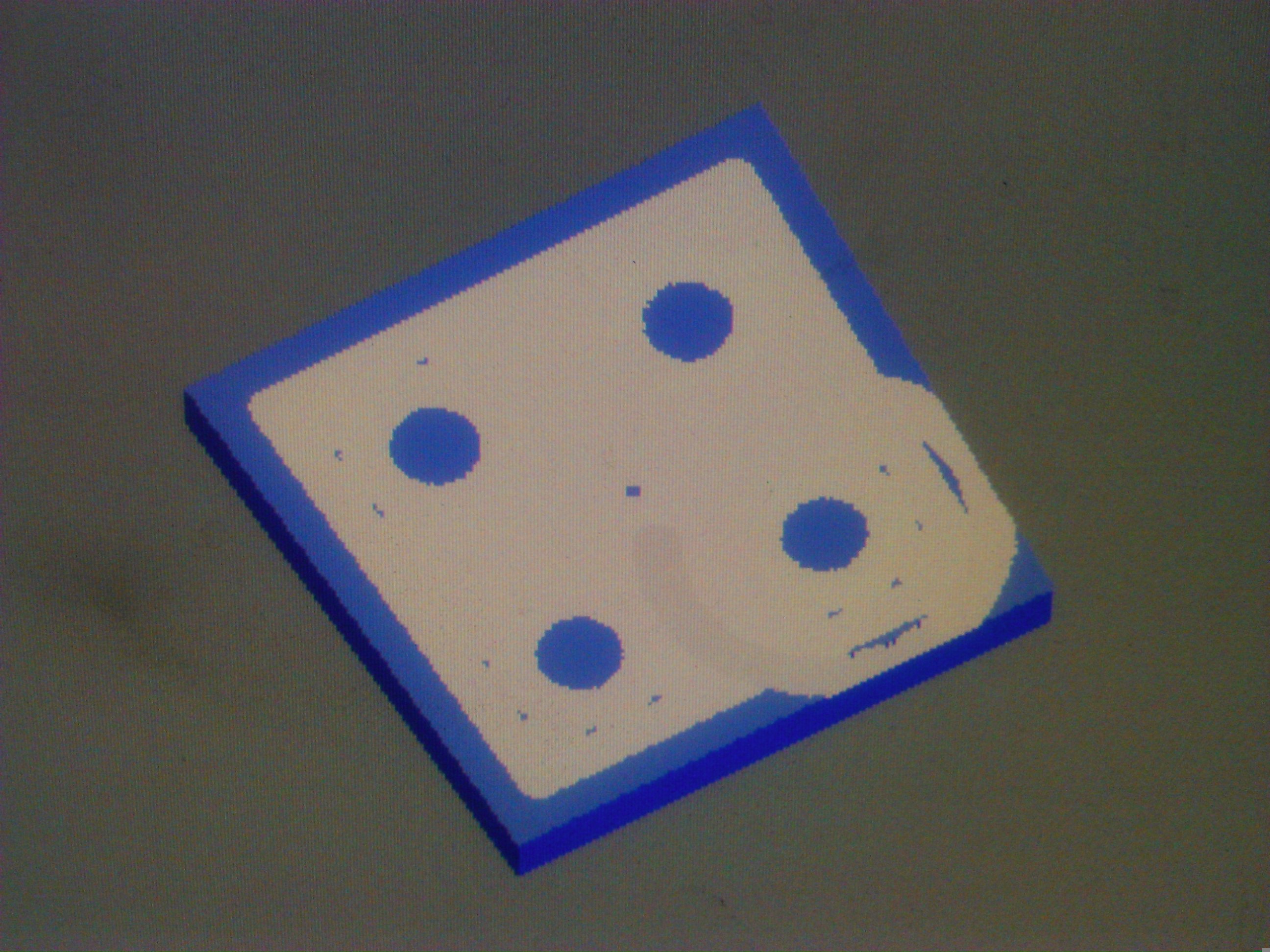

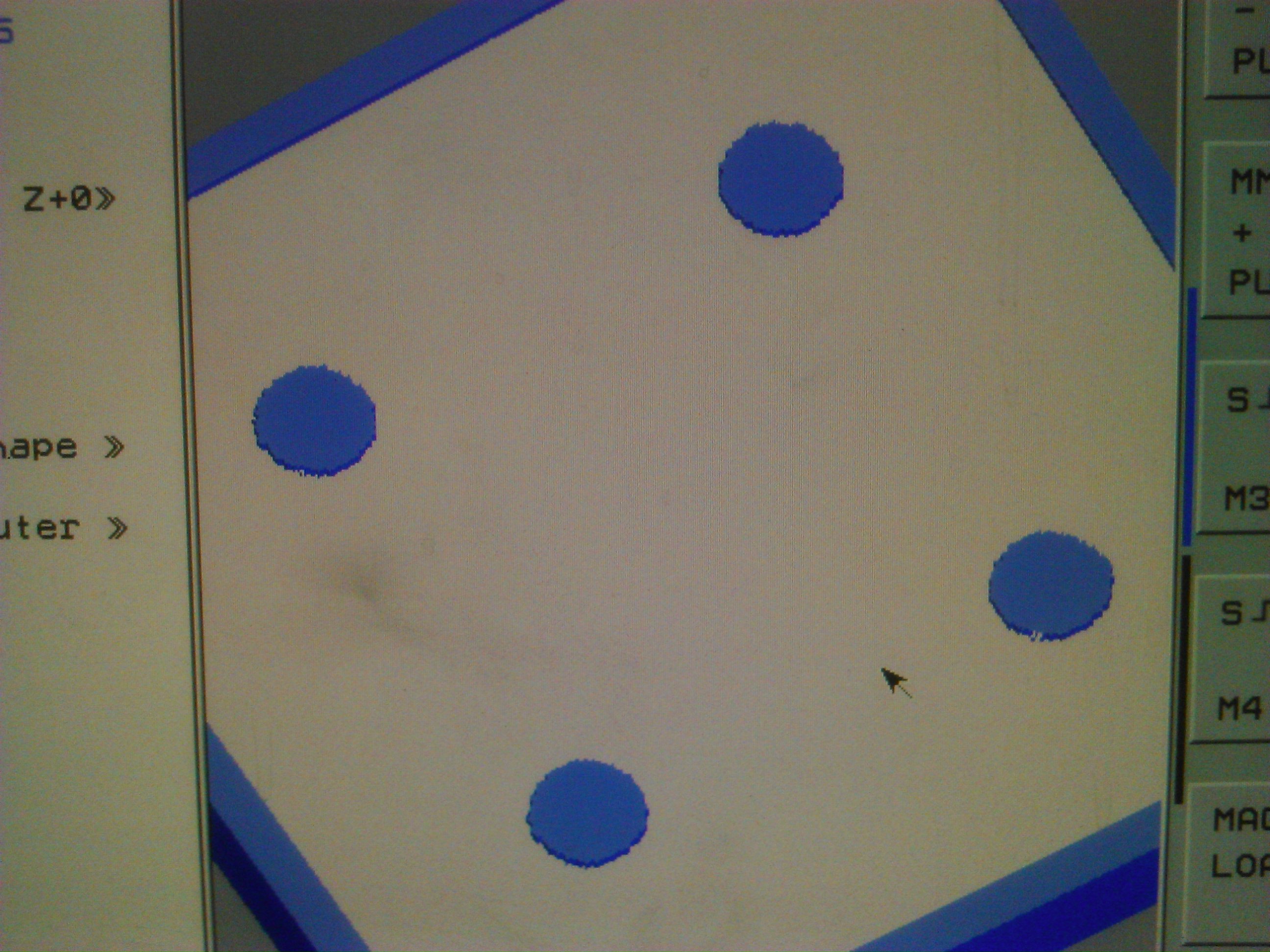

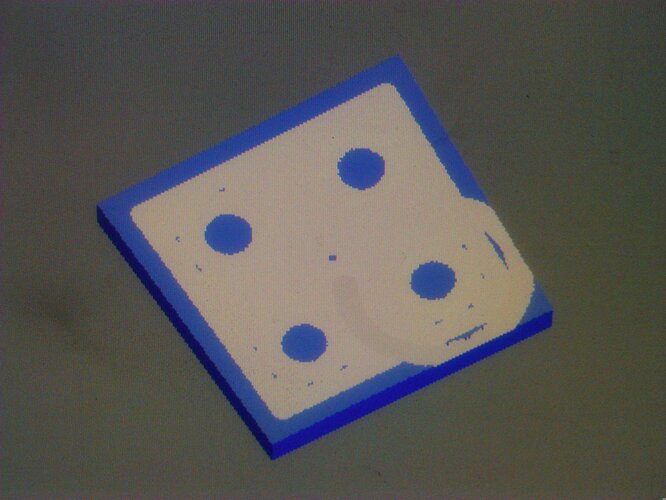

Next problem is when i change Ramp Angle. Look at the pictures.
When put 3,4,6,8,9 angle machine leaves material.
When put 2,5,7 angle is ok.
Untitled.job (6.93 KB)
Is it leaving material on both passes or just the last one?
Last one.
It is strange because when i change tool to 8mm then ramp to 4 next to 5 degree. Path is ok.
I can’t see anything obviously wrong but give this version a try. It only uses ‘CP’ type arcs.
Heidenhain TNC410 conversational test.scpost (7.47 KB)

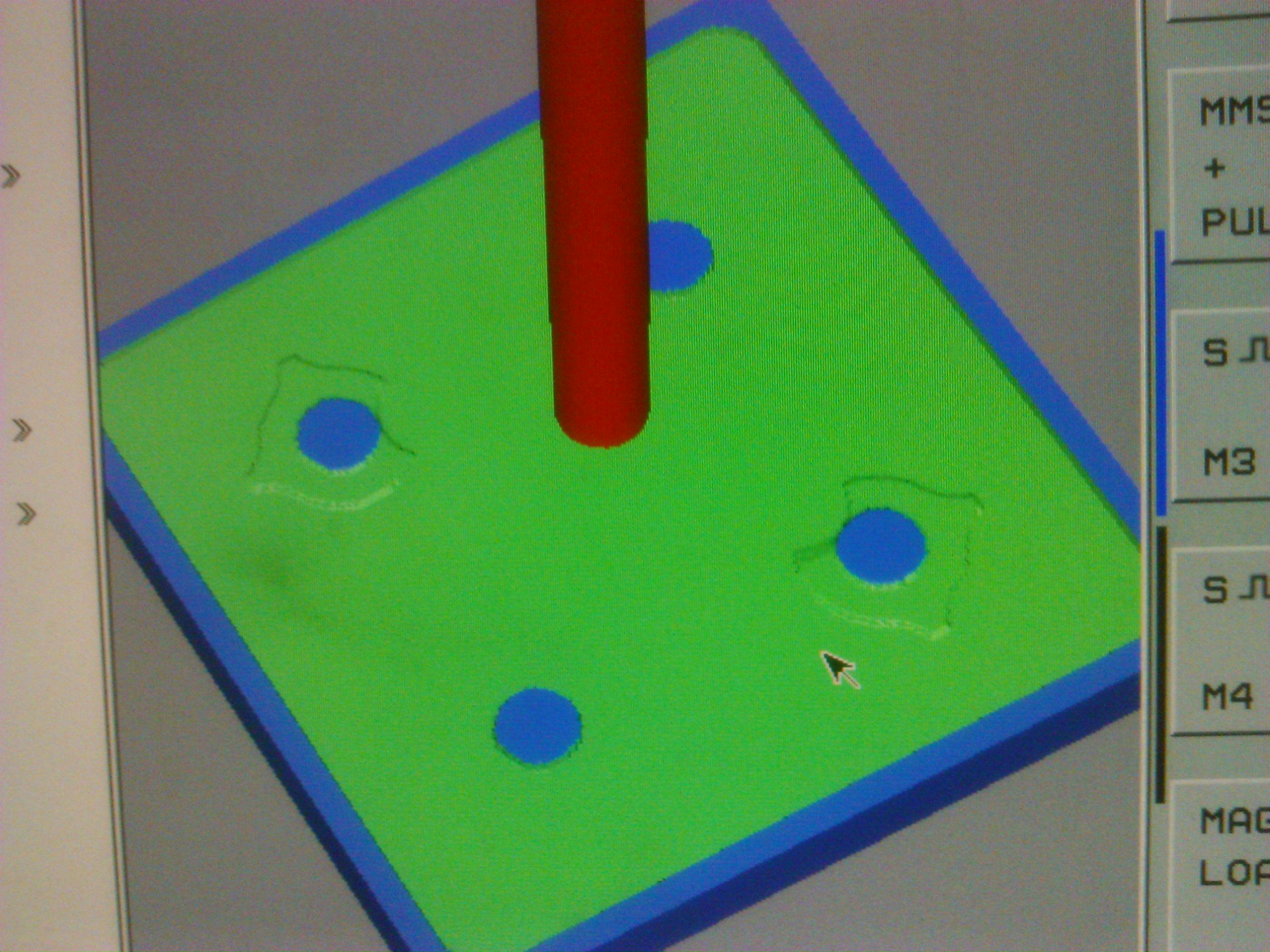

nice path but circle diameters are diferent. All level done.
I’m not sure what is going on here. Does changing the ramp angle have any effect?
The angle Doesn’t mater. All circle is diferent.
Size of this circlres depends from step over percent, when change the size is change as well.
Previous post was ok but, why on 2,5,7 ramp angle path is ok.
on 3,4,6,8,9 angle was problem with path.

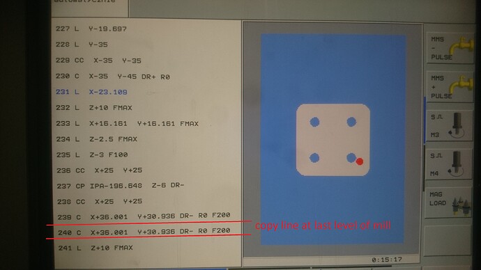

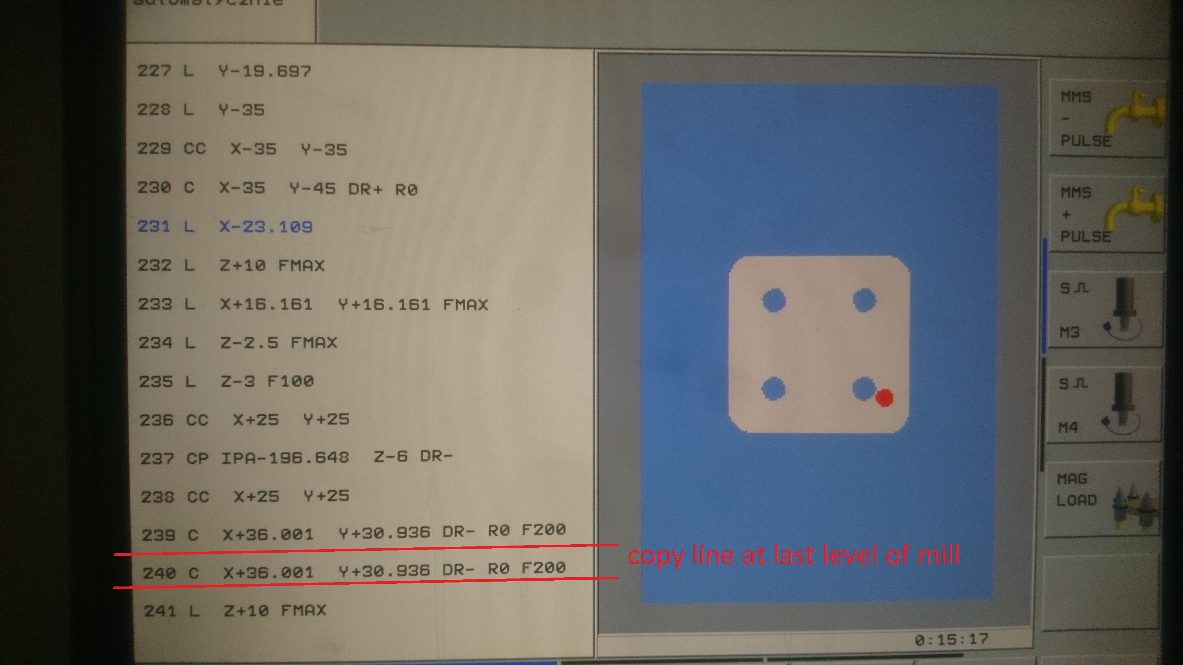

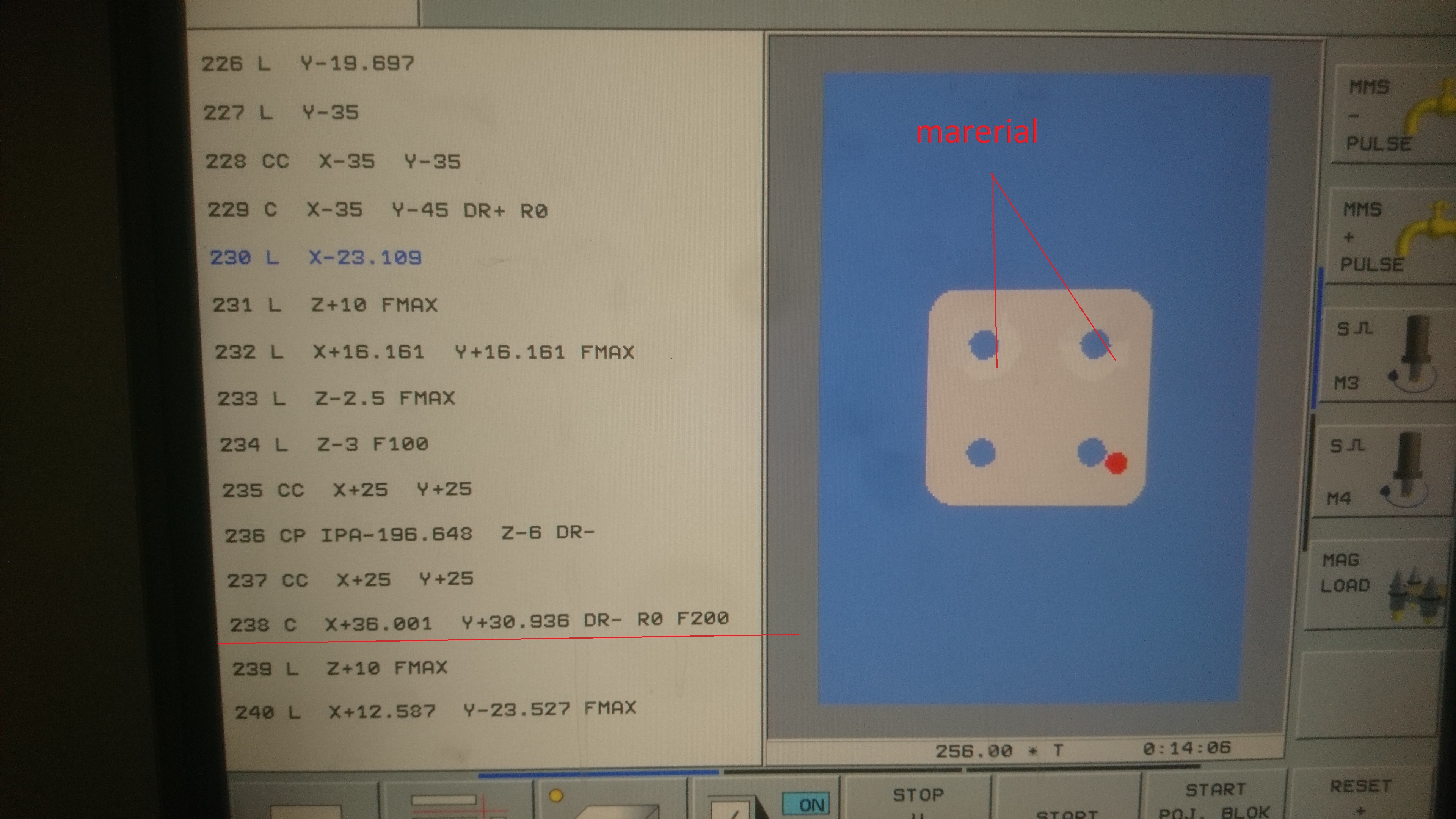

One year ago we tried to fix the Heidenhain Post Processor TNC 410. Now i found the way.
Last circle on ( endZ ) has to be repeated do take rest of material.
Please look on pictures.
Coul You add some lines to post?
Untitled.job (7.01 KB)
I’m not sure exactly what you mean. Which circle needs to be duplicated?
Thanks for reply.
Place where I mark red lines is diferent color, material to take out.
