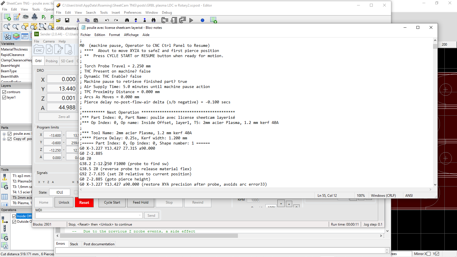

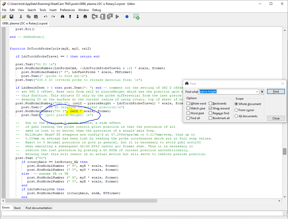

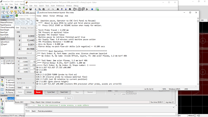

I have a weird issue, And I think it is related with the post processor
I just bought this morning the general SheetCAM license and its rotary plasma plugin. I designed a piece and prepared its cut, but the Gcode was irrelevant at least with Probe Cycle. I had the line
G92 Z-7.635 (set Z0 relative to current position) ;
instead of 2.25 as I set for my floating torch mount travel. And then the torch goes down again !
G0 Z-2.885 (goto pierce height)
Even though my pierce height is set as 2.5mm.
(Then I noticed the holes I wanted to make are cut a little bit more than twice each ; could it be from a vectorial double drawing mistake ??)
The last days I had only the evaluation license, no plugin, but cutting each face separately was fine. I just had handwritten “G0 Z up” then “G0 A something” for each face, and was OK. The only other change I remember was to have rotary axis set as parallel to Y instead of X, (thanks for having addressed this issue too, bLou) Of course this change is not related
Capture postprocessor settings
It is frustrating as I was expecting at last to have a tool to cut tube edges too. Hopefully you have an idea of what may cause that, thanks in advance for any clue

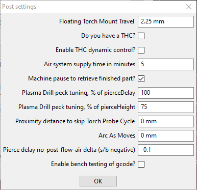

I just mad another test, with a round pipe. I have no issue with Z height in that case, the probe offset is correct and the pierce height is fine too. However a very strange inconsistency occurs. In my PP settings, my proximity distance to skip torch probe cycle is set to 0. But the second cut of this job skips the Torch Probe Cycle. And then, the other cuts of the job have the TPC implemented. It is only this 2nd cut which has its TPC skipped.
This gcode is here
[test on round tube.job|attachment]
The job is this one (upload://3kAl4a7LGjx9CfVMz6cD3tB36of.job) (9.5 KB)

OK, I just read again the gcode and it looks like I just did not understand your scope. I expected Z to be zeroed for each face of the tube. I had not expected that you would keep a single Z reference even through various probes cycles on each face. Something went wrong on my test, and at first glance I saw these weird negative Z values and thought it was the cause of my issue, but I was probably wrong in my interpretation. I hope you have not lost time yet with my alert since it may be false. I have to take more time to see what went wrong with my job (the TPC skip inconsistency remains valid though)
@Tristan86 - Correct, Z is zeroed by operator once before the job. Also- Use of my pp requires Z to be zeroed on the cylinder (or virtual cylinder) surface, unlike other sheetcam pps where Z is zeroed at rotary center of rotation. For rectangular tubing and I-Beam, the virtual cylinder is the diagonal, thus Z should be zeroed on the apex of any corner. I tried to ensure good comments in the gcode to advise of this, let me know if comments could be improved.
So when cutting rectangle tubing and I-beams, Z will show negative values on controller DROs usually while cutting, since it is rarely at zero.
re. proximity distance of 0 causing second torch touchoff probe cycle to be skipped- that was bug in my pp when cutting rotary. Its fixed in the attached pp version. Thanks for reporting the bug.

It looks like you confirm the way I would be taking, just one first probe for tubes. I guess just putting a big figure to the PP setting “proximity distance to keep Torch Probe Cycle” will avoid unnecessary issues, and have the cut be quicker.
