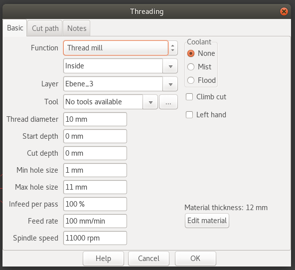

Can you manage it that there are two different fields for ‘thread mill’? Because in german there are two different words.
I can but the problem is that it would break all of the other translations. Is it possible for you to work around it?
Hmm yes then we have to edit all other translations. I think that’s not worth it.
Ok then the tool would have the name of the operation. The user would understand that though.

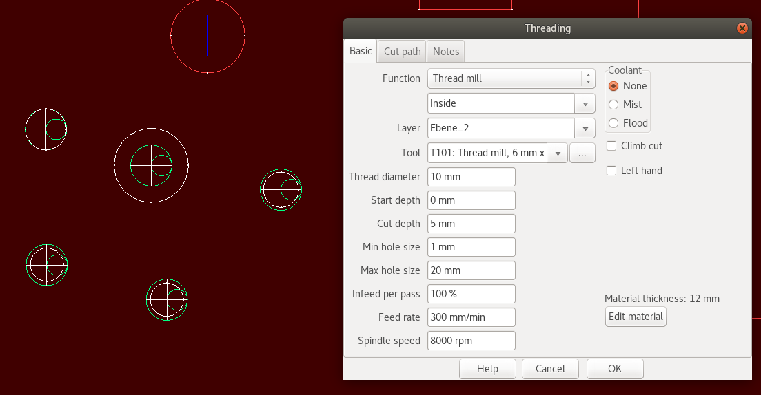

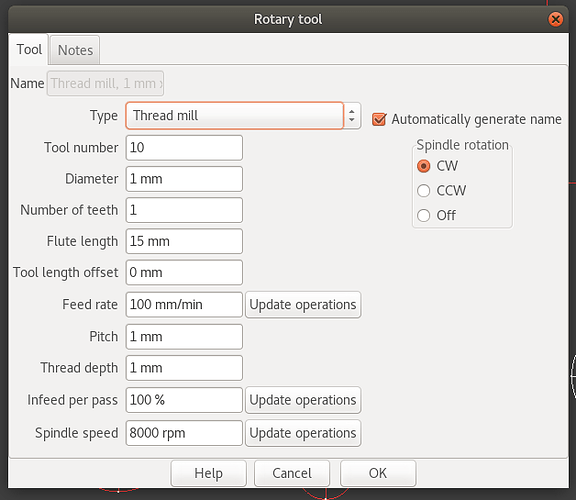

In the dialog ‘New thread mill’ the parameter ‘Thread depth’ - is this the maximum depth that the mill is able to mill?
(This parameter is not described in the manual)
And something about thread milling I wondered.
Why is the thread diameter determined by the tool and not by the drawing hole size?
I think thread milling is comparable to pocket operation where pocket size is determined by the drawing. The thread mill is capable of milling different thread sizes, so if I want to do that I have to define multiple tools for the same tool…

It is the distance from the peak of the thread to the root of the thread. See https://slideplayer.com/slide/15209113/
The circle is the drill size. The outside diameter of the thread would be the hole size plus twice the thread depth.
The diameter in the tool definition is the diameter of the thread mill, not the diameter of the finished thread. This must be less than the drill size.

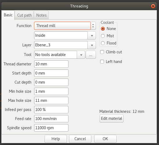

Is this the value called 17/24H resp. 5/8H or H ?
Maybe you could add an image like for the other values.
That what I expected. But actually it looks like this (all the same operation):
With the “Rotary pipe cutting” plugin?
