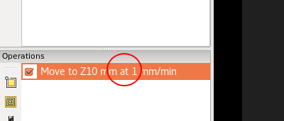

Can you say weather this single ‘an’ appears on another positions in your code, or can I make the translation suitable only for this?
it’s 17/24H or 5/8H depending on the thread type.
Maybe you could add an image like for the other values.
Yes. I need to add that image.
That what I expected. But actually it looks like this (all the same operation):
Sorry, my mistake. It’s a while since I last looked at threading.
With the “Rotary pipe cutting” plugin?
Yes.
Can you say weather this single ‘at’ appears on another positions in your code, or can I make the translation suitable only for this?
It only appears in the move operation. The way it builds up the position string is a bit ugly but I can’t think of a better way.

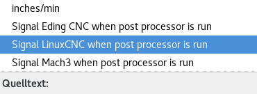

While reviewing I came across this field:
What is this about? It looks like a nice feature that I don’t know…
You define the thread size in the threading operation, not the tool.
I’m not sure where your translation got those from. They were part of a feature I was developing a long while back but they are no longer used.
The Mach3 plugin does this automatically. I am working on a way to add functionality similar to the Mach3 plugin for LinuxCNC, EdingCNC etc but it’s a fairly low priority at the moment.

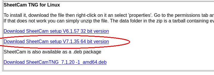

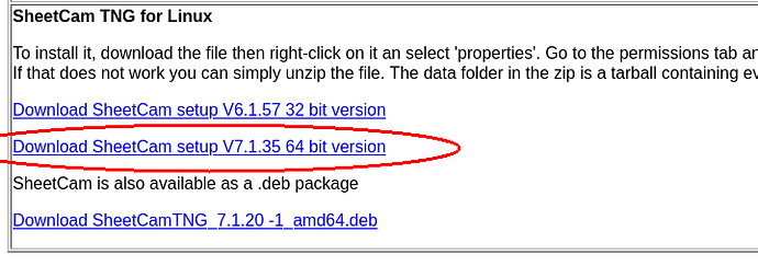

I was a bit disappointed when I tried the current version (7.1.35) and didn’t find my translations integrated. What went wrong here?
Latest translation files
sheetcam-german-translation.zip (62.8 KB)
Thank you. I will add the translation to the next release. Was this translation for the stable release or the development release?
The Linux dev version V7.1.35 64 bit that is available for download on the Website.
The Linux release tends to lag behind the Windows releases so 7.1.35 isn’t available. I need to do an update soon.
Hmm the downloads section says so…
