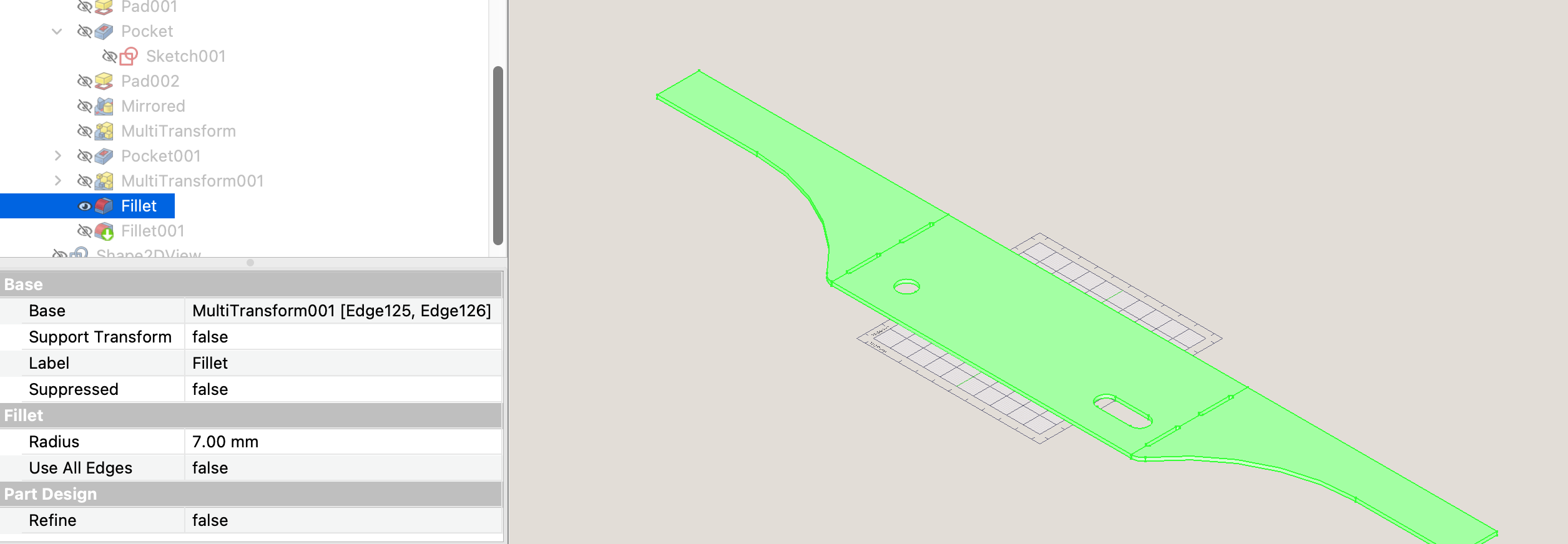

When I create a part in freecad and load into sheet cam I get multiple errors overlapping outlines duplicates removed and then another about outside offset paths not generated correctly . When I test run it goes back and forth over same lines changing directions. I have tried the part file as dxf and svg with similar results. I know I’m missing something maybe someone can help ?
based on your description, it seems you have multiple shapes/contours stacked on top of each other, perhaps even in the same layer.
I agree but this problem has just started after I purchased the sheet cam license and did an update. Is there a way to see layers in sheet cam or remove them?
I had the same problem when creating drawings with Freecad.
If you use a sketch only you can export it directly.

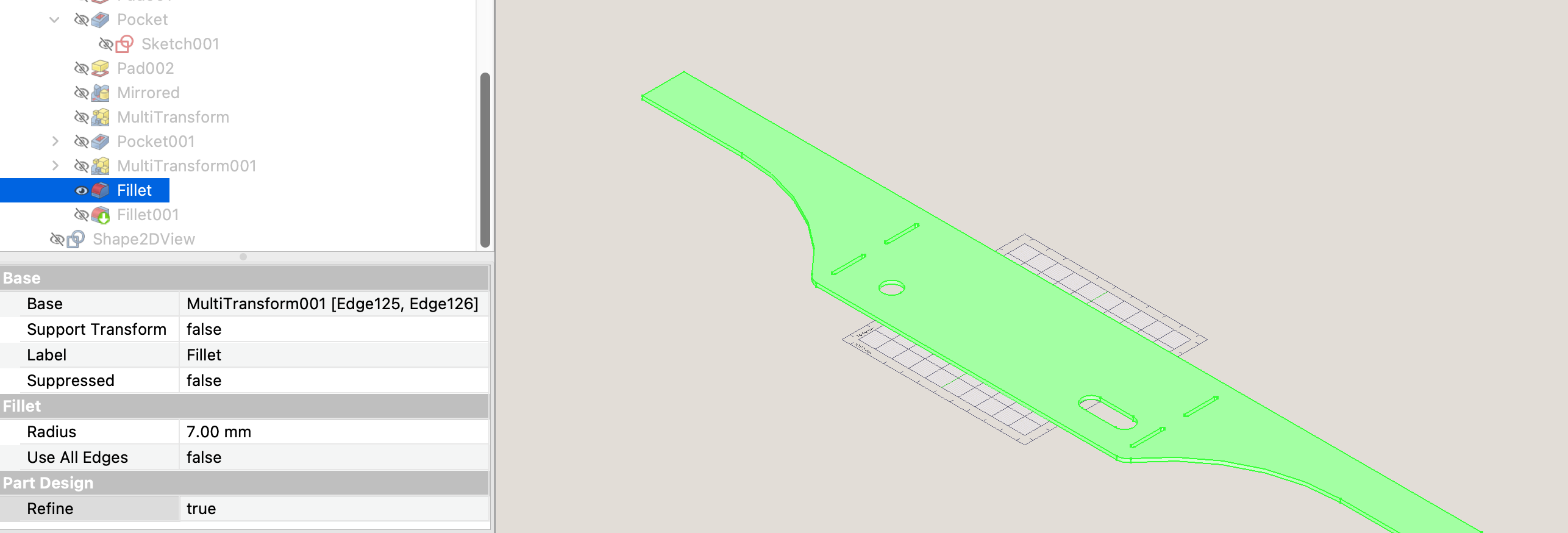

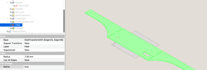

If you have a 3D drawing there are two extra steps. Klick the last item in your task list and change refine true. This will get rid of extra lines if you added pads to you drawing.
Last go to the draft workbench select the surface you want. Choose the view you want. Normally that would be the top view. Then press Shape 2d view. This will create a 2d drawing. Go to the task list and export the 2d view.
For me this gets rid of all the extra lines without fail.
Hope this will help.
With Refine true extra lines disappear.
Last Create a 2D view so Freecad knows which lines need to be exported.
Sorry no picture i reached the limit of replies and fotos.
This was so simple. Thank you for the help.
