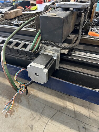

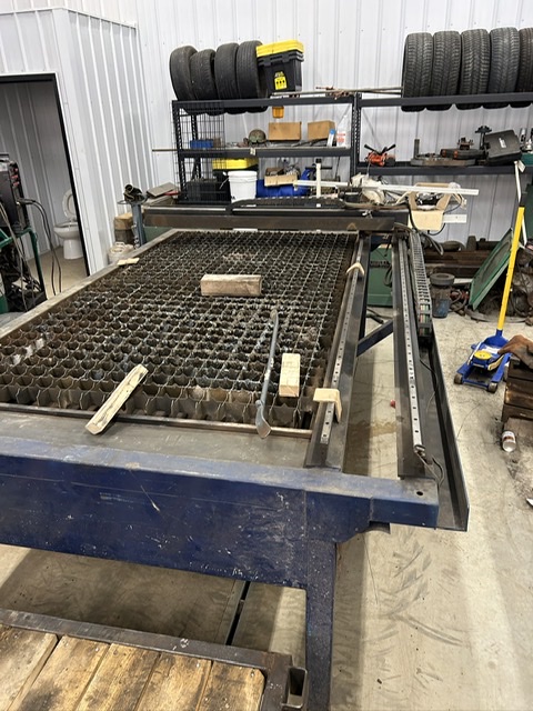

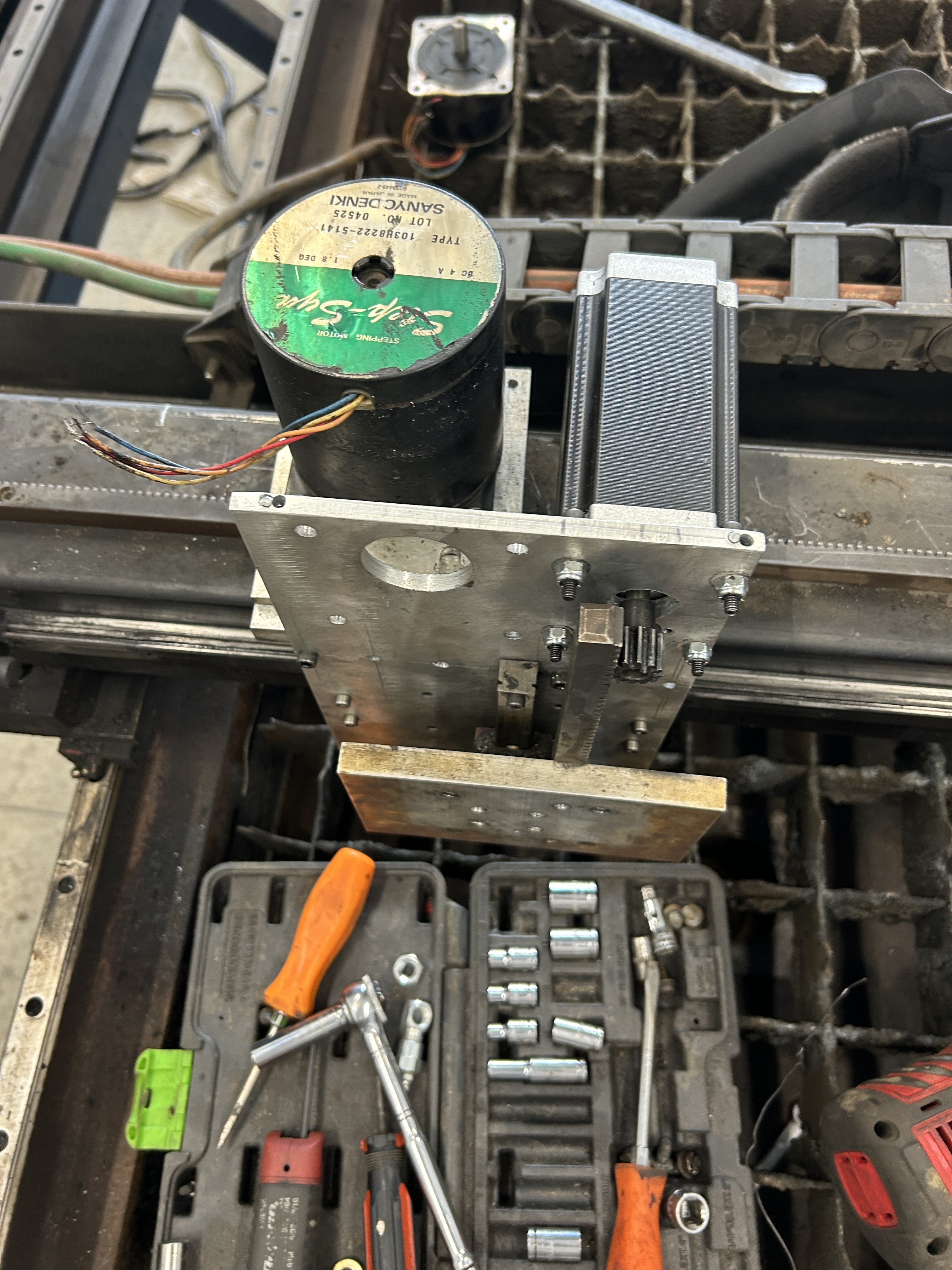

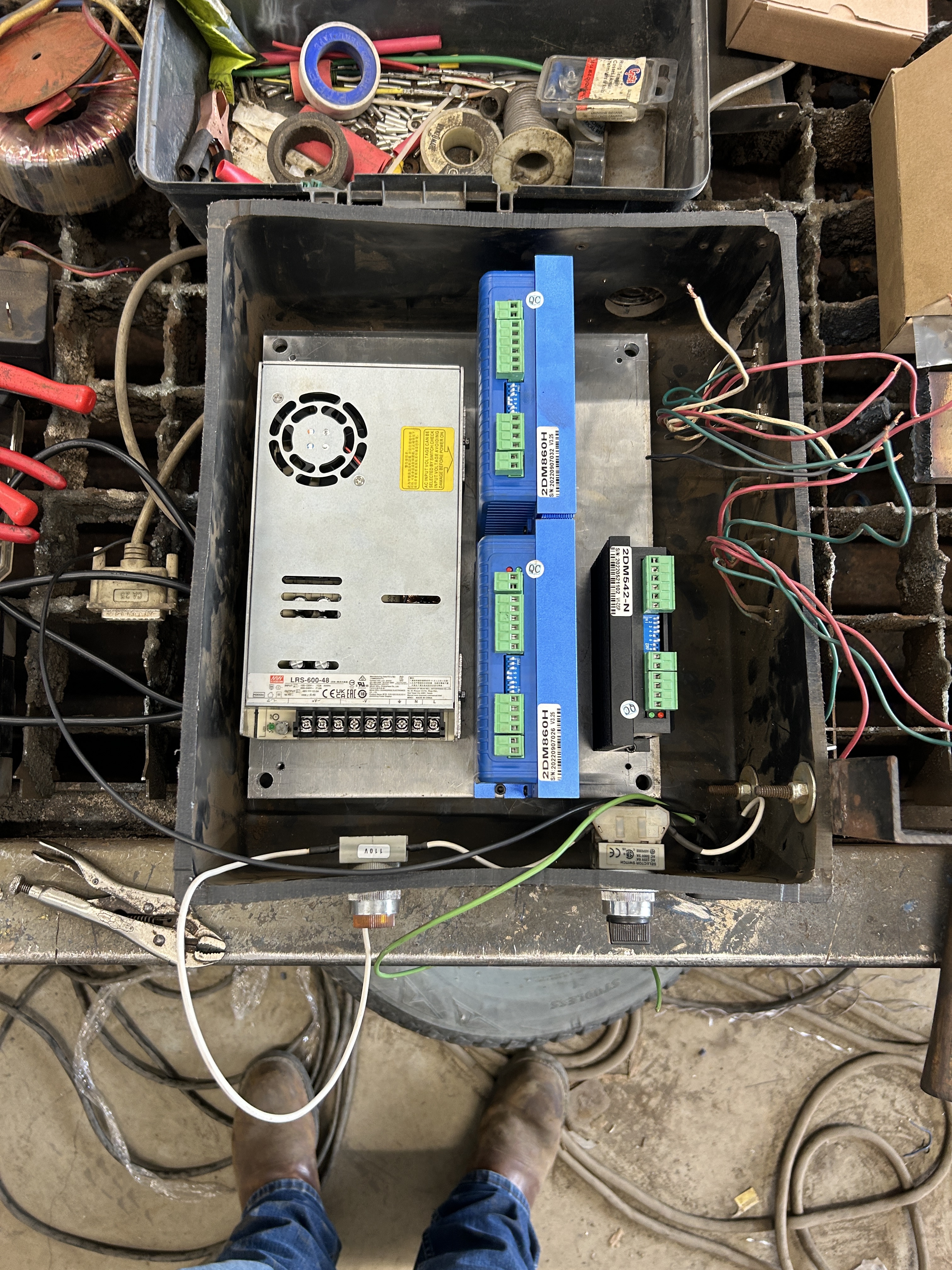

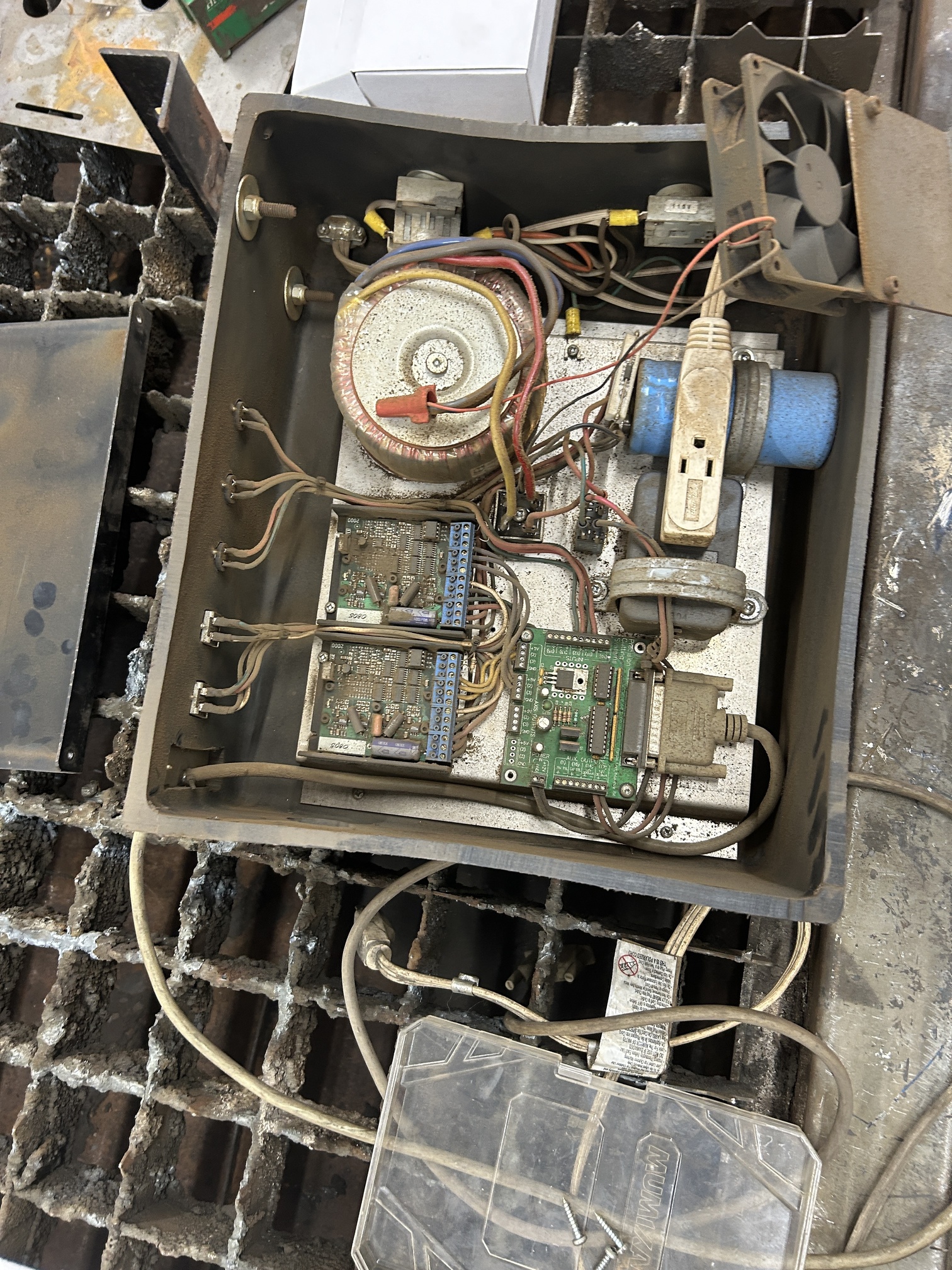

I just bought a 20 year old table that was electronically fried. The plan is to replace everything inc. the motors with current tech. I want to add a plate marker and rotary axis. My experience is very limited at best. If I am understanding correctly sheet cam will work as my controller through my computer,

CNC controllers are technically hardware devices, that is the electronics necessary to drive motors, relays, and monitor limit switches. Some controllers have microprocessors/ mirco-controllers (MCU) builtin to interpret gcode, thus they have firmware running on the MCU (grbl, grblHAL, and proprietary units like Langmuir FireControl). Some controllers have an MCU simply to control the motor and switch I/O but not interpret gcode, rather they use a connected computer which runs software to interpret gcode (LinuxCNC, Mach3/4, WinCNC). But even in the case of MCU which interpret gcode (grbl, etc), a connected computer is necessary to stream the gcode to the controller (such as OpenBuilds Sender, UGS, or IOSender).
