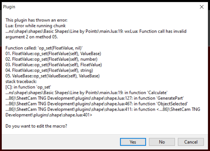

Hey Les, So far, I have not been able to make that line of code do anything. the shape normalizing code must be overriding it or something.
It is moving the shape but it doesn’t update the displayed coordinates. Try this instead:
   tempObj:SetPosition2D(sc.Coord2D(x,y))
   posX.value:op_set(x)
   posY.value:op_set(y)
   posX.editor:GetValidator():TransferToWindow()
   posY.editor:GetValidator():TransferToWindow()

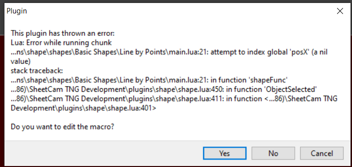

That didn’t exactly work either Les… Here’s the error if it is inside the function block, which i think is wrong placement:
And here’s if its placed after the function end:
and heres the code:
It needs to be inside the function. x and y need to be set to the x and y coordinates of the centroid of the shape.
Heck yea, that fixed it! Thanks! Works exactly as I intended now. Or seems to at the moment anyways. I really wish I had the time to learn how to code better… seems like I know just enough to be dangerous and annoying lol
