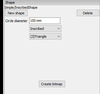

Interesting question / bug?
AddChoiceControl(“inOutShape”, “Shape Location”, {“Inscribed”,“Circumscribed”}, “”)
It appears that the “text / name” for the control does not appear on screen to the left of the dropdown menu {which is what does occur for “AddNumControl()” functions}
