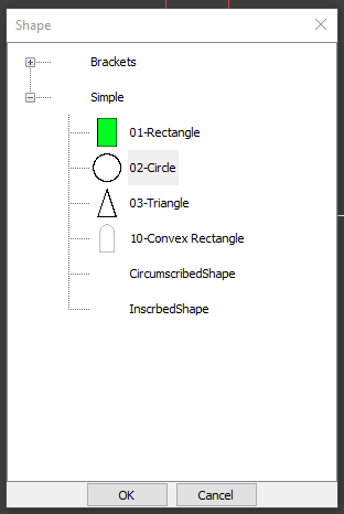

Les the shape dialog, is there a way I can make it bigger, I’ve had a look at the xrc files (in notepad++), but I didn’t see a form size setting (or it wasn’t apparent to me)
do you think there may be a way to change this list to a form with PNG images that are clickable?
it may be a bit more of a user friendly GUI (in my opinion)… do I need to look at wxWidgets?
I have attached an update that has a bigger dialog and you can resize it. If your shape directory contains a file called ‘icon.png’ it will be used as an icon for that shape. Put the contents of the zip file in your shape plugin directory.
update.zip (2.23 KB)
Bit of a suggestion :slight_smile: {some people are never happy… haha}
When you first select the shape and it appears on the screen, it may be useful (for asthetics … no other reason) for the shape (icon.png) to appear in the location where the dimensions shapes appear. Given its already within the file there is no object creation overhead to doing this in my opinion… but it makes it look nice and finishes it off as a selection confirmation.
That shouldn’t be a problem. I’ll take a look on Monday.
