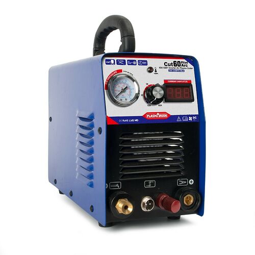

The plasma cutter is a Chinese CUT50 with pilot arc, no information came with the machine, no settings or recommendations of how to use it.

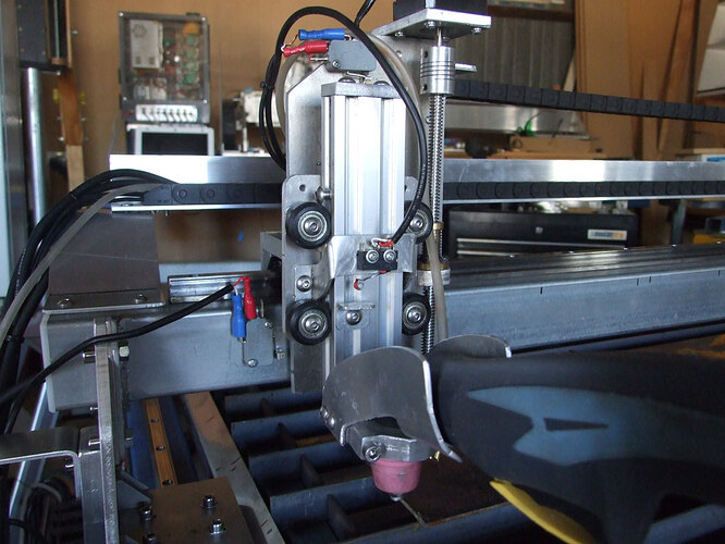

My questions are, how do I setup the floating head switch? What are some ball park cutting speeds for the plasma cutting 3mm mild steel? I have no idea what the nerf cut should be set to.

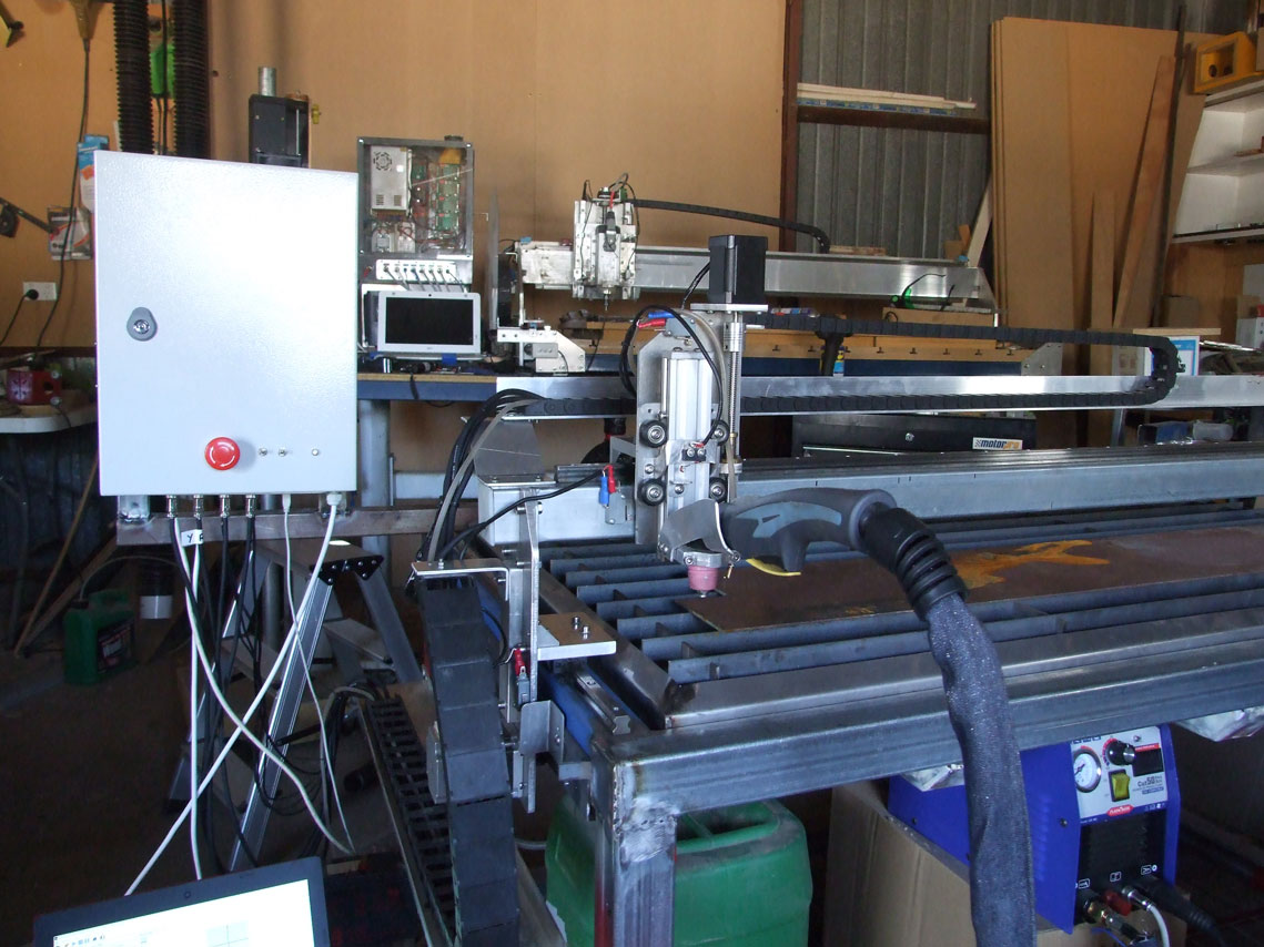

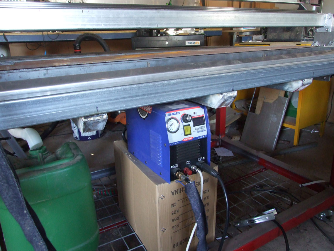

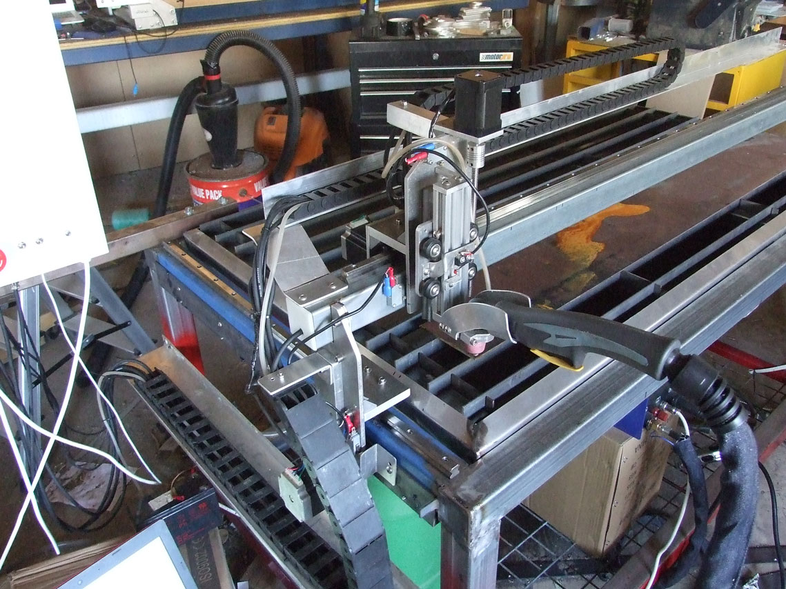

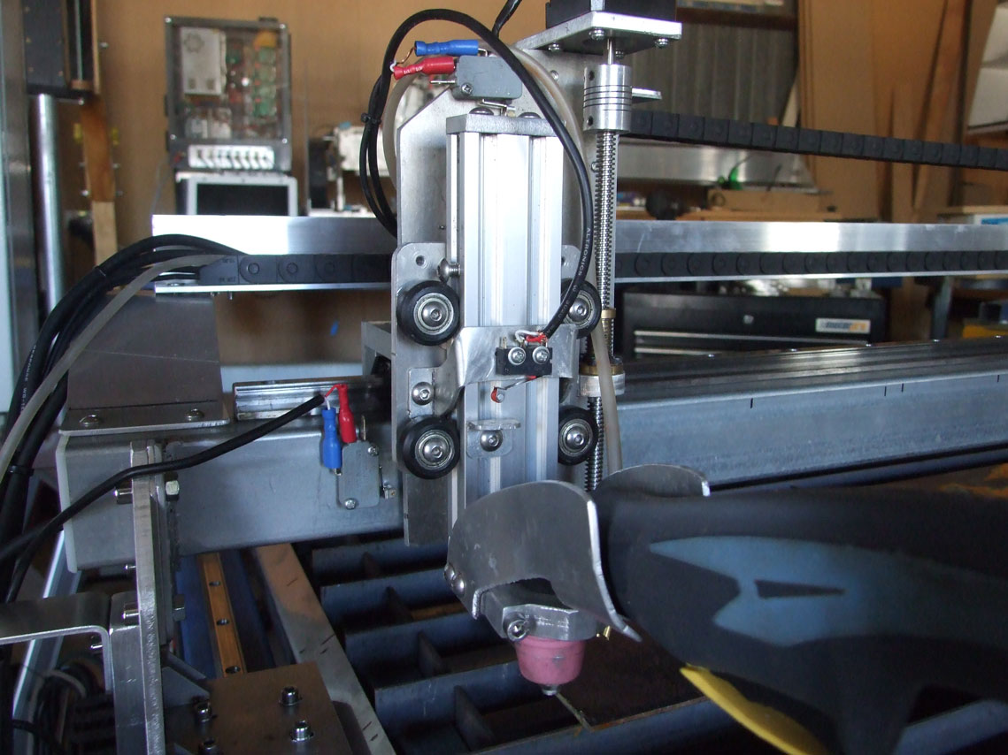

Here is a shot or two of the machine so far, it was built using the machine in the background that I designed and built earlier this last year. Both are using Arduino Nano for the controller and GRBL for the plasma and Estlcam for the mill.
Using sheetcam looks fairly simple, just need to get the right settings sorted out. Might do the first test cut tonight when the sun goes down.

Tested again with the plasma switched on and as soon as an arc started, the system shut down, so I guess I have some more shielding to do.
Will fit a line filter and some ferrite cores to the lines, all the cables are already shielded and the electronics are in a sealed metal box, everything earthed.

That machine uses HF start. You will need to pay a lot of attention to filtering and screening to get it to work as that HF will get everywhere. Make sure the only electrical connection to the table is at mains earth. Be careful to make sure none of your screens touch the frame of the machine.
Don’t attempt to measure the torch voltage with a meter. The cutting voltage should probably be around 100 - 150VDC but there is several thousand volts high frequency AC on the output when it is starting the arc. That HF is quite likely to destroy your meter. THC controllers have lots of built in filtering and protection to protect them from the HF. When you get to hooking up your THC controller you need to measure the voltage before the HF is injected. Open the machine (make sure it has been off for at least 5 minutes before you start) and look for a hefty coil near the front of the machine. It looks like a big spring made out of rectangular section copper. One end of this coil will connect to the output terminal. You want to measure from the other end. Negative can come from the ground terminal.

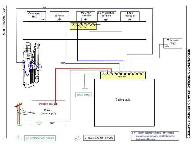

When I talked about the screens I meant that they should only be earthed at the box and not connected to the frame anywhere else.
Not sure how I can isolate the earth leads though, because the power input earth is shared with both the plasma machine and the power input for the electronics through the mains supply.
The shared mains earth should not be a problem. Basically you don’t want the earths to form a loop anywhere. If the screens touch the frame you have a loop: mains earth->control box->screen->frame->mains earth
Looking at your photo it looks like you are using connectors with metal shells on the control box. This is good - your screen should connect to the metal shell of the plug and socket should have a good electrical connection to the box (scrape off the paint around the fixing screws to be sure).

I downloaded a paper from the net by Hypertherm that talks about this problem and will try to follow what is suggested and keep in mind what you have said also.

Full article
805400r0.pdf (237 KB)
Well I don’t know what to try next.
I have fitted all the earthing as described in the above diagram. Fitted shielded cables everywhere and only attached the shield at the control box end, other end free and not touching the earthed frame. I have fitted several ferrite suppressors and also fitted a EMI filter on the mains coming in to the control box.
