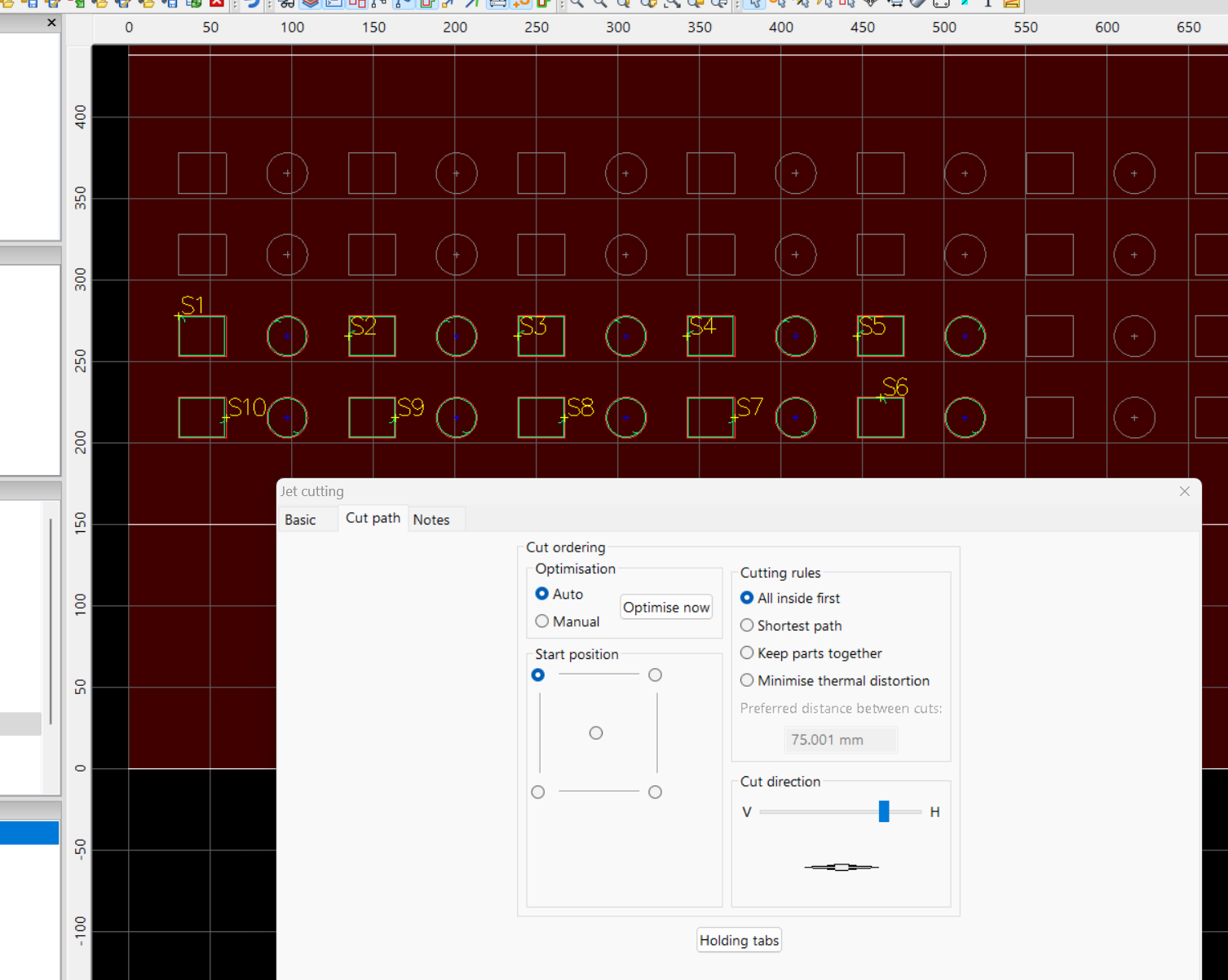

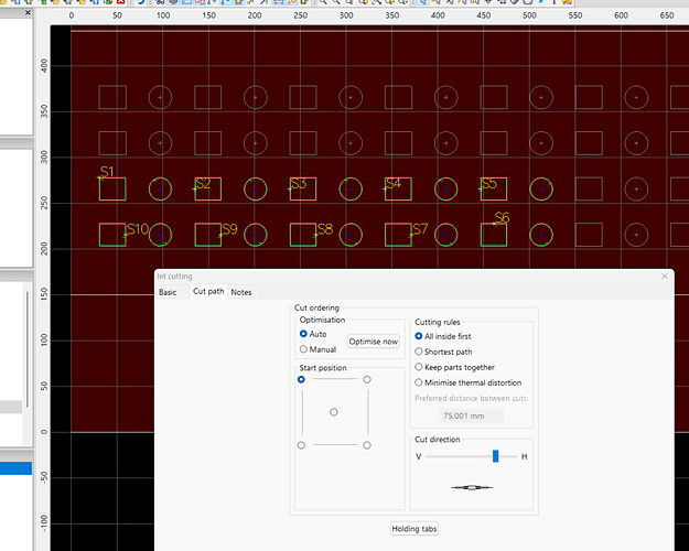

Sheetcam has several automatic cut order optimization features available. Let’s start with Operations / ‘Cut path’ dialogue. There are several controls and algorithms to select and experiment with. Similar controls can be found in Options / ‘Job options’ / Nesting which act on Parts/Operation packages. And of course the third is fully manual which is what you have discovered via Mode / ‘Start points’ / ‘Quick sequence’. Note the use of the Horizontal and Vertical sliders in the first two automatic optimization settings, this gives preference to those respective directions. In concert with all of these choices is the Layer element, which groups contours for isolation to specific Operations and tool choices.

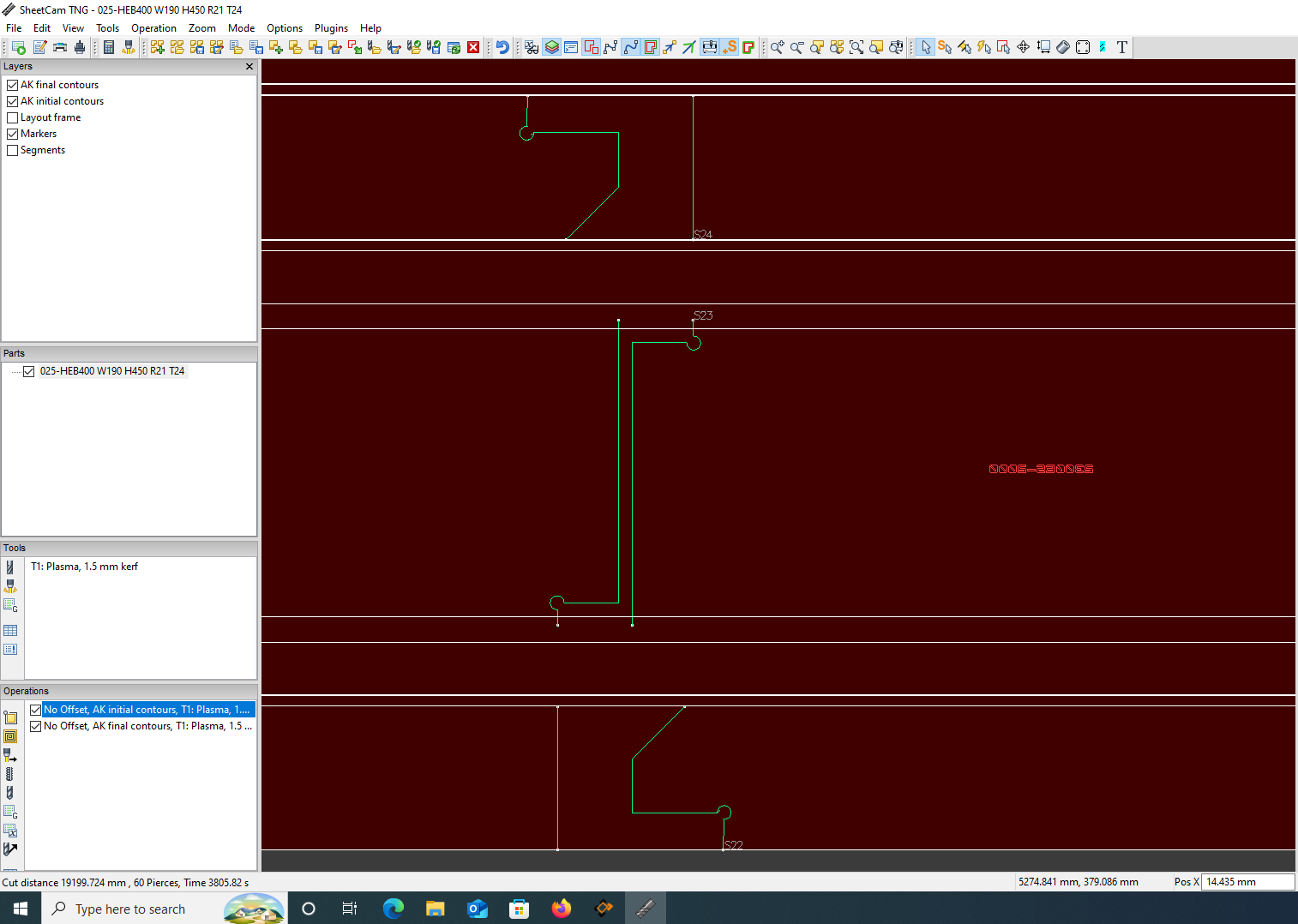

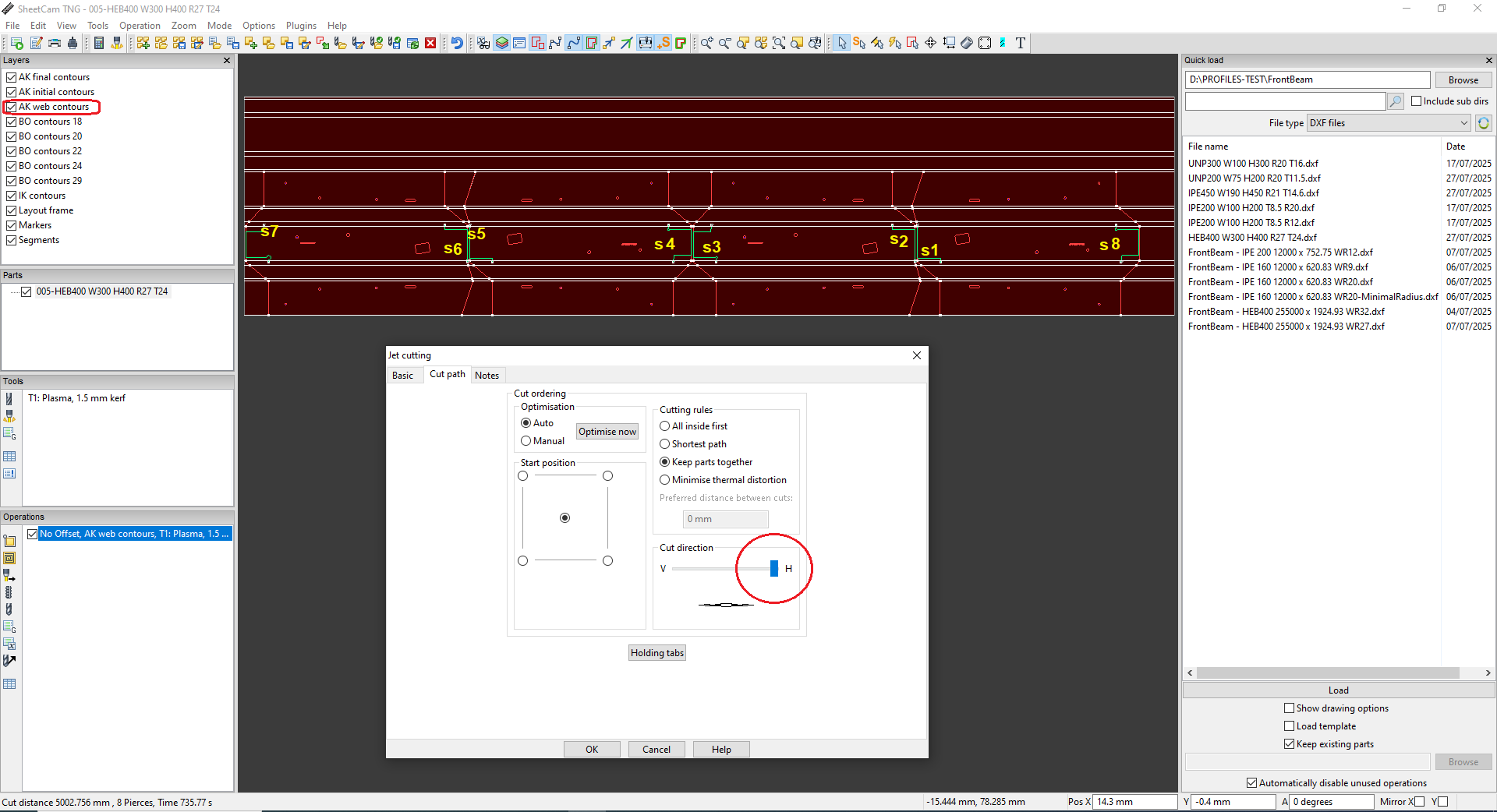

DGNest has a new layer (web contours for V-section of the I-beam). As you can see from the image I am using horizontal direction in Operations->Cut path and the same cut direction in Job options. Cut order is not as expected.
After ‘break up manually nested parts’ cut order is good S1-S2 but only on non mirrored parts, which is not good. I think cut order algorithm is not yet optimized for I-beams. Could you please send one example with 4 parts .job where you succeeded to make cut order on the web (V-section)?
Adam
p- ibeam pattern sequencing test.job (27.2 KB)
That’s it: start position top-left. Now it works well. I have had to split my web layer into two layers: web initial and web final and swap mirrored cuts (initial-final)
