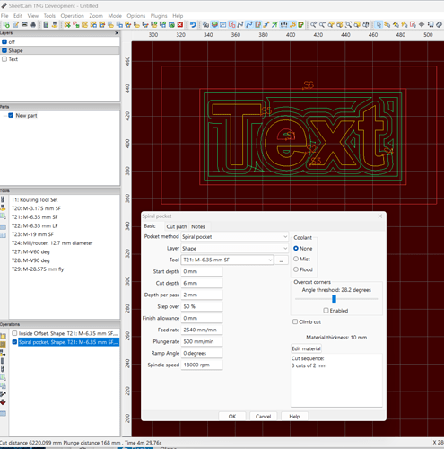

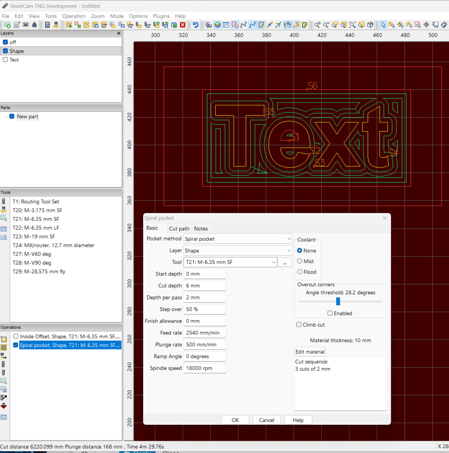

Video to tutorial
I’m not recalling if a video tutorial exists on that topic. Search youtube is best bet.
Start here- Where to learn Sheetcam - #2 by sheetcamCS2
A pocket Operation between text and a surrounding outline will give you the effect you desire, raised text.
