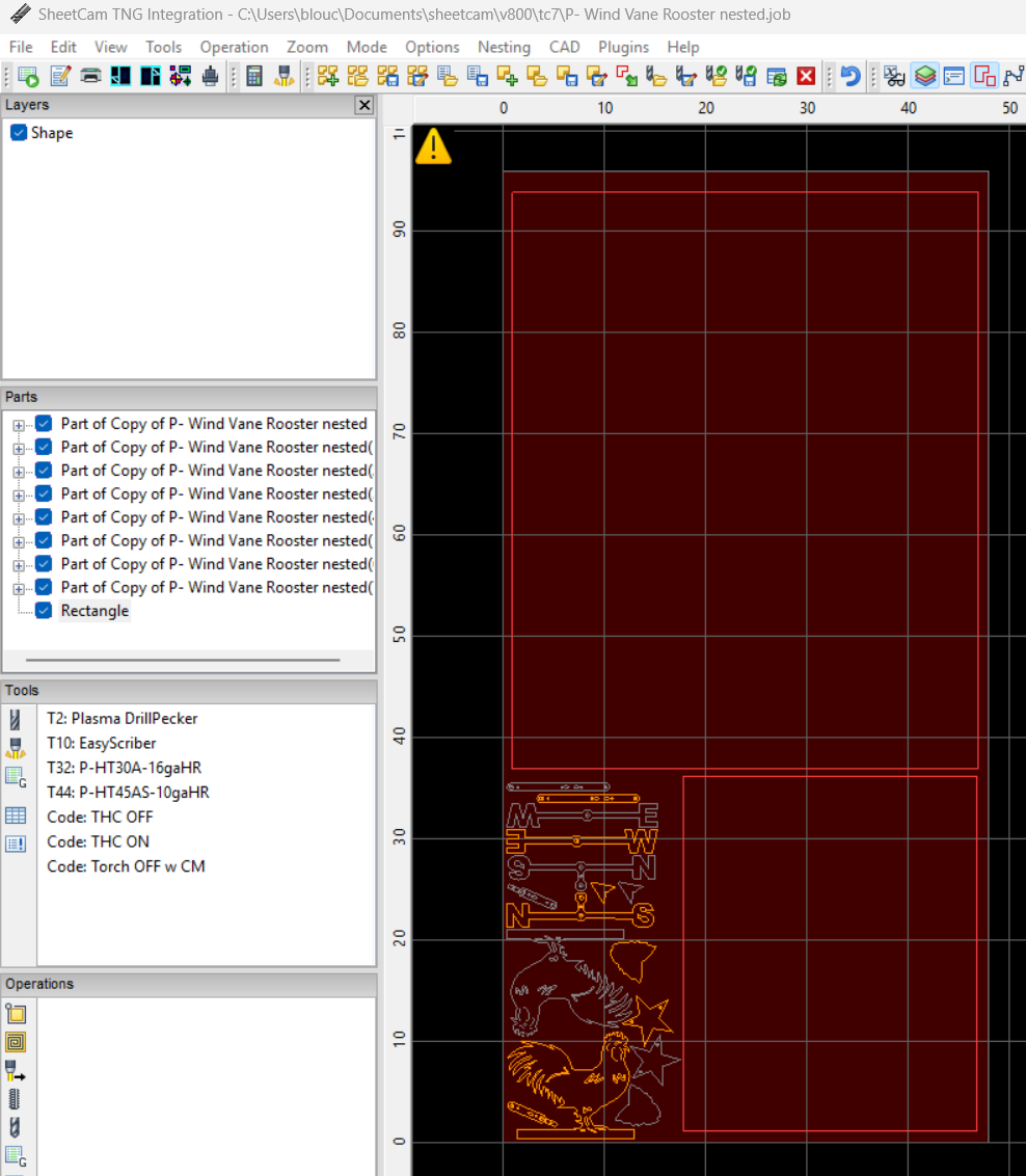

See the photo as an example. I don’t mean to imply that you can draw rectangles on a material dimension and use that as a nesting container, that would be a nice improvement to the new feature, but it’s not there at this time. So what you do now is use those drawn rectangle dimensions as a new job with those material dimensions and nest that area in a new job. What I would do at this point is cut that new job with a repositioned XY zero accordingly.

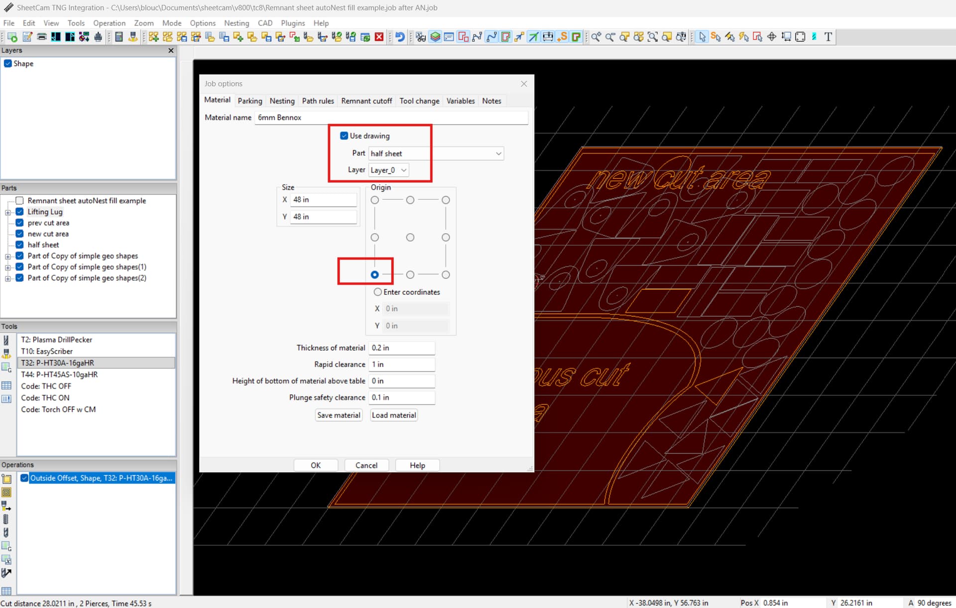

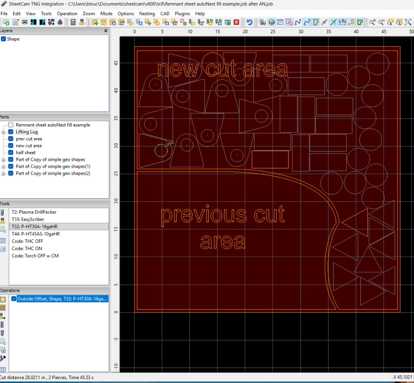

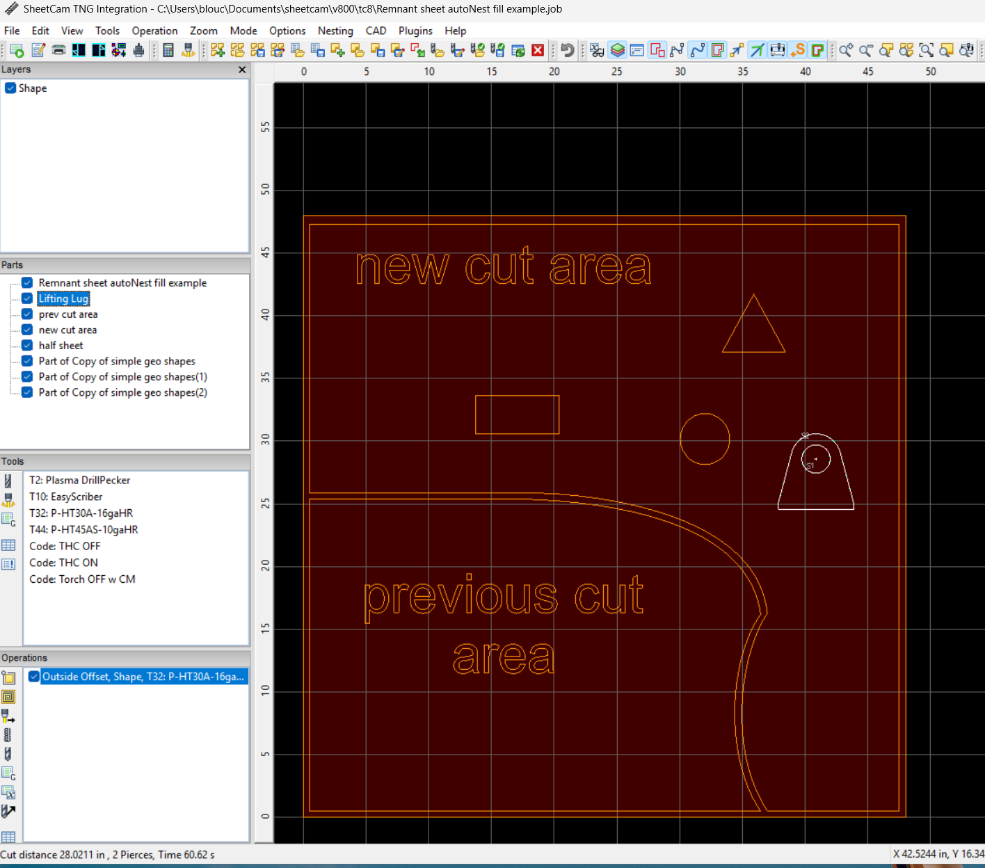

Significant correction/update on the use case of:
Adding autoNested Parts to a job referencing a remnant sheet.
The workflow is actually not as klugey as I previously described. It can be accomplished but workflow process is quite methodical and does require some practice or trial and error.
The process leverages a v7 feature in sheetcam Options / ‘Job options’ / ‘Use drawing’. This feature uses the outer most (or only) contour in the selected Part / Layer as the drawing dimensions. As you can see in the screenshot, this contour can be any irregular shape representing the ‘container’ or boundary area for autoNesting. As mentioned earlier, autoNesting uses the job material dimensions, or in this case the material contour, as the nesting container.
I began the work by using the ‘half sheet’ part/contour for dimensions. Then just before I invoked autoNesting, I changed the Options / ‘Job options’ / ‘Use drawing’ reference to ‘new cut area’ Part and contour. When autoNest finished it’s nesting arrangement in that container, it came back into the job exactly as it was positioned previously. At that time, its ok to change the job dimensions back to the ‘half sheet’ Part so toolpaths are referenced from half sheet X0Y0, if that is what the user prefers.
The rest of the workflow process I hope is self explanatory, after a little practice with it of course. I took the liberty to make a contour in my CAD which is the original half sheet and previous cut area.
Remnant sheet autoNest fill example.job (101.9 KB)
Remnant sheet autoNest fill example.job after AN.job (110.0 KB)
Remnant sheet autoNest fill example.dxf.txt (226.7 KB)

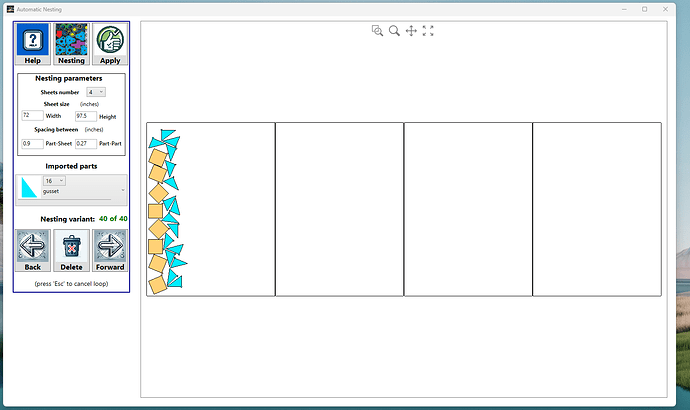

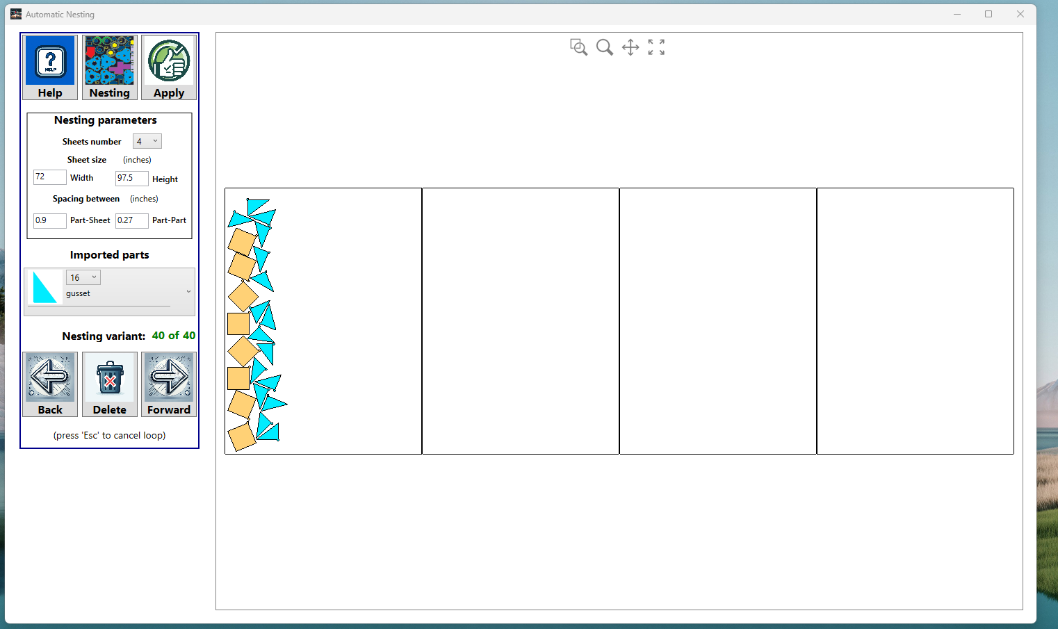

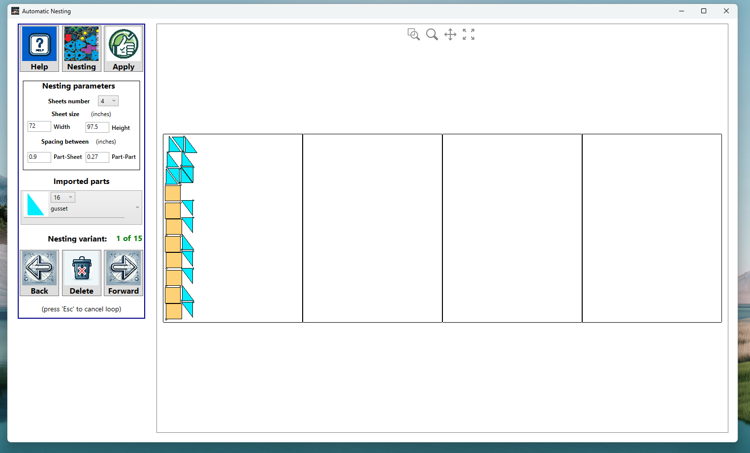

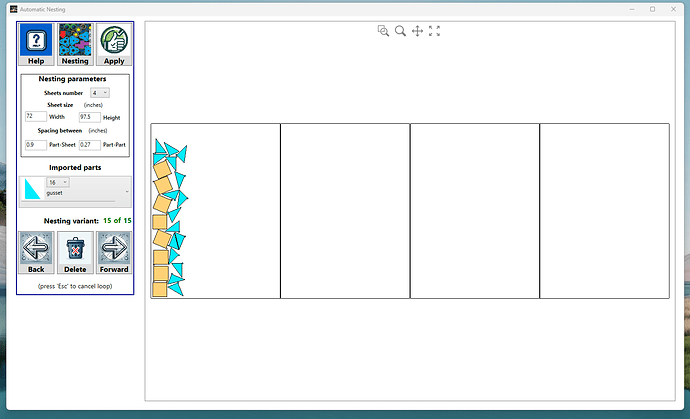

An observation, I tried a nest of 8 squares and 16 6 x 8 gussets, after 50 nests I gave up. It never did nest parts like I thought it should. Is there any way to specify angle and distance tolerance?
Steve
upload your job files please, before and after autonesting, I’ll have a look.
re. specify angle… no.
re. distance tolerance… other than part to part distance, be more specific please.

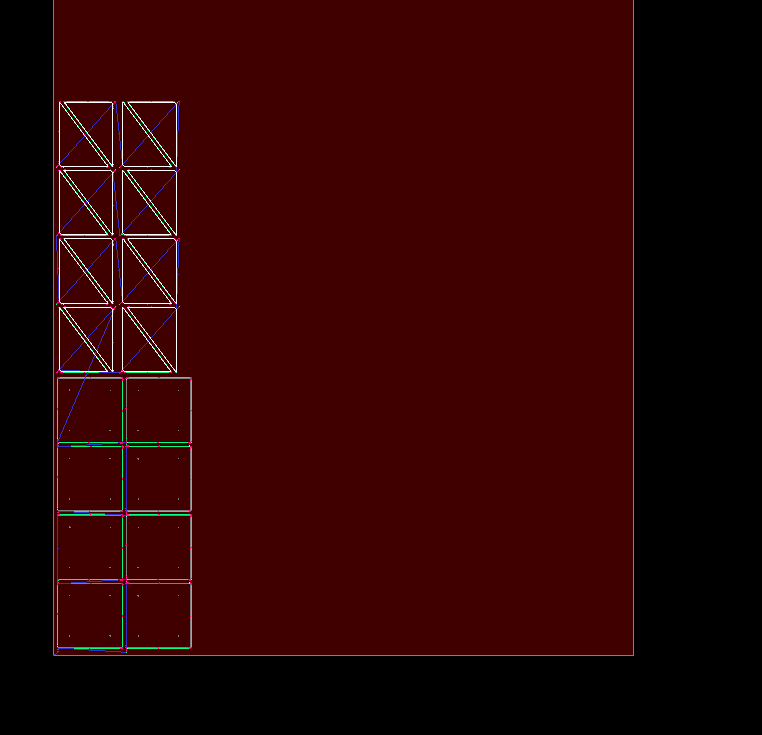

The first picture is the manual nest followed by the auto nesting attempts, it seems like it should be able to duplicate the manual nest or close to it. Thoughts? Edit to add, the auto nested parts do have a short lead-in and the manual in this example don’t. I did run it with no lead-in’s with about the same results.
Thanks, Steve
That looks like a mess. Definitely room for improvement.

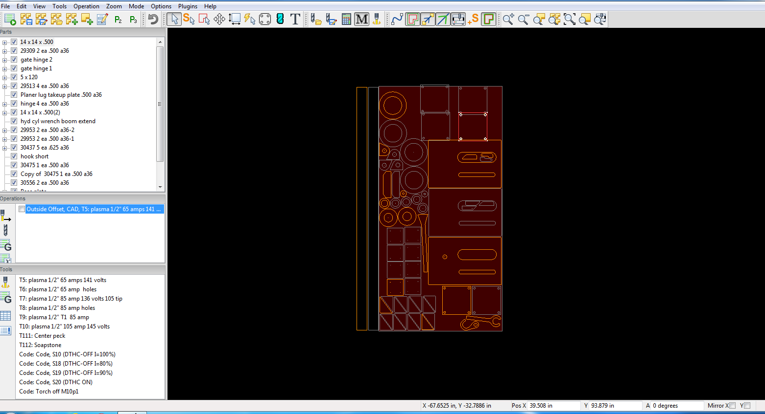

So in an ideal world I would like to be able to add parts to this sheet, as you can see there is room to add more of the little parts but I may not add parts for a long time. This job (plate) was started 3/12/2024. This is a typical plate I have in inventory. If I could quickly have sheetcam tell me weather a new part would fit that would be ideal!
Thanks, Steve
That seems like an extreme condition of the use case. Noted.
agreed, ‘close to it’. The autonesting algorithm needs refinement for sure, especially for cases like this with simple geometric parts. On the other hand, for such simple geometric parts, sheetcam’s Mode / Nesting / ‘Array parts’ would be a better choice for the time being.
