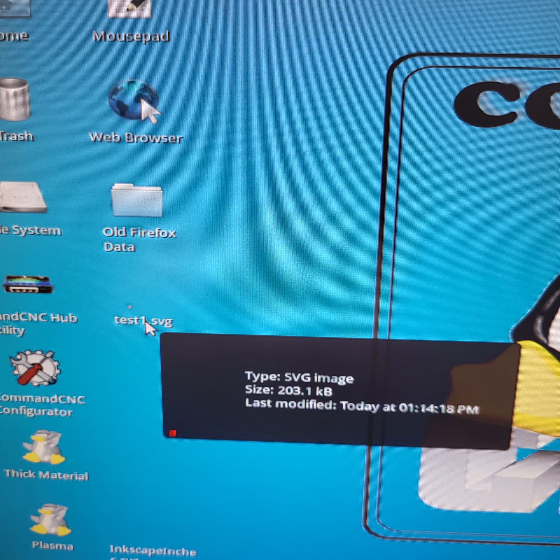

I will try that. I will create a new Test.svg on inkscape on my table PC and go from there. I will provide screen shots. Hope to get to it shortly.

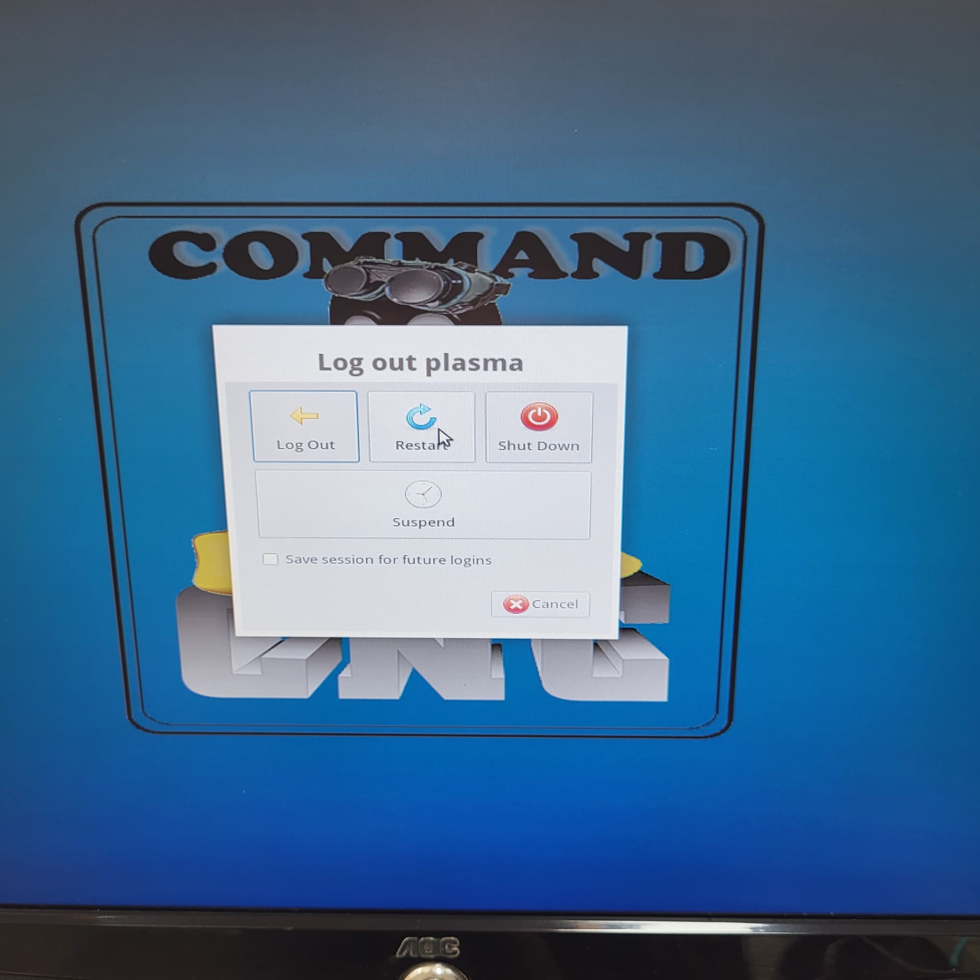

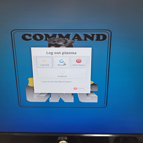

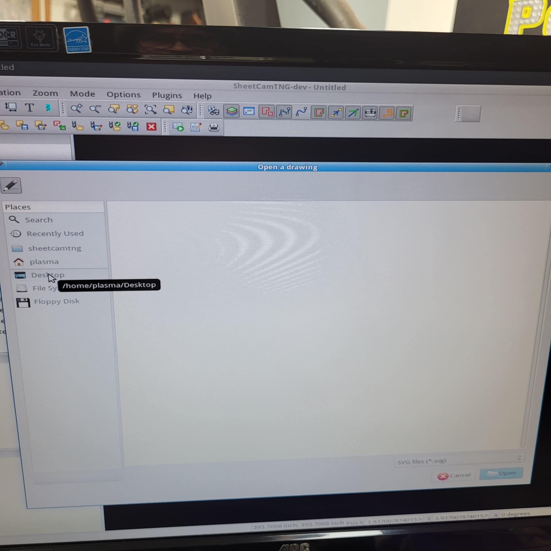

Ok. I saved it to my desktop (test1.svg) that I created on this table pc. Then it did the same thing. Nothing clickable in Places dialoge box (second image). Rebooted 2 times then it came up as you can see in the next post…

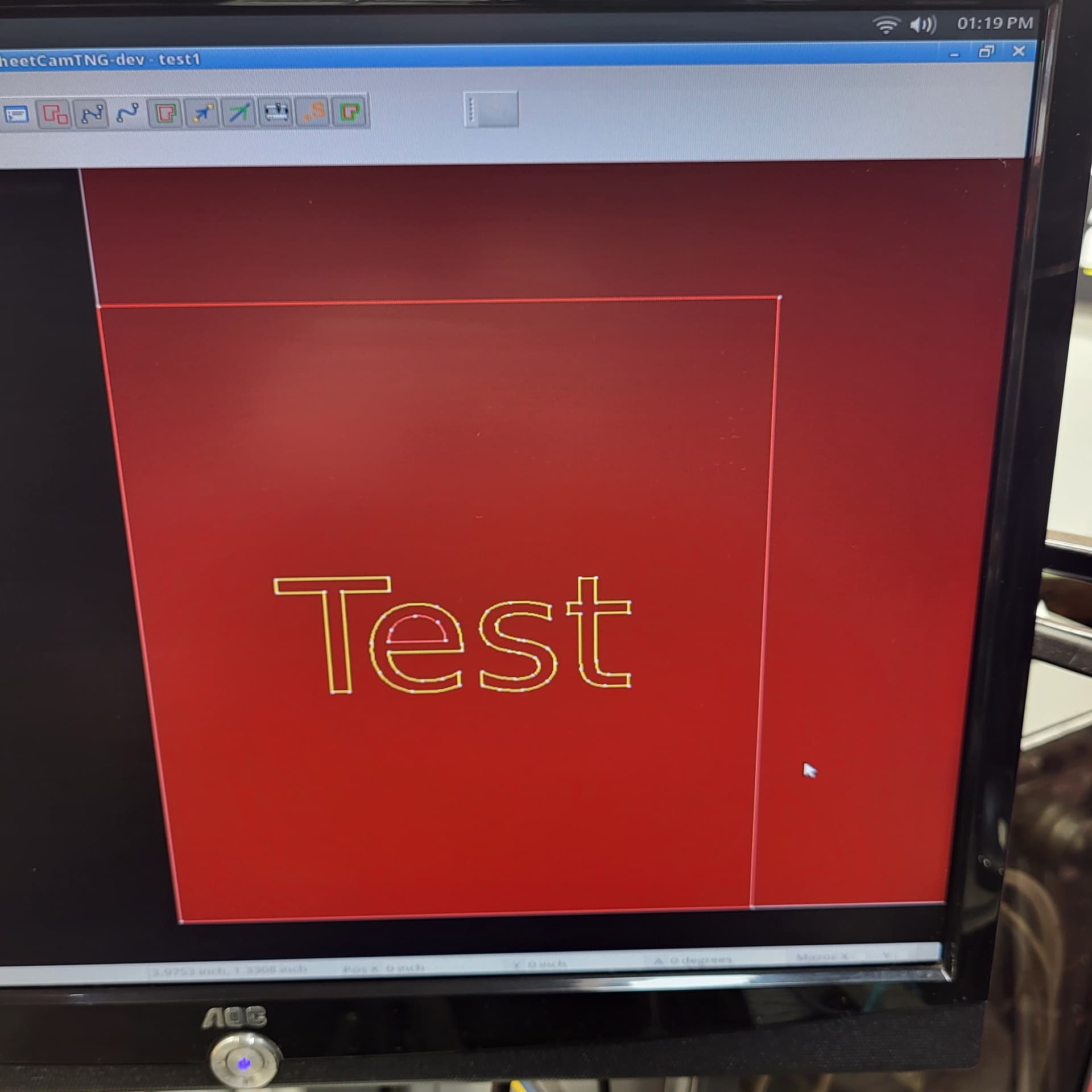

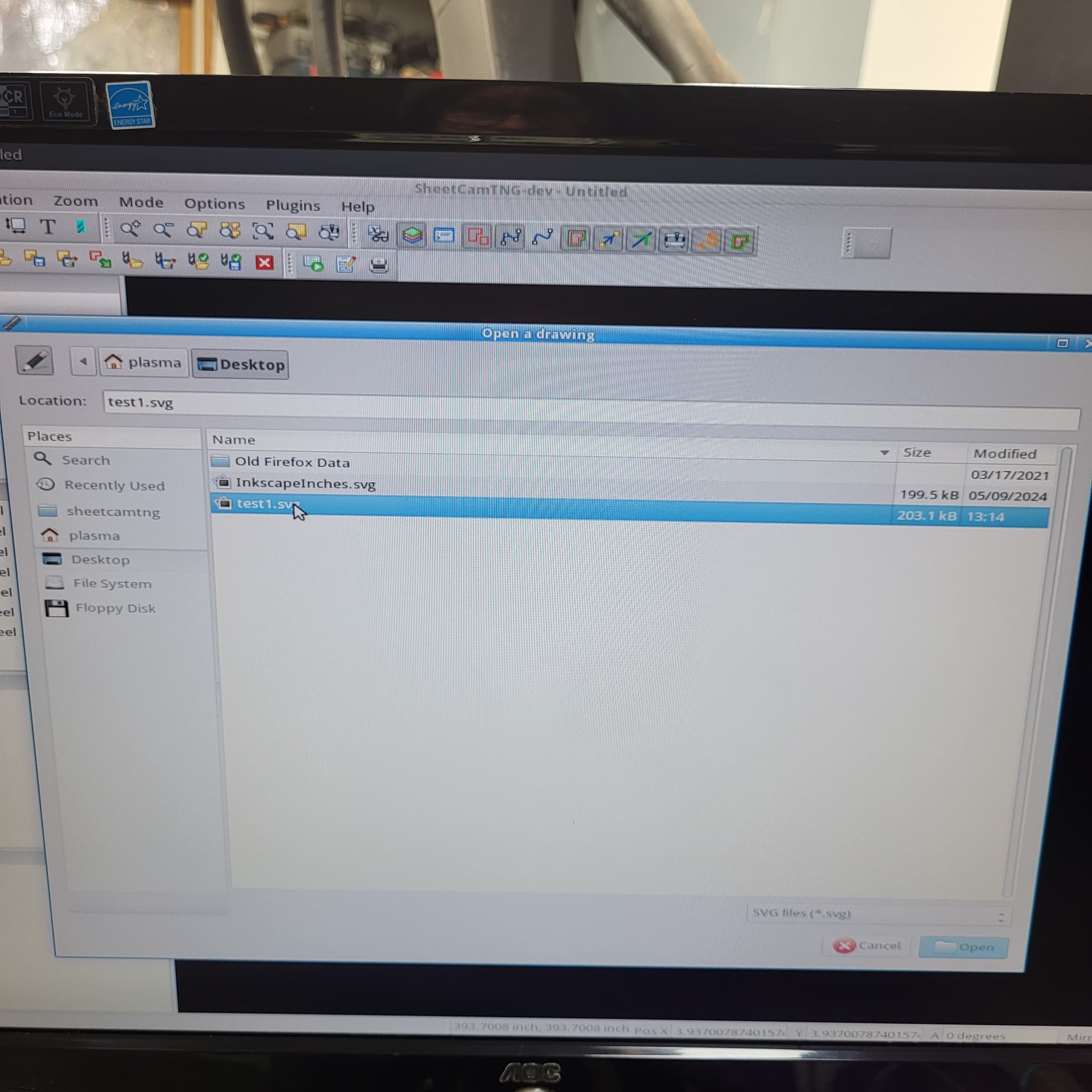

I then rebooted twice and then I was able to point to the desktop and get the file.
That looks like an issue with your Linux installation rather than SheetCam. Do you use network shares? If so, try disabling the network shares. If you use an external hard drive/thumb drive try removing it and see if it makes any difference.
Do you have any trouble opening files with other applications?
