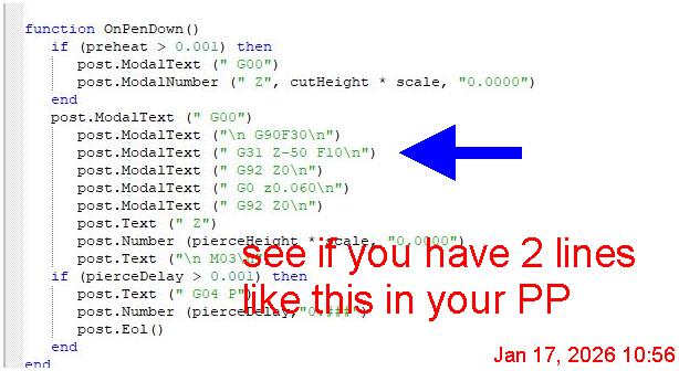

anyone help me get the order here corect?
Z3.7000 <this should be coming After the probe and just before the torch fires
G31 Z-100 F500
G92 Z0
M03
heres the part of the post that im guessing is the issue?
function OnPenDown()
– Probe on first pierce or if distance exceeded
if firstPierce or dist >= refdistance then
post.Text(" G31 Z-100 F", probeFeed, “\n”)
– post.Text(" G92 Z", switchoffset, “\n”)
post.Text(" G92 Z0\n")
dist = 0
firstPierce = false
post.ModalText (" G00")
post.ModalNumber (" Z", pierceHeight * scale, “0.0000”)
post.Text (“\n M03\n”)
if (pierceDelay > 0) then
post.Text (" G04 P")
post.Number (pierceDelay,“0.###”)
post.Eol()
what do i have wrong thats messing up the order? Or shoud my probing routine be somewhere else?
OnPenDown() is the correct function to do this. What you’re seeing in gcode is that sheetcam core positions Z to pierceHeight just before invoking OnPenDown(), which is correct. your pp must return Z to pierceHeight after the probe sequence while in OnPenDown().

There should only be one G31 per cut operation.
