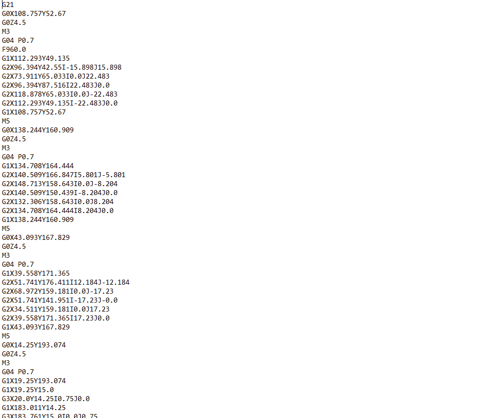

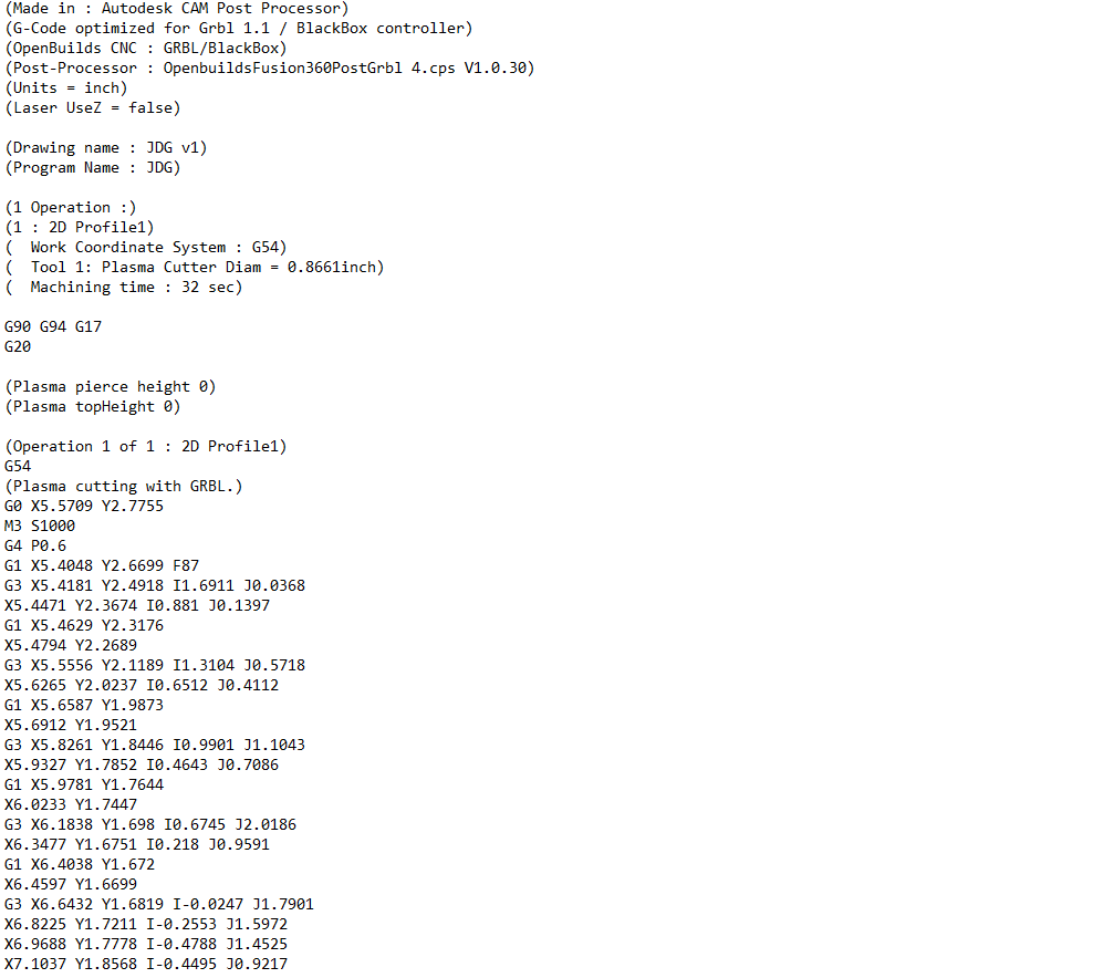

Hi - I’m having issues with my torch relay not firing up off a file I have drawn in DraftSight. When I use the manufactures file and load it into OpenBuilds, the relay works perfectly. I’m also using the GRBL plasma no Z for my post processor. When comparing the .GCODE files in notepad, it looks like I’m missing some text explaining what the machine will do? Although, that may not be too important. (See image attached between files, also they are not the same shape so the code will be different).
My machine is a JD Garage DIY kit, I’ll be using a Hypertherm Powermax 65. I’m using the free version of Sheetcam too.
This should fix it.
