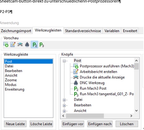

Hallo,
I have had a good external person to setup 2 toobar buttons for diffrent post P2 P3 prozessor setups.
Actual I have so troubles with the PC and want to migrate to a new pc with sheetcam but I can´t not setup tghe buttons like the external person did.
What have I to do ?
Roland
You need to set up the moreposts plugin.
Just to add to djreiswig’s suggestion you can find the plugin in Options->plugin options->moreposts.
