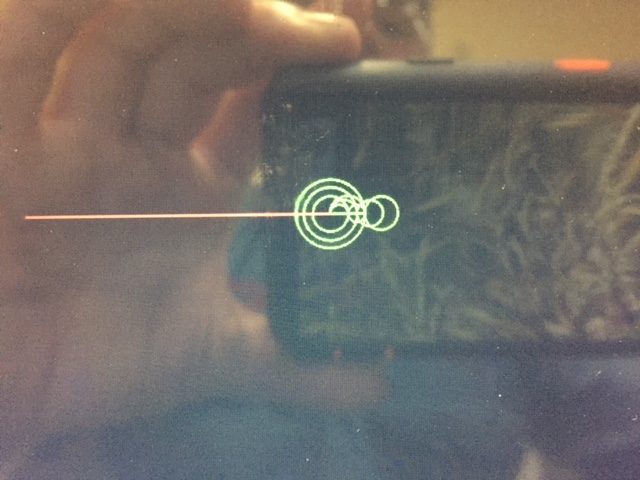

The modified post has the tool doing a x,y rapid move in the hole, hitting the side of the hole with the tool(you can see it in the simulator), then comping on during the first arc, arcing again (which I have never seen), then spiraling up for the cut.

I updated SC and ran the same job with the update, and it did remove the rapid move at the beginning, but the first arc is being generated in the wrong direction (“I” should have a negative sign).
Even after manually adding the minus sign, the code still is not properly arcing into the cut.
The first X move should not be directly into the cut, then arc.
The first XY move will be small enough to not engage any material, but its only used to engage cutter compensation. The first arc (referenced from where the first linear move stops) should be where it leads into the cut with the appropriate Z move after that first linear move, then do one complete cut, then arc out while canceling cutter comp.
Then repeat same way for each cut until thread diameter is reached.
Right now it feeds into the cut in a linear move while comping on, then does one full revolution at half the cut radius(should not do this at this coordinate) , then does the full cut radius move.
It does not show on SC’s built in simulator for some reason, but Camotics and NC corrector show the incorrect moves.
My machine is down today, so cant verify, but the simulators have never been wrong and I know the code is wrong.
The first “I” value should have a negative sign before it like the others. It is arcing in the wrong direction, progressively getting larger as each cut is made.

Everything looks good on my simulators and the code looks like it may work.
The only thing that seems odd is it does not arc in to the cut. The SC simulator shows it arcing in, but its not in the code.
It arcs out of the cut perfectly fine.
