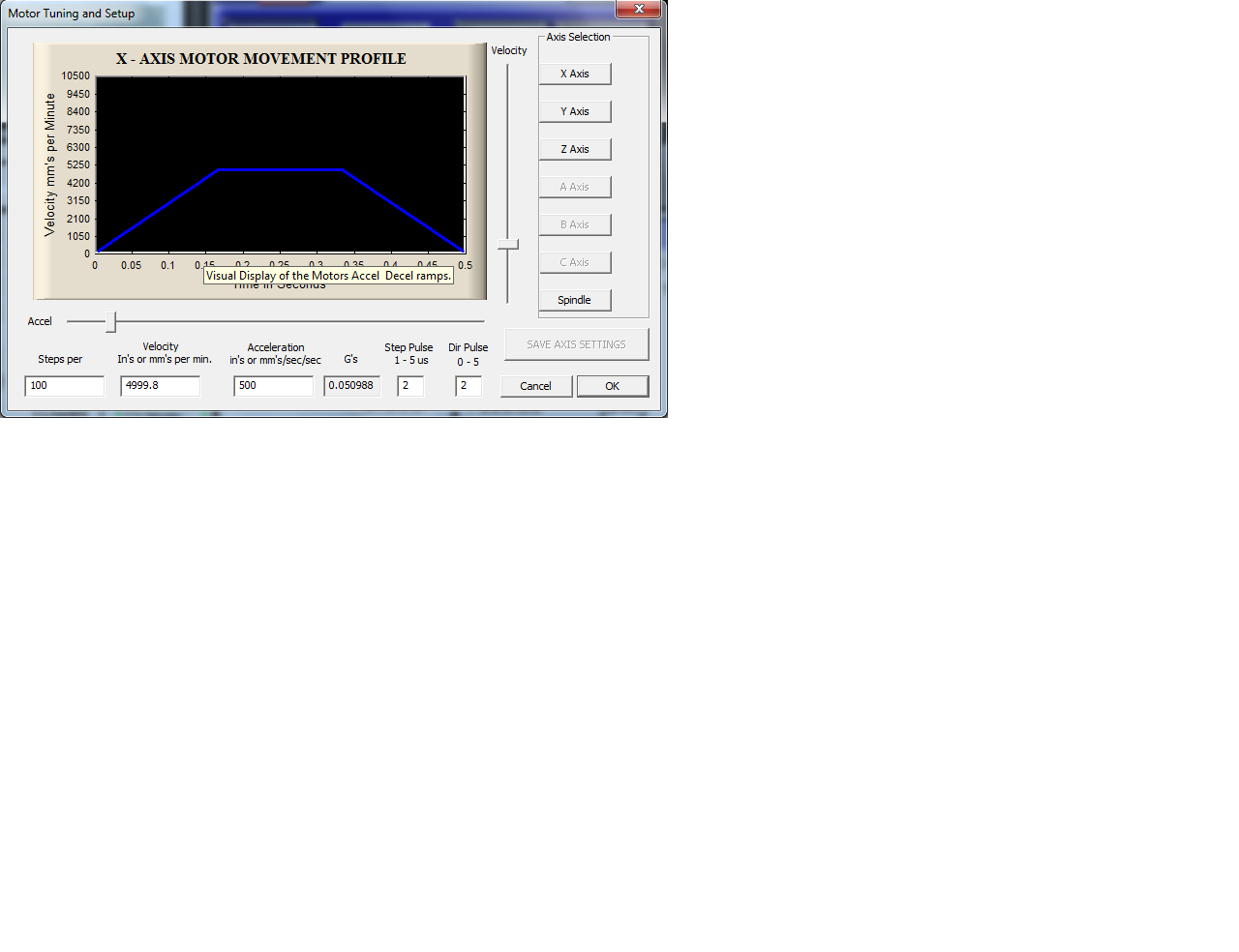

And the issue of acceleration is solvable. Take the following as an example:
In SheetCam, the speed in the operation is set to 1000 mm / min and the acceleration is 500 mm / s2 - respectively in the CNC controller the set acceleration must be the same.
This automatically means that 1000mm / min will be reached in less than 0.05sec. or about 2.3mm. It follows that even if the machine stops at each part of the contour, 2.3 mm will be needed at the beginning and as much at the end. Then these 2.3mm can be placed on any part of the contour and if the remainder is up to 33% - then the whole part will be marked as THC Off.
Is that so?
Ignore the GRBL stuff. That was an answer to a question in another thread and I posted it here by mistake. :blush:
That can only be guaranteed at the start or end of motion. Here’s an example: On a 90 degree corner Mach3 will come to a complete stop on the corner, change direction and accelerate away. Your acceleration calculation will probably work in this case. In LinuxCNC if you have CV enabled, it will round the same corner slightly and not come to a complete stop. The post processor has no way of knowing exactly how the controller handles these situations. Now take a 45 degree corner. Both Mach and LinuxCNC will round the corner but by different amounts. Without actually measuring the output pulses there is pretty much no way of knowing what acceleration they are using in this situation. About all you can say is that it’s probably less than the configured acceleration.
There is no easy solution to this problem. If there was I would have implemented it. That is why I created rules. They aren’t perfect but they are the best solution I can think of.
