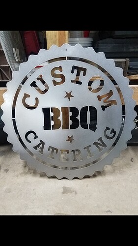

I’m having issues with lettering not cutting right. It seems to be blocky and not smooth. This is a cnc plasma running and everlast 82i power unit. The feed rate seems to be good as I have little dross. Not sure if it’s a post processor issue or settings in mach 3. I’ve attached the dxf of the last cut file and a picture of it cut out. If you zoom in you can see the blocky curves on the lettering.

Cut out. If you zoom in you can see the blocky lines.
Do the outlines look smooth in SheetCam?
In Mach3 go to Config->general config and make sure ‘motion mode’ is set to ‘constant velocity’. Does that help?
I think I’ve figured it out Les I believe it’s in my post processor. It’s all smooth in sheetcam
