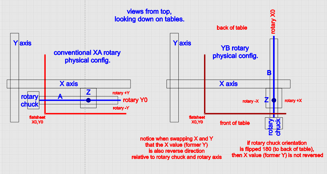

I don’t see a Mach3 swapped XY w rotary pp in the library of installed pps.
You can take a look at the pp in the following thread, and diagram, to get an idea of what’s involved to write the pp code to do it. It’s not much.
