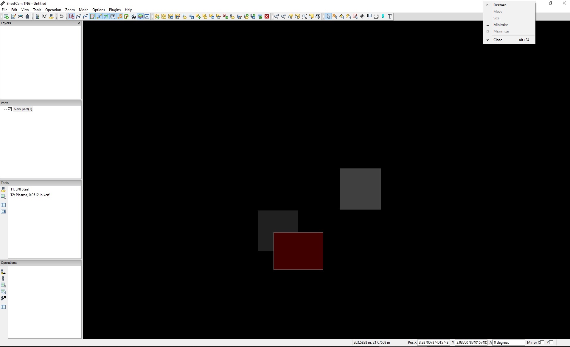

When I open Sheetcam I see 2 additional boxes as well as the red work area (see attached image).
What are these and how do I get rid of them?
Tom
Tom
Tom,
as I recall, there are several “table screens” that are displayed. One is the material size display, 1 is the table size, 1 is the machine size working envelope, or something along those lines. Anyway, go to your sheetcam options menu item, and go thru each Job, Machine, and Application option dialog, and set up any “table screens” that you find to fit your machine.
Steve
