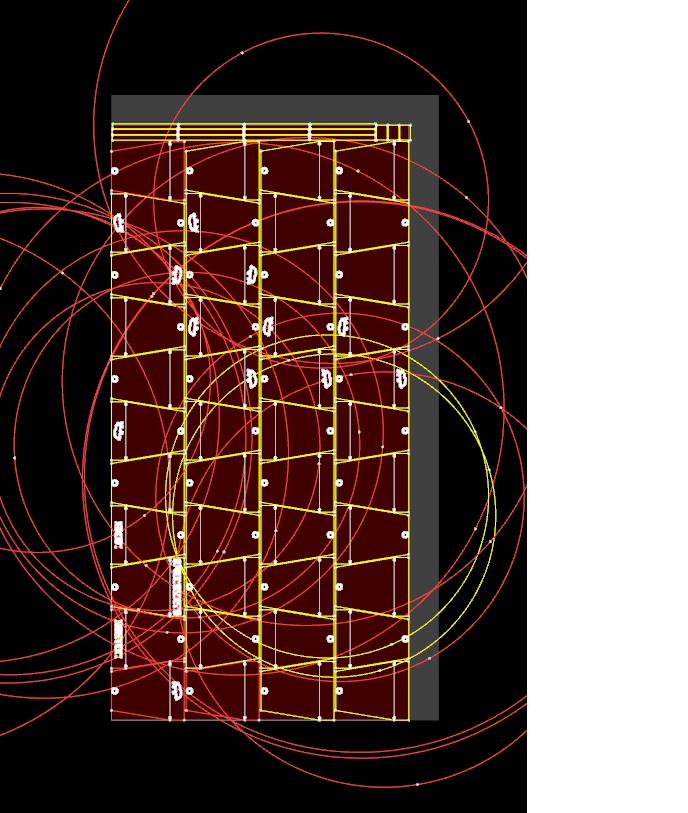

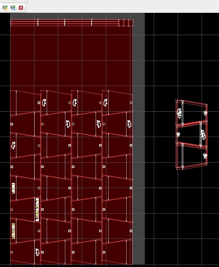

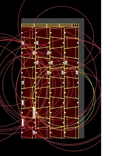

The problem I have is that often the files work fine on my windows PC Sheetcam, but not on my linux machine’s Sheetcam, and vice versa. Please see attached photos.
This is the Inkscape file.
This is how the SVG renders in Sheetcam (linux)
This is how the DXF renders in Sheetcam (windows)
With this particular file, the SVG renders properly in windows and the DXF renders properly in linux, but sometimes files don’t render properly either way and I have to do some hoop jumping with the file to get it render properly.

Are you using the most recent version of SheetCam? If so, could you send me your drawing so I can take a look and see what is going on.
Here are three files that are not working for me.
The DXF renders with the large circles on Sheetcam for Windows version 7.09. The SVGs render with some parts missing and some added in Linux version 6.1.57.

Could you go to Options->application options->Drawing import and let me know what values you have there.
I just uploaded a new release that should fix the circles.

Version 7.0.10 did fix the circles on the Windows machine, Thanks Les.
