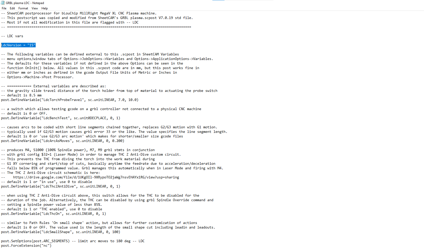

Line 86 - M4 S1000 (THC effective On condition) (fire the torch…)
I dont have torch height control yet. Just z probe. so how do i remove the thc condition?
It appears your grbl controller does not have M7 use enabled (normally mist control output when milling). I use M7 on/off output signal to enable an external THC Z Anti-Dive circuit when XY is cornering. The signal is not necessary in your case, M7 command can be commented out or deleted.
To comment out the command (you may find a need for it later), change the .scpost file as such:
line 15: LdcM7Cmd = “M7 (enable Z THC anti-dive circuit when SPWM < 86%)\n”
change to: LdcM7Cmd = “; M7 (enable Z THC anti-dive circuit when SPWM < 86%)\n”
There is an M9 command later in the code stream which would turn off M7, but if M9 is issued without a prior M7 that is not a problem.
It could be that your controller has M8 use enabled (normally flood control output when milling). If so, in the future, if you need such a digital output control for THC Z Anti-Dive enabling or arming, then you could change M7 to M8.

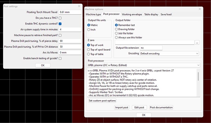

The post works great except I dislike the slow retract after the touch probe does its touch down, what do I need to do to change that. I don’t have a Torch height control, I just want to touch off then go to a height defined in the tools settings, just simple.
@devloop - sure, no problem.
which version of scpost are you using? latest is 26.5 here: https://sheetcam.discoursehosting.net/t/grbl-plasma-w-thc-torch-touchoff-and-rotary/7342/35
So this info is relative to V 26.5
this is the torch probe cycle for Custom post option “Do you have a THC ?” unchecked or NO.
; LDC begin per-cut torch touchoff to adjust Z0
G91  (enter relative distance motion mode)
G38.2 Z-16.810 (probe fast to find sw)
G0 Z3.000 (retract off probe switch)
G04 P0.400 (wait for sw debounce)
G38.2 Z-3.000 F100 (probe slow for accuracy)
G90  (return to absolute distance motion mode)
G92 Z-8.610 (adjust Z0 relative to current Z0 - probeDepth)
G0 Z3.200 X77.884 Y17.543 (goto PH & restore XYA precision)
M3 S1000 (fire the torch w constant S-PWM)
G04 P0.51 (Plunge travel time: 0.09s, Total PD: 0.6s)
G1 Z1.700 F1000
Sounds like you don’t want this line of gcode ?
If so, there are 3 lines in the scpost that produce that one line of gcode, so perhaps the easiest thing to do is just make it a gcode comment line
like this:
after line# 682 : post.Text(“G04 P0.400 (wait for sw debounce)\n”)
insert the line: post.Text("; ") – comment out the following gcode stmt, don’t need 2 probe cycles
and before line: post.NonModalNumber(LdcProbeCmd, -PBR * scale, format)
The first torch probe cycle at 1000mm/m speed overruns the probe switch actuation on the floating torch mount by about 0.225mm on my machine. That’s OK as long as you account for that overrun distance (on your machine) in the “Floating Torch Mount Travel” distance in the scpost Custom Options dialogue. You have to add it to the actual floating mount travel distance to actuate the probe switch, the sum of those distances is the value for this field. The screen shot is showing 8.61mm in this field now (my machine).
The switch actuator overrun at 100mm/m in the second probe is negligible, that’s why its in there. I decreased that retract distance and sped up the second probe from 50 to 100mm/m a few versions back, so you may have the version with the old style 5mm retract and 50mm/m probe speed.
@devloop- I made a mistake in my previous instruction, you’re going to want to remove or comment out more gcode than what I first advised.
These are the gcode stmt lines you want to remove or comment out:
You can use the same technique to comment out the gcode stmt as I previously described.
You won’t need to replace the delay for sw debounce, the pierce delay will cover that.
Thank you, ended up having to delete all the lines you mentioned including the lines between them. I’m actually running the first post you made, its simple and works, I just changed M7 to M8.
