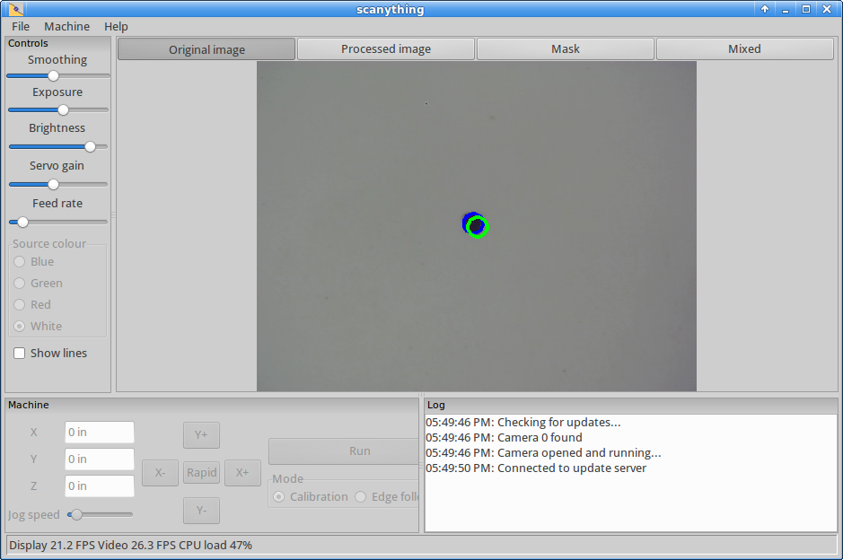

App opens and checks server/camera then nothing.
Can’t calibrate, homed multiple times in CommandCNC, loaded a file into CommandCNC,
Scananything will not load up controls/initiate, lower UI stays grayed out.
Image is good, log tracks when I plug/unplug camera.
Again, no Scananything ‘Machine’ section activating.
I have tried both Remote /simulation modes.
My remote is showing: localhost
Is this my problem?
Image of UI in:

To continue,
Xbuntu Linux
CommandCNC 1.2.2
X/Y homed
  1. re-installed Scanything_setupV2.0.17.17-32; no changes, lower UI inactive - UNUSABLE
  2. rolled back install to Scanything_setupV2.0.12-32; no changes, lower UI inactive - UNUSABLE
  3. Update detected for Scanything_setupV2.0.13-32; fails to run update successfully, throws 404 when file location is added directly to browser
  4. re-installed Scanything_setupV2.0.17.17-32; no changes, lower UI inactive - UNUSABLE
Neither Remote/Simulator modes will run
My remote client is: localhost
Same camera, same cables, same everything.
I had Scanything running a couple months ago, and haven’t made any changes to the computer, added any software, nada.
I am a paid-in-full subscriber to both Sheetcam/Sheetcam Rotary, and Scanything.
All Sheetcam software is direct from the source.
Sorry, I missed this thread. Scanything will always ask if you want to update. I can’t push out changes without it asking if you want to install the update.
It looks like you don’t have the LinuxCNC plugin enabled in Options->machine. Could you show me a screen shot with that menu selected.
