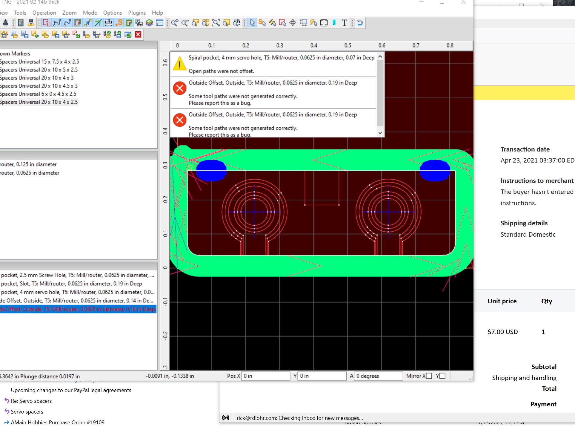

Says report bug and cutter wobbles at end of part
It cuts the part then gets stuck in a wobble loop about 400 times afterward in the top left corner.
Luckily the part is cut correctly so its an annoyance for now, but its going to wear out my motors.

Whenever I get the message about the paths not being generated correctly, it’s normally a bad file I imported.
Things like crossed lines, loops in the line, or even tiny separate lines/shapes. Most of the time they are extremely small and you have to really zoom in to find them, but they are there.
Maybe post your job file and the dxf or whatever you imported.

Could you send me a job file (file->save job) with the tool paths set up ready to post process. This is a bug and having teh job file will make it a lot easier for me to figure out what is going on and fix it.
SheetCam can struggle when you use ramping and you have tabs near the start point. Try moving the start point or the tab nearest the start point.
Thanks all. Job file sent.
As I suspected the issue is the tab nearest the lead out. There isn’t enough room for the ramp. If you move it a bit to the left the fault will go away. This is a bug in SheetCam but it involves a fairly significant change to the path generator to fix it. The path generator is a complex beast so any changes will stay in dev for a while so it can get thoroughly tested before moving to stable.

This is fixed in the latest dev release. I’ll put out a new stable in the next couple of days.
