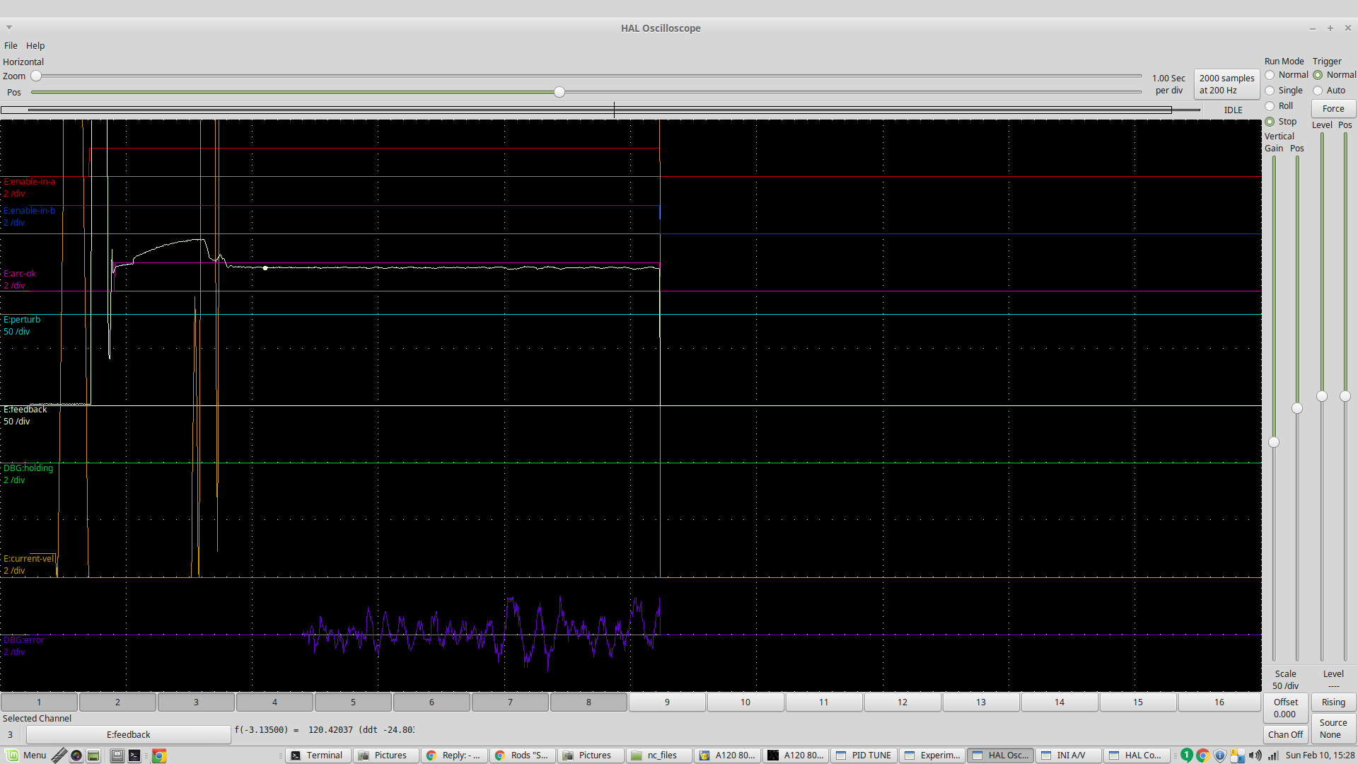

After extensive data collection using Linuxcnc’s software oscilloscope (halscope), I have found that a THC on delay of about 1.5 seconds after arcOK seems about right for the initial establishing spike in voltage to subside. This is 8mm mild steel at 80 amps. E:feedback is arc voltage and E:arc-ok is the arcOK signal and we sample the arc voltage when the THC is enabled. If the current velocity is not near commanded velocity, we wait until it is before enabling THC and sampling.
You can see the THC is enabled at the point where the blue error line starts to be plotted (1.5 seconds after arcOK goes true). This period could be shortened a bit in this instance but 16mm thick material is a bit slower settling.
Lets look at your simple square. The leadin will mostly occur within the ArcOK delay and there will be a ramp up from 0 to your cut speed based on the trajectory planner logic. After 1.5 seconds, the THC is enabled and the arc voltage is sampled. Torch height is now under THC control. As the cut approaches the corner, the trajectory planner will reduce velocity in preparation for the change of direction. Once the velocity falls below the threshold (say 90% of commanded velocity after allowing for feed overrides), the THC will be disabled. The corner is negotiated and the trajectory planner accelerates back to commanded velocity. Once it gets over our 90% threshold, THC will be enabled again. As the cut is completed the TP will slow the cut speed and the THC will be disabled at the end of the cut
Looking to the inside cut rectangles, the same rules would apply. THC would most likely be enabled becasue some of your long side cuts would be at speed. There is no reason to slow them down.
Circles are mostly self managed by the same logic becasue the trajectory planner is unable to get to cut speed so the THC is never enabled. You can augment this with Sheetcam’s automated cut rules and tie the cut velocity to a percentage of circle diameter based on different sizes. This is quite useful and would solve your problems on the bottom right. Maybe the large hole is cut at 80% of cut speed and the smaller ones cut at 60% with those rules.
The problem I had was with arcs on chain cut holes in 16mm plate. Lets look at the example on the top right again as the corner arcs are similar to what I had. You have 3 arcs on the outside corners, transition in, circular cut and transition out. I would be quite happy with the cornerlock managing the transitions. But I found I could not set up a rule in sheetcam that ignored small arcs and modified the circular cut. This is what led me to explore the possibilities of calculating the arc radius in real time (eg 1000 times a second). This would allow me to build much more sophisticated rules to modify cut speed and THC enabling than sheetcam provides. Time will tell if I can achieve this.
