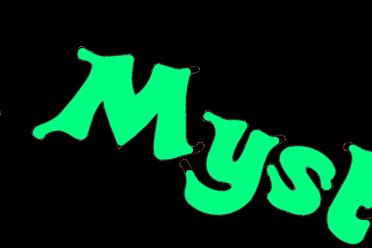

Sometimes you have a large pocket and you want some sharp edges or it has some spiky contours.
So you would like to mill 99% of the pocket with a big mill and only the parts that mill isn’t able to mill with a smaller one.
Like this example.
Something like rest material removal.

What I usually do in this case is to rough out the pocket as you have shown, then do a contour pass with the smaller end mill, maybe two passes with a larger offset on the first if you have more in the corners than a single pass will get. Not exactly rest machining, but it usually works out pretty well.
Yes, rest milling is a hard nut to crack. It’s one of those functions I look at occasionally when I’m feeling particularly masochistic. So far I haven’t come up with anything that works reliably.
Yes that is sometimes a workaround, but on parts with a large contour line and a little area it makes sometimes no difference to mill all with the small mill.
On simple parts like rectangles where a want to have sharp edges I add a layer which only handles the edges.
