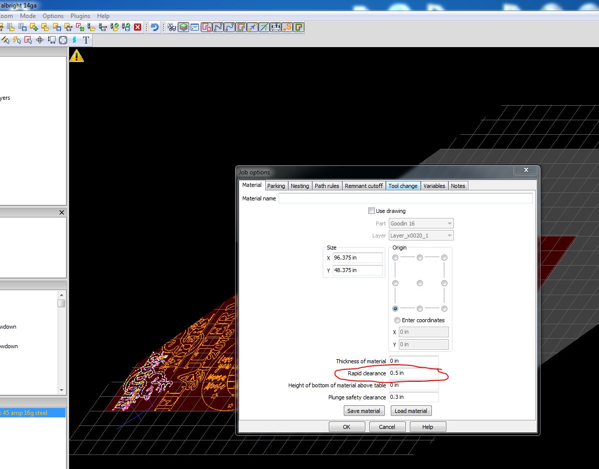

Options → Job options → Rapid Clearance, at the bottom of the screen…what’s the setting? This determines how high the Z lifts during a rapid movement.
