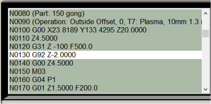

Hi, I have been running this post processor with much issue of late however I have noticed something that I’m not sure if it’s a Sheetcam setting or Mach3 issues.
When the machine initiates a cut it will lower from the 20mm rapid height to the 3.5 of 4 mm programmed pierce height, initiate the arc, lower to 1.5mm then to 0mm till touching the material then the THC seam to take over. If I set the minimum Torch height on Mach3 that will limit the torch height touching after piercing. I have tried setting the THC to well above the desired height however it will still go to 0mm.
This will do the same after it has “touched off as well”
Any suggestions
If you are still using the pp attached here, then based on the gcode snip you just posted, ‘switchOffset’ var in the pp is set to 2.0mm, make sure that is correct and matches your floating torch mount distance, including the switch actuator overrun which occurs during the probe operation. If that distance is too short, it can cause the symptom you describe.
Second- the pp has code to skip torch touchoff prior to pierce when the current position is within proximity of the previous touchoff. ‘refDistance’ var in the pp sets the proximity distance. Use 0 if you want a torch touchoff on every pierce and while debugging an issue like you describe. If this distance is too large, it can cause the symptom you describe.
hold on- I see something else in your gcode snip- after the pierce and delay, you are lowering the torch to cut height at a speed of 200mm/m, that’s too slow. Your THC has a time delay setting in it (DLY) and its too short of a delay for that Z speed. It’s taking 0.5 secs for Z to move from PH to CH, after the 1.0 sec pierce delay. So if your THC has less than 1.5 sec DLY value, that’s a problem, its taking over and driving the torch down. Either make the THC DLY value 3.0 or make the plungeRate 2400mm/m, normally you should have plunge be rather quick if using such a long PD.

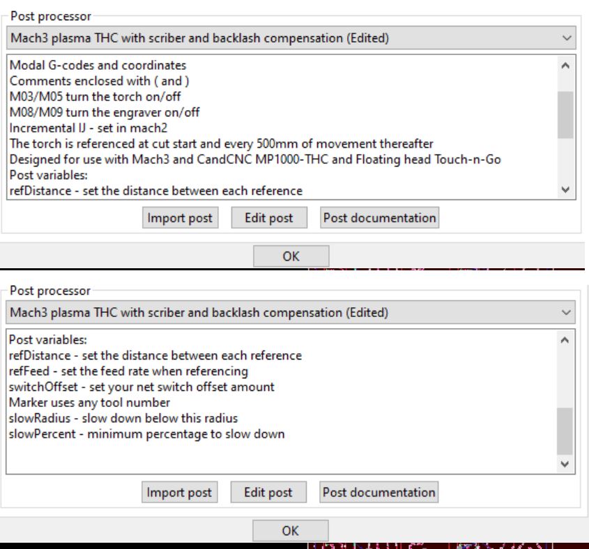

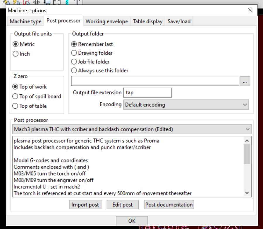

@asuratman1 , you’d have to give the pp a try, hard for me to know if your setup is like the OP. Download the pp to your desktop or download folder, then in sheetcam menu Options-Machine-Post Processor, use Import button at bottom of window to load it.
