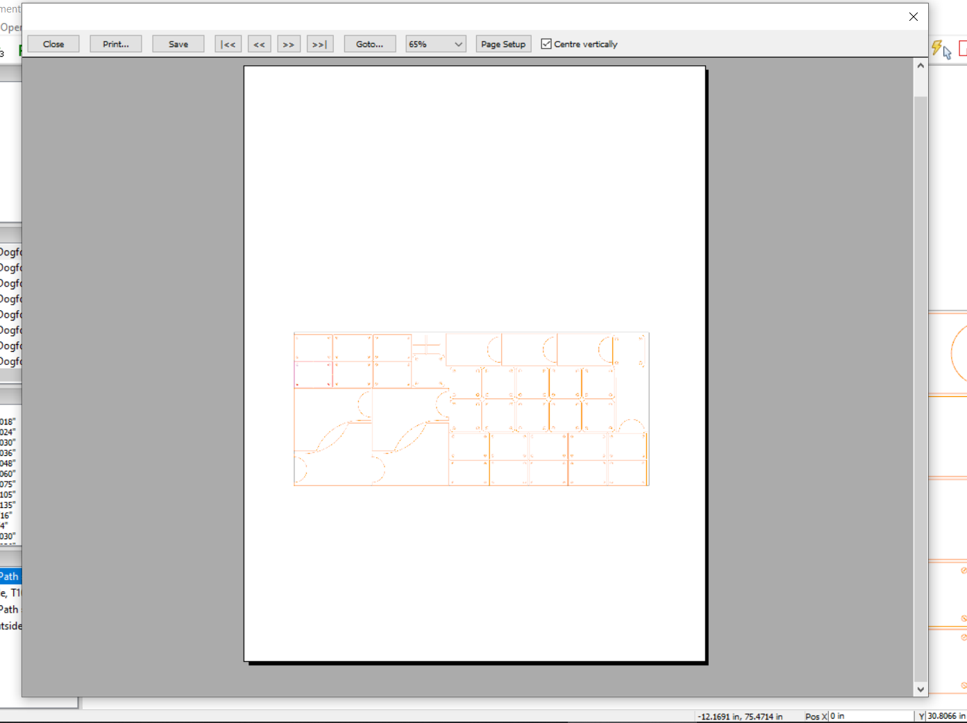

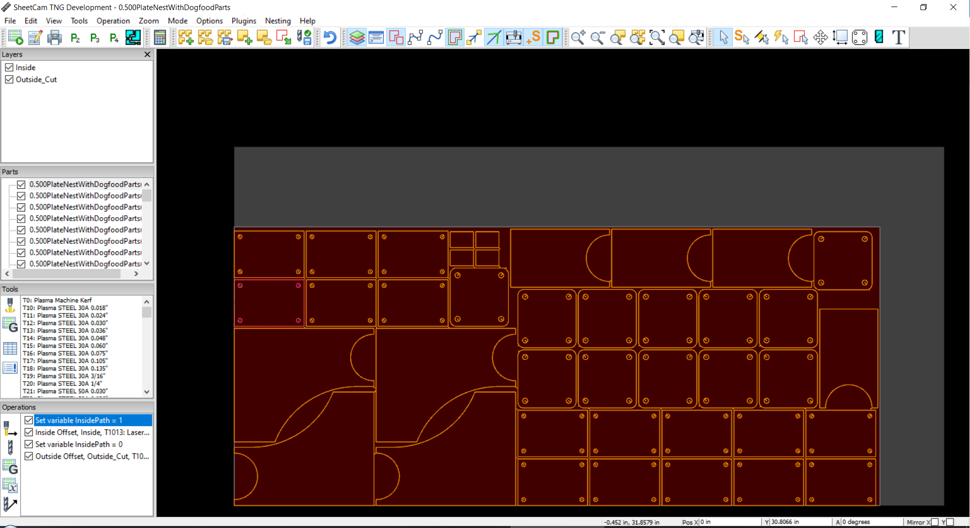

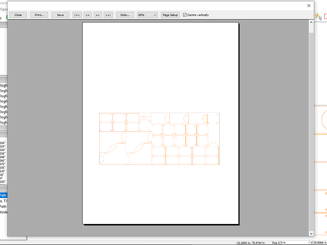

I seem to be having some issues with printing layouts. I really need to print some of my layouts at the bottom of the page. The attached screenshots shows my issue. No matter how i position the parts in the window, it will not print at the bottom of the page. If i move the parts halfway off the bottom of the window, it just gets cut off when printed. If i uncheck center vertically, i can print it starting at the top of the sheet, but that is not where i need it.
Is this a bug or is it just not set up to be printed that way? Could it be?

I’m not sure if I can easily get it to align to the bottom of the page. I’ll take a look at the default printer. I think this is buried somewhere in the GUI toolkit I use.

I’m in the process of upgrading to the latest version of the GUI toolkit I use. That may well fix the print issues. It may be a little while before this upgrade is finished. It involves quite a lot of work.
